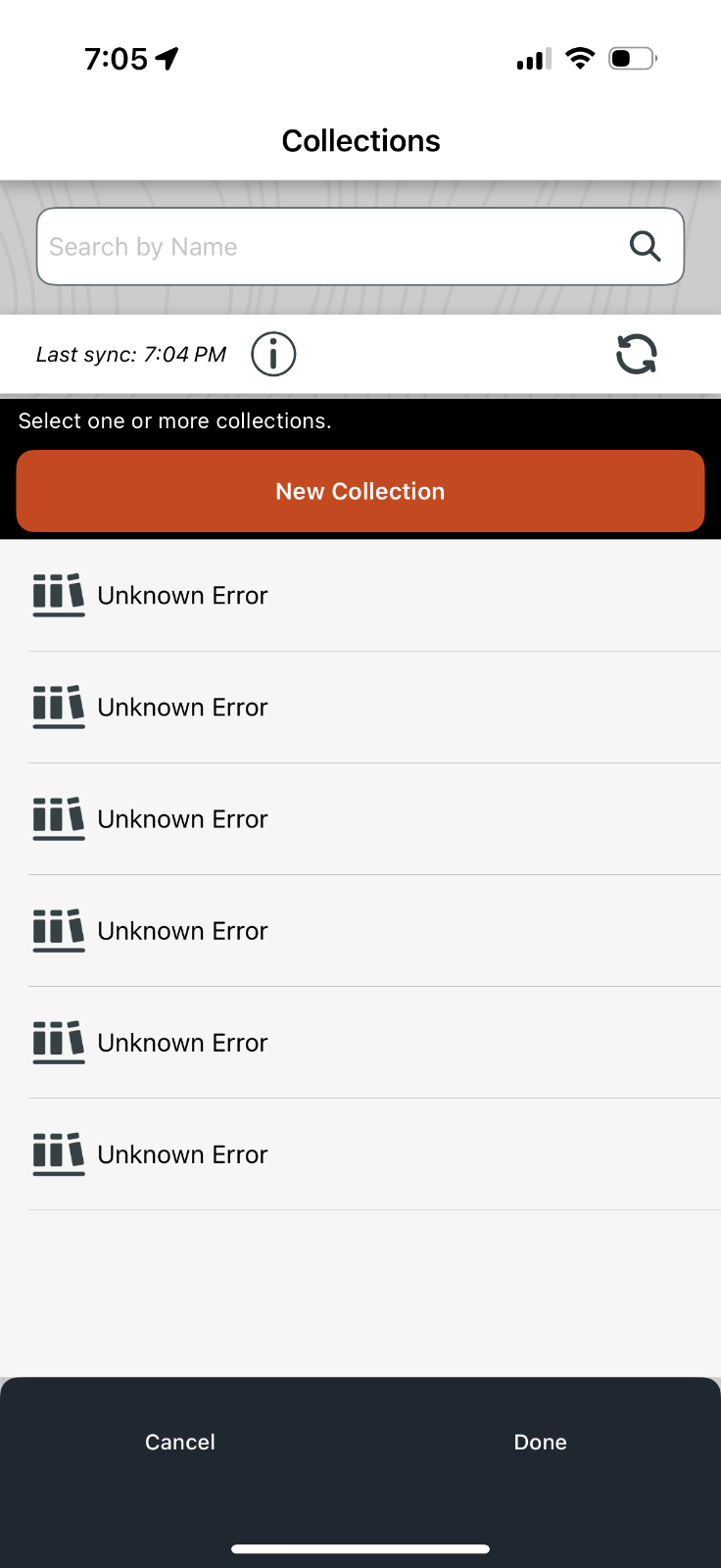

I have a saved route that I just created in the Tread app, but am getting an error when trying to save that route to a specific Collection. Anyone experiencing this and know a fix? I have closed the app and restarted, turned "Collections" off and then back on again, but no luck...

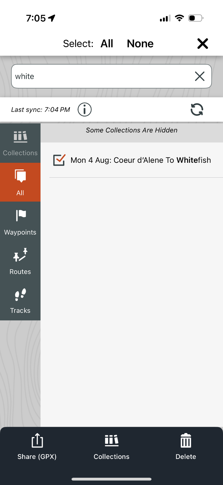

Yes this is about moving a saved route from Unorganised to another named Collection. When I select the route and then press the collections button at the bottom of the app, it displays “Unknown Error” as the names of my saved collections.
- IMG_2032.png (109.76 KiB) Viewed 2027 times
- IMG_2033.png (124.31 KiB) Viewed 2027 times

Will it let you select 'New Collection' and say Done?
Or
If you go to Collections from Favourites, does it show the same Unknown Error. If so, Will it let you delete them ? It seems to think that they are collections.
I'm wondering if it a not-able-to-synch issue. Have you let it synch or forced it to synch ? Both from the app and from the XT2.

Do you have any odd characters in your collection names ie anything other than letters and digits?

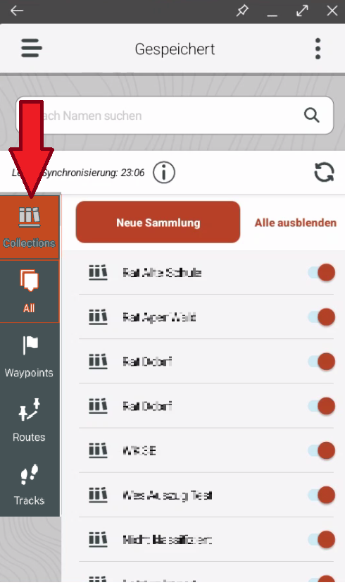

but I still have one question, what does the screen look like when you click on "Collections" in the main menu?

For some reason, the problem has resolved itself for the time being. But this happened previously where I had the issue and then it went away for a little bit. But to answer your question, when I just clicked on the collections button without trying to move any of the routes as previously described, it just displayed as normal. I’m able to go in and view the collections individually, but the issue was with moving the routes.

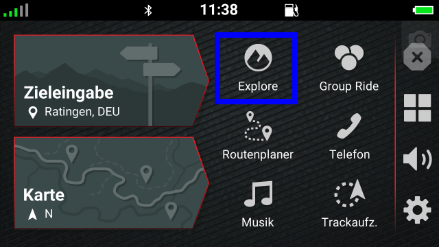

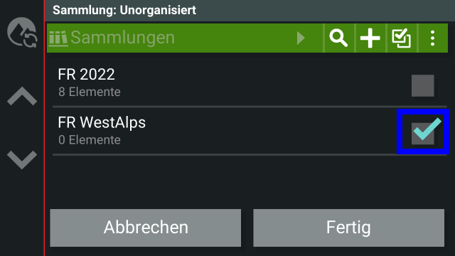

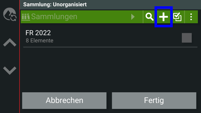

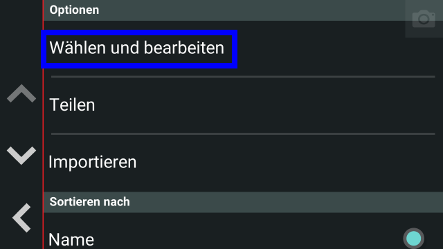

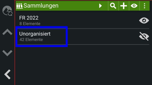

It is relatively simple,
here is a small guide to assign routes to collections without Tread App only in zumo XT2.
Please excuse the mix of English and German.
I have German menus myself but I hope the English menus look similar and you can still follow me
01 Touch Explore

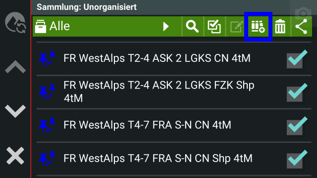

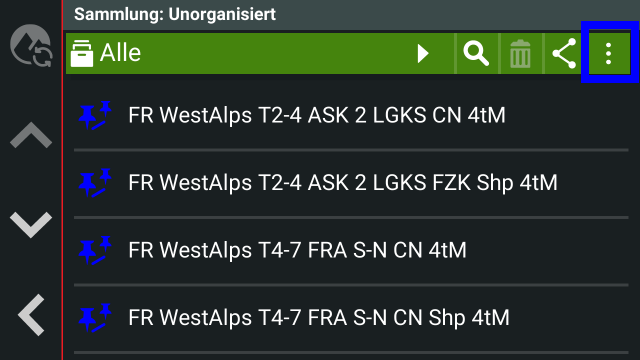

02 Touch Collections unorganized
03 Touch upper Right 3 Dots
04 Touch Select and edit
05 Select your Routes
06 Touch upper Collection Icon

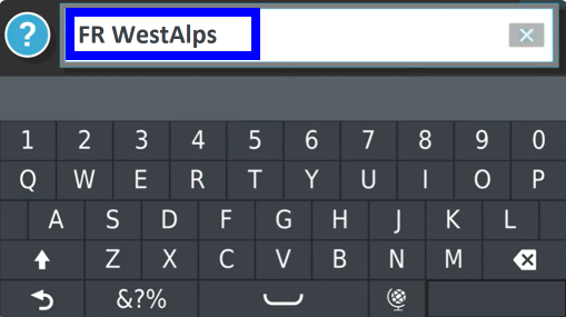

07 Optional Touch upper right + Icon Create new Collection
08 Optional Collection Name

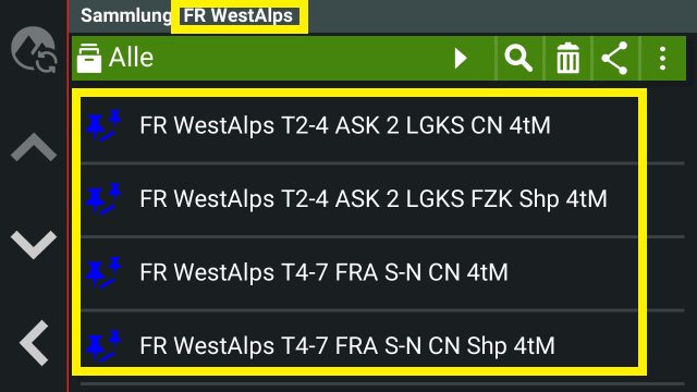

09 Select your Collection
10 Well done, routes now in your Collection
