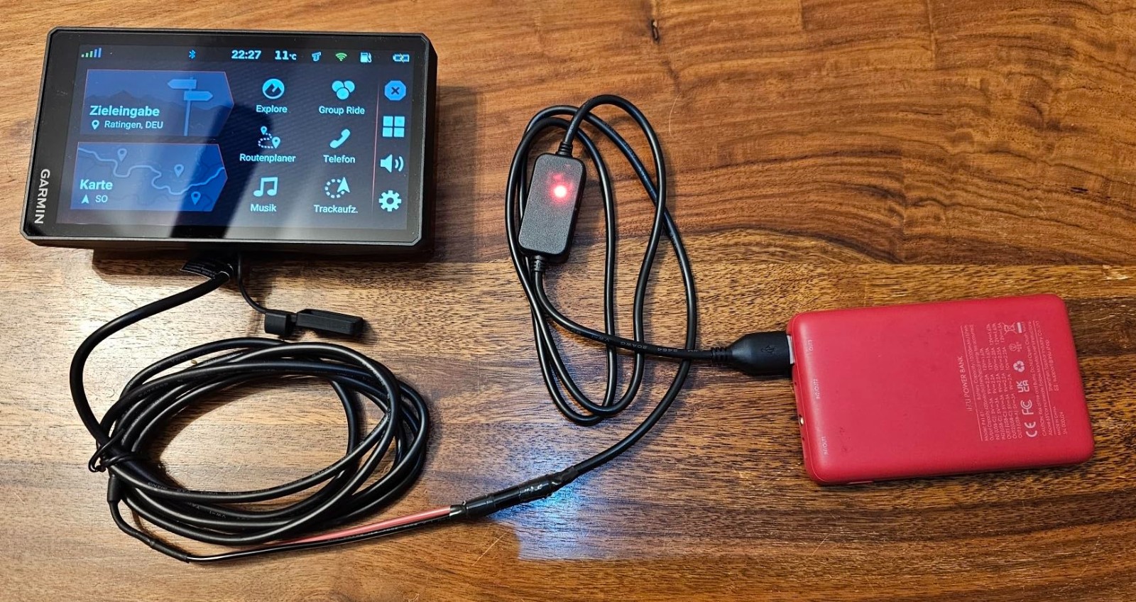

Think about the following 1 alternatives:
Keep using the XT but use the original XT mount with the original 12V power supply.
Maybe you can get the Garmin 12 volt power supply cheaply used if you don't have a 2nd.
Then buy a USB to 12 volt adapter.
Connect the USB to 12 volt adapter to the Garmin 12 volt adapter connection and a standard power bank. I found this on Amazon: https://www.amazon.de/dp/B0DJ5GM725
Advantages:
- There are enough powerful power banks on the market
- Such power banks are “relatively” cheap
- Even if there is a USB plug in the power bank, this plug or the power bank is much easier and cheaper to replace in the event of a defect.
This works quite well for me with the XT2. I use it like this on my second motorcycle, I didn't want to rewire

Re: Should I Switch From A Garmin Zumo XT To A Zumo XT2 On My E-Bicycle?
That is a great idea. I still have the original Garmin Zumo XT mount in my basement.proofresistant wrote: Wed Jul 16, 2025 5:34 pm...Keep using the XT but use the original XT mount with the original 12V power supply.
Connect the USB to 12 volt adapter to the Garmin 12 volt adapter connection and a standard power bank...
Using a USB 5V to 12V boost converter is a great solution.
Thank you!
https://www.amazon.com/SinLoon-converte ... hdGY&psc=1
If you still have a mount it's worth a try.
Let us know here if it works with a Zumo XT (first generation) also.
Keeep in mind,
the adapter mentioned above can probably only supplies 10W, maybe just a little over 9W.
Just over 8 watts seems to be sufficient for my XT2.
Hi @Jim1348 ,
I have thought about my tip again and now have doubts as to whether it was really a good idea for the XT.
It works quite well for the XT2, which I use exactly as I described.
But you are looking for a solution for the zumo XT 1 (first generation)
However, this could be different for the zumo XT 1 (first generation).
1.
It may be that the additional original Garmin 12 volt to XT converter itself requires too much additional power, so that the 9-10 watts of the adapter are not enough.
With such a solution a test is necessary.
2.
Maybe you don't need an adapter solution at all.
My consideration, but only just theorizing:
2 a) It may be, I am not an electronics engineer, that the standard USB A output of a power bank always supplies just 5 volts.
2 b) It is also possible that the pins on the zumo XT holder also require such 5 volts.
2 Conclusion)
If these two assumptions correspond to reality, then no converters would be required at all.
Then it could be enough to take an old USB A cable, cut off the plug, and take an old Garmin zumo XT mount and cut off the cable to the adapter and connect both together.
But these are just my thoughts, ask an electronics engineer or specialist!

The USB ports are not designed for rough use. There is a risk that the sockets will be damaged. This was exactly the problem of @Jim1348, he was looking for an alternative, and with the XT2 the use of the 12V standard zumo mount adapter is a good alternative. For the XT (1), however, this may not be such a good idea.
The battery has the shown 3.4 volts, but this is more or less not important, because the zumo device internally makes what it really needs for the work on volts.jfheath wrote: Fri Jul 18, 2025 6:37 am The unit itself operates at 3.4 volts - according to the battery screen.
The maximum 500mA is completely dependent on what the USB port supplies. The maximum varies depending on the PC connection. Only the old USB A standards are limited to “only” 500mA. Newer ones can deliver more!jfheath wrote: Fri Jul 18, 2025 6:37 am When plugged in to a USB power outlet - the XT2 says that it is not charging and on the battery screen shows a limit of 500mA
I use a USB C cable for the PC zumo XT2 connection. And in my setup the zumo XT2 is also charged during this use
