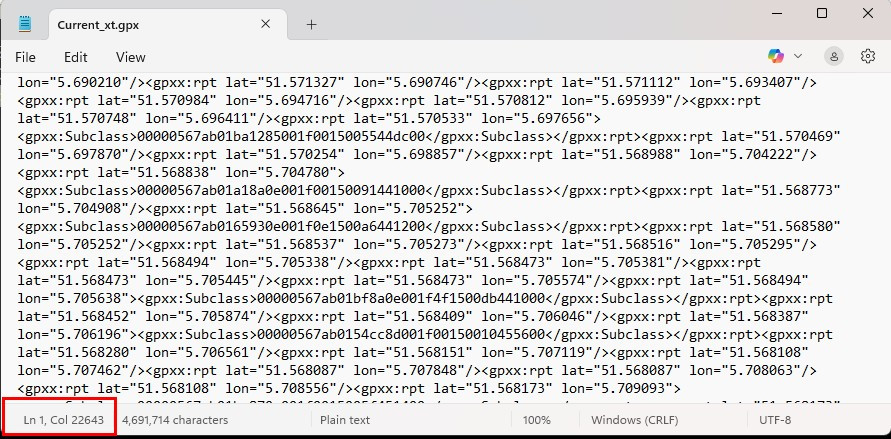

I did however see it a few times with a handheld device that I also have. A Dakota 20. That unit also creates a current.gpx and when it grows large BaseCamp will give me the same error as you had.
There is no way I can prove it, but this is my theory. To explain it better please open a current.gpx in Notepad. You will notice that everything is on 1 line. There are no Newline (0x0a) and/or Carriage Return (0x0d) in the file. you will see something like this.
Notice that it doesn't matter how far you scroll down, the LN remains 1
This is perfectly valid XML. nothing wrong. EXCEPT.....
Programmers are tempted to write programs that read this line by line. And to do that you need to allocate a buffer to hold the complete line. In this case because it's only 1 line, the complete file! And I ASSUME that the programmers that wrote BaseCamp did not allocate a buffer large enough to hold the complete file.
Just how big is the current.gpx on your XT2?
That is my explanation, or better my theory.

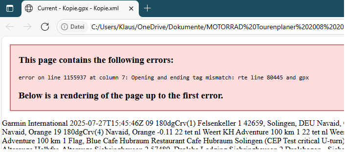

proofresistant wrote: Tue Jul 29, 2025 10:29 pm I'll take another look at the file size; that could be a reason.
OK, it's more likely that the XT2 generates an inconsistent structure :-(
PNG-Bild (neu) (2).png (33.3 KiB) Viewed 427 times
I've already found two or three open tags, but it's not worth the effort to investigate at the moment why or when the XT2 gets out of control here.
As long as I'm the only one with this problem, let's ignore (forget) about it for this moment.
However, if several people observe the same thing, we can invest time in further analysis of the issue.
