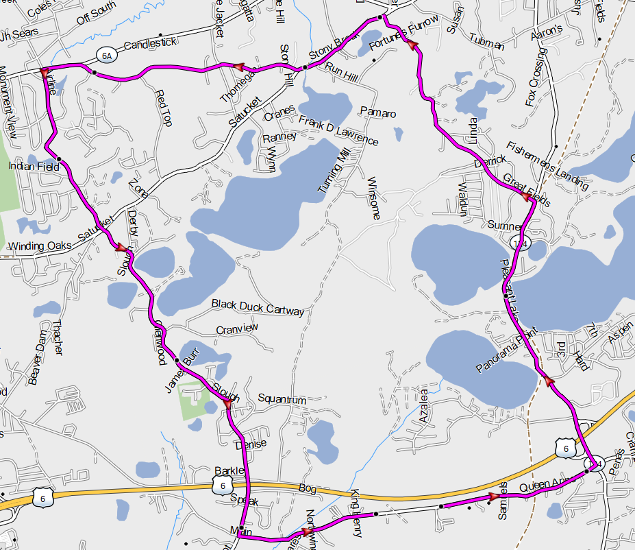

I thing you do not understand how the round trip feature works. Maybe this drawing will make the difference between round trip and your approach clear.

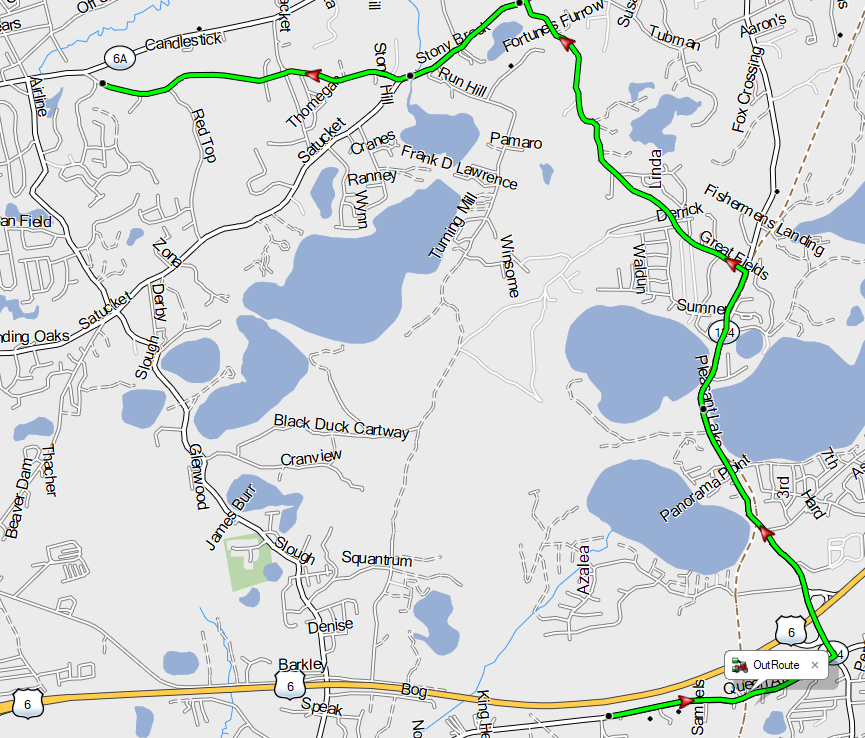

Re: Round trip recalculated
Starting with a route that forms a loop
Before going anywhere, split the route into to separate routes, the first route going out, from start to furthest point

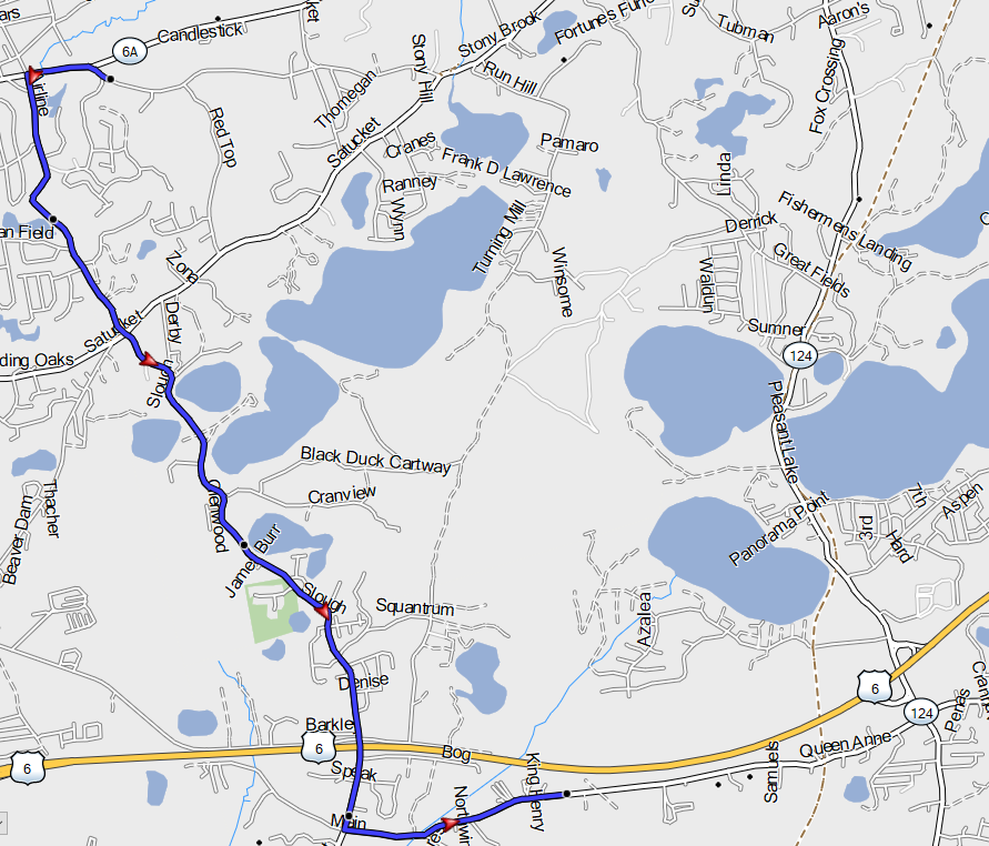

and the second route coming back from furthest point to start.
Select the out route and tap Go. You will, of course, be riding the out route. If you go off route and recalculate, the XT2 will guide you to a point on the out route which you are currently navigating.
It will not guide you to any point on the back route because you have not selected that route.
After reaching the end of the out route - that is the "furthest point" - then select the back route and tap go.
