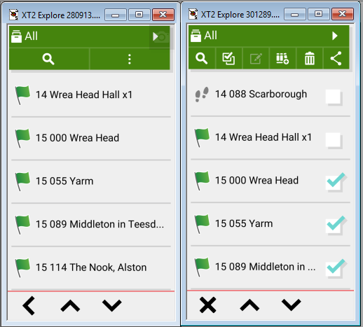

Select the Explore Icon from the main menu
OR : Select Where To ? -> Waypoints
OR: select Apps -> Routes or Apps -> Tracks
They all take you to the Explore collections of screens. They have a green banner at the top.
It isn't obvious, but if you tap that green banner you can choose to display any of the other Explore displays:
All, Waypoints, Tracks, Unsaved Tracks, Routes, Courses, Collections
THere are also a number of symbols at the top - one of which is a vertical ellipsis (3 dots) which opens up a new set of symbols. If you have the camera / screenshot feature enabled, you cannot see or access this icon - so I have to turn the XT2 into portrait view to get a decent image of it.
So the left hand shows the search button and the ellipsis which opens up more options - one of which is Select and Edit.
The right hand shows the screen that is then displayed with some more icons - and the same list with a check boxes alongside.
Icons from left to right:
Search.
Tick box. You can select all or deselect all check boxes - whichever makes life easier for you. Whatever you do next will only affect the items with a tick in the box.
The grey icon of a pen and notepad opens up a screen full of icons that you can assign to ticked item(s). Why it is grey, I do not know. That usually means that nothing is selected.
The shelf of 3 books with a + sign is to indicate collections. Tap this and the selected items will be added to the collections of your choice - which is presented as another tick list. The colelction will be ticked if the items are already members of the collection, or uticked if not. Set the tick for each collection that you want - or untick it. That screen (not displayed) also allows you to create a new collection for you to use.
The bin is obvious - delete the ticked items.
The 3 point/2lines symbol has become synonimous with 'share'. In this case the choices are disappointing - you can put the slected items onto the memory card or share them via the Tread App.
It takes a little fiddling around with it to work out a way that works best for you. I can use it quite well, but so far I keep thinking - I'm sure that I could have made that much easier. It is certainly made a lot easier if you create a separate gpx file for each day's riding. Import just that day and create a collection for that day. But so far I have forgotten to do that !
I should add - The XT1 also has collections. But colelctions on the XT1 were only available if you had Garmin Drive set up to synch with the Explore database. And the Explore database created problems.
The XT2 also uses the Explore database with a new application called Tread. You can choose to synch or not synch - although Garmin make it easy to select the option to synch inadvertently. There are three options:
