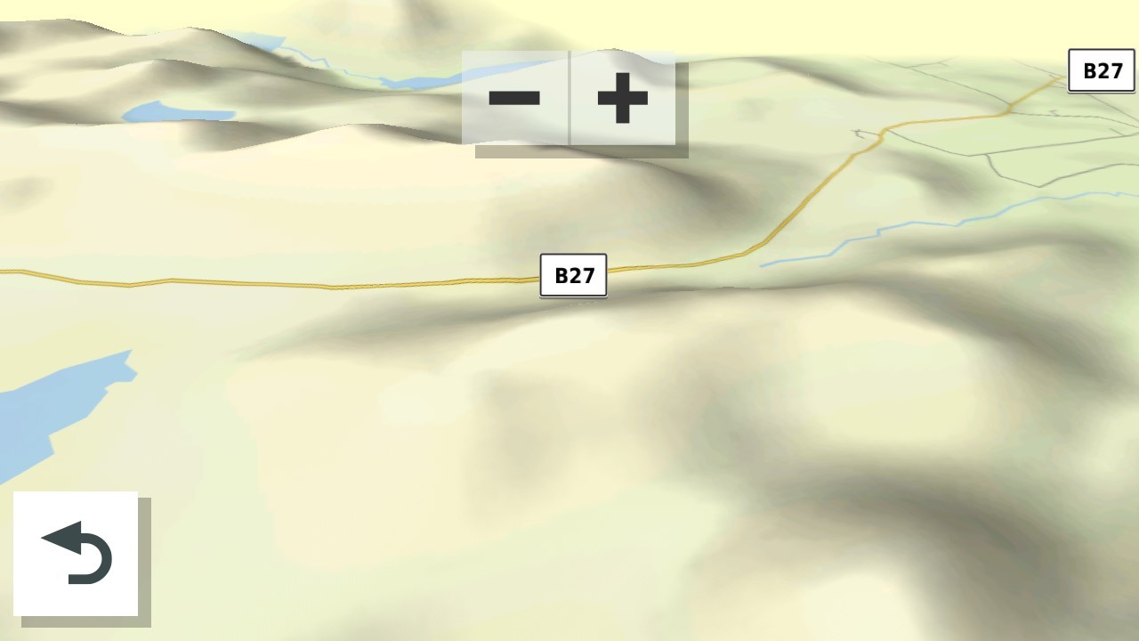

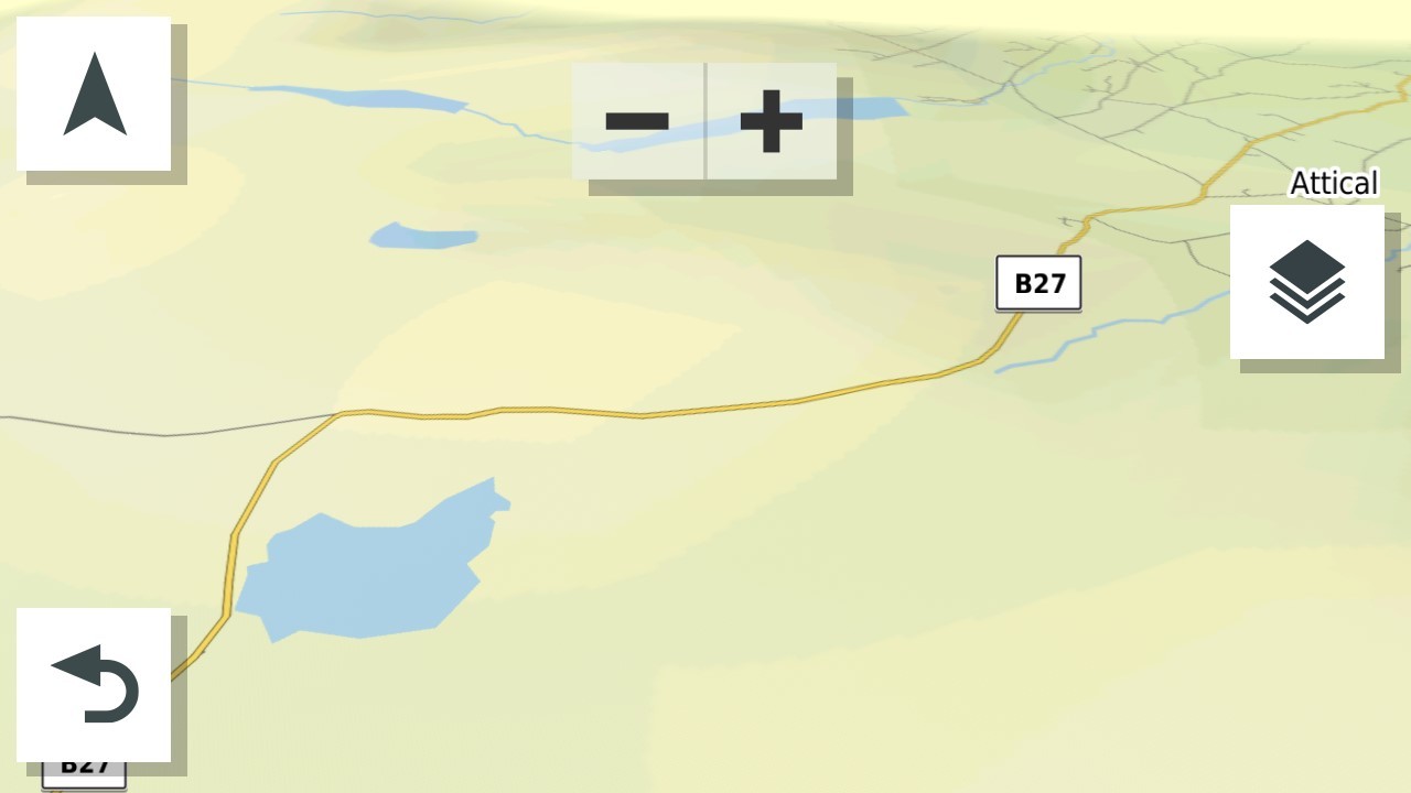

Suppose its more visually pleasing in a lumpy area. In europe it turns on and off the DEM map layer.
On
Off
Re: Map Layers > 3D Terrain?
Ahh... 3D Terrain shows the lumps, Topographic shows the contour lines. Thanks @Mzokk .

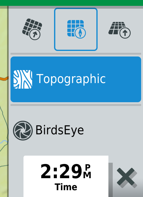

BTW, the view angle of the "On" image in your first post is different from mine when 3d Terrain is enabled. What orientation are you using? I tested three three that are available via the map layers button and none seemed similar to your image. This has been my norm:

I choose the 3d orientation on the right. You can alter the angle of the 3d effect from nearly flat looking down to about 60 degree. To do this open the map and move it with one finger to bring up the -+ buttons at the top of the screen. Then with two fingers by sliding them up the screen the view becomes top down and by sliding them down the screen the angle of view becomes more shallow (within limits). I use it as shallow as possible as this allows the greatest indication of what is coming up. Also sometimes if I'm not running a route and using minor roads I use that map orientation together with the direction compass to roughly navigate on minor roads toward the coast or mountains. It gives a better indication if the road you are about to take goes in the direction you want to go.
I have always used a North Up map view. Your instructions revealed an arrow that changes that map view. North Up is my preferred view although I admit that I sometimes blindly follow the magenta line resulting in taking a left instead of a right when heading south so being able to easily toggle to a North Up view only when I feel the need could be a good thing. I have some playing to do.
