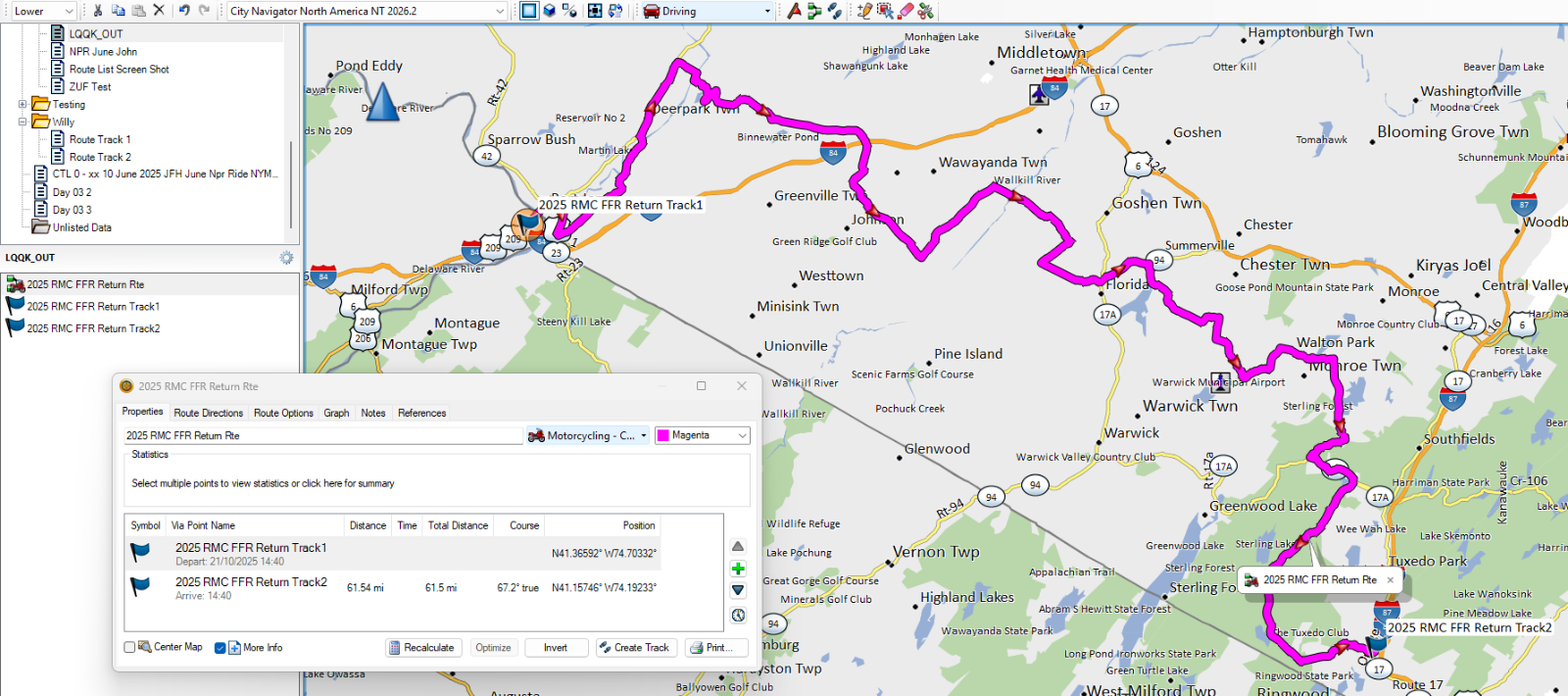

Re: How is Basecamp creating a non-simple route w/ 2 waypoints?
I assume you selected the end point, if you'd selelected the start point it would have taken you there and then along the route to the end point.
You have a route file.
It contains two Waypoints - defined using the <wpt> tag at the top of the gpx file.
The waypoints are marked on the Zumo screen with Blue Flags - these are named as
2025 RMC FFR Return Track1
2025 RMC FFR Return Track2
The route goes from ...Track1 to ...Track2 - that is, from west to east (left to right).
These two waypoints are set to be the start and finish points of the route (a type of Via Point)
There are no other via points in the route (which show on the Zumo screen as Orange Flags)
There are no shaping points in the route, which show as blue discs on the Zumo.
There are ~1370 invisible route points - ghost points (properly named GPXX route point - route point extensions).
Route point extensions are items created by Garmin to make sure that the route that you plot on (say) Basecamp is drawn with 100% accuracy on the zumo screen. MyRouteApp uses the same technique in the gpx file that it exports as v1.2
However, if the Zumo deems it necessary to recacluate the route, it is replacing the existing route with a newly calculated one. And for that to happen, all of the existing gpxx 'ghost points' are deleted and new ones obtained. ie the roads that the route travels will be changed.
The route can be recalculated for any number of reasons:
Also ensure that automatic recalculation is turned off.
And that traffic data is not being relayed from your phone (some Zumos do not prompt - they just recaclulate the route.
If there were shaping points in the route or more via points then any recalculated route would have to pass through each of those points in turn.
In your case there were no additional shaping points or via points. If you skipped the start point, or if the route was recalculated, it would take you to the next route point in the best way it knew how - probably / possibly using the faster road direct to the end point. That would depend on your zumo and what it's internal setting were - and possibly on earlier Zumos - which cradle it was in.
** Do not confuse the term 'Waypoint' with either 'Via Point' or 'Shaping point'. They are not the same thing - no matter what any one else may tell you. (This is a Zumo forum, so I use Garmin and Zumo definitions.)
Click the map for a larger image.
- There is a setting in Basecamp which demands that the route is recacuated on transfer (in Edit / Options / Device Transfer)
- If the maps on the Zumo are different from the ones used to create the route. A prompt is issued which you can refuse
- If the transportation method is different in the file fromt he one set in the Zumo
- If the avoidances have been changed recently in the Zumo
- If you deviate from the route.
- if you are receiving traffic and road closure infor via your phone
- Lqqk_Out.png (737.75 KiB) Viewed 783 times
