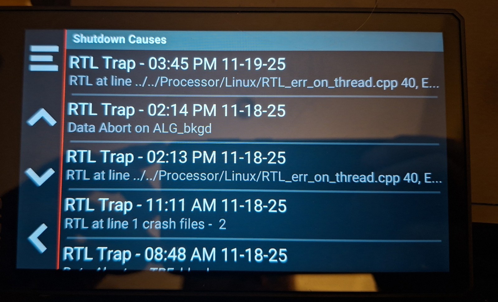

My XT2 will power off, with no messages and reboot itself every now and then when I'm using it in my car. Battery is ok and charging before and after it shuts itself down. So, I'd say for mine, it's software related.
Using the "Developer Info" in the diagnoistics page, accessed by holding the speed display down for 10 seconds in the trip data, and then selecting the "Shutdown causes" I see a lot of "RTL Trap - " ones which seems to correlate with when I saw the problem. And there's lots of them

I had a similar problem related to some GPX files. I imagine you have the Tread disconnected and the XT2's Bluetooth disabled; I'd start there. Then delete the entire GPX history and perform a master reset. I managed to fix it by filtering some of the GPX files I had.Oop North John wrote: Fri Nov 21, 2025 5:39 pm My XT2 will power off, with no messages and reboot itself every now and then when I'm using it in my car. Battery is ok and charging before and after it shuts itself down. So, I'd say for mine, it's software related.
With the latest software version of the XT2 (6.10) I have experienced similar reboot loops, and they have been resolved by disconnecting the Bluetooth on the XT2. It might not be any of these things, but you've got nothing to lose by trying. Cheers,
