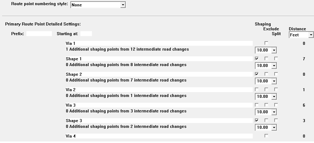

On import of your initial route would look something like this (note that I set numbering style to none for clarity here)

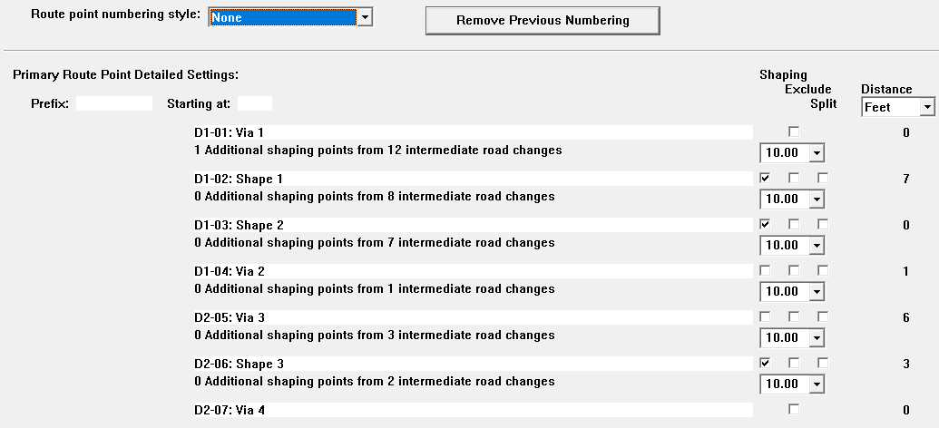

After removing previous numbering

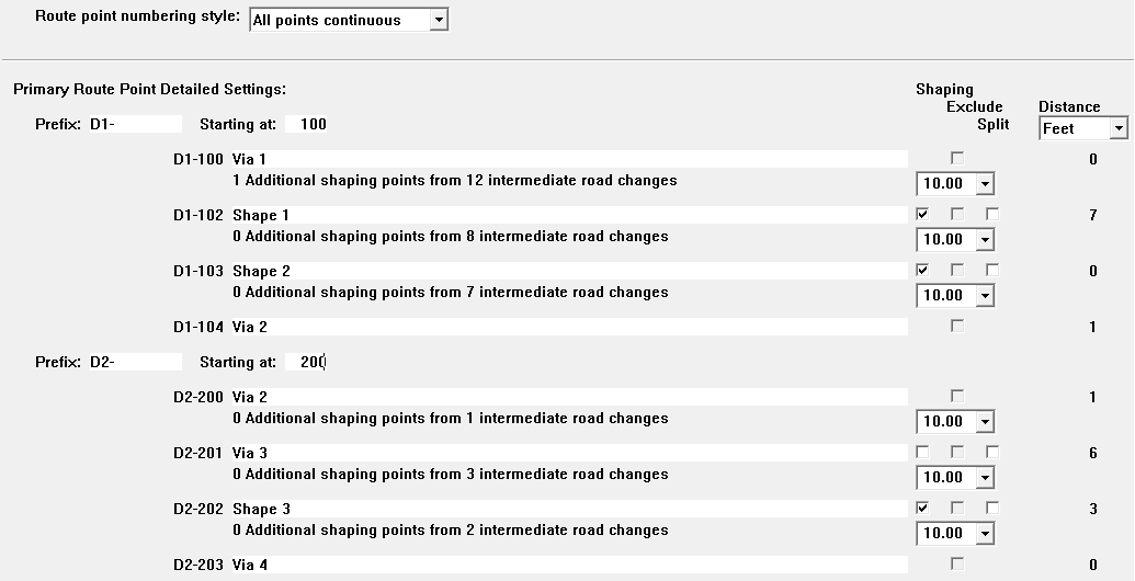

And after setting numbering style, splitting the route, and adding prefixes for each day. Note that I also set starting number values for each route.

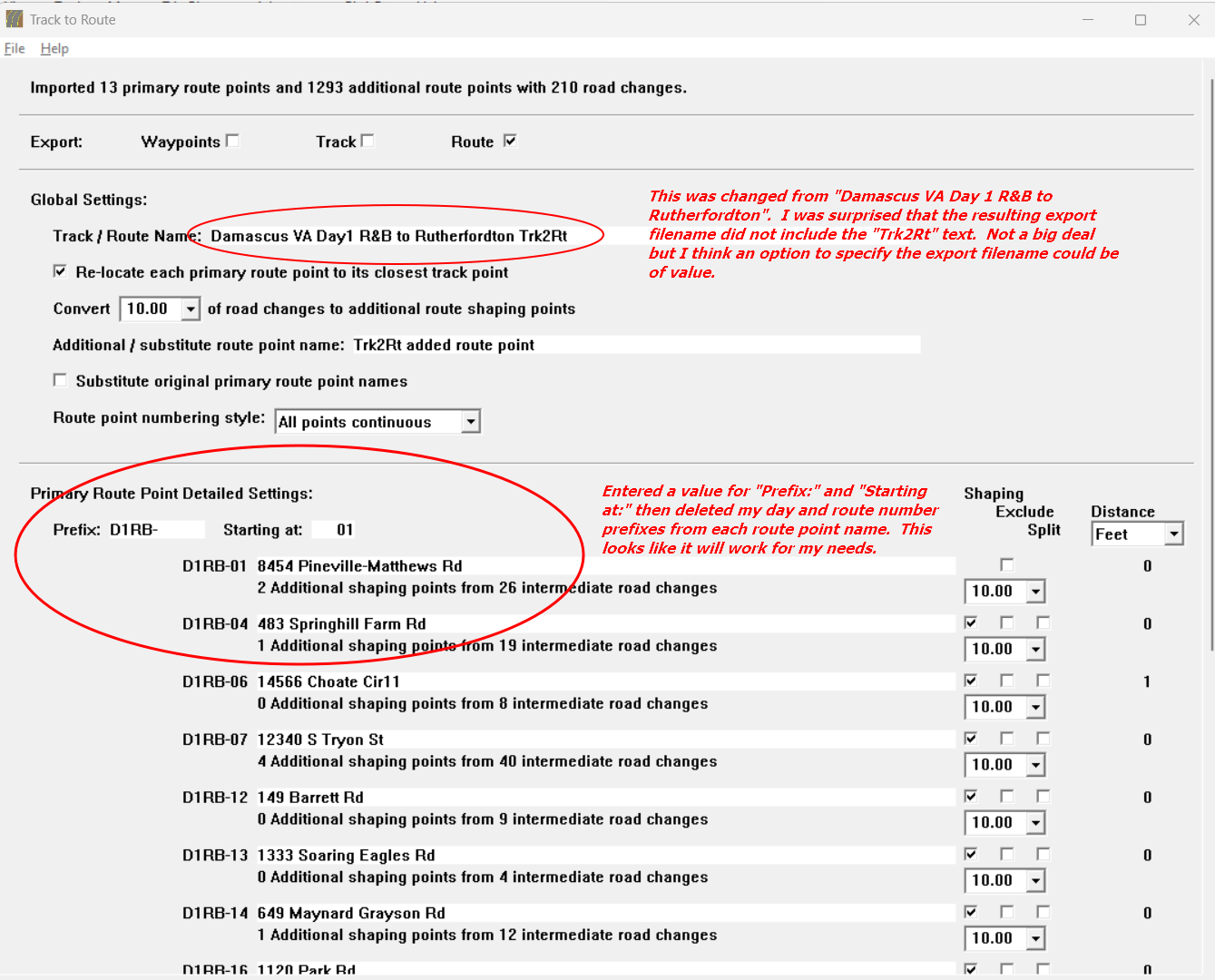

I have tested. Maybe should have done that first but having feedback allowed my to target my testing to my concerns. The image below will explain where I'm at. Something that surprised me is that the .gpx resulting from a Trk2Rt export containing only the route could not be imported into Basecamp. Is this normal?
Definitely not normal. I do it regularly. I suspect that the & character in your route name is the issue. See Avoid special characters on page 22 of the user's manual.
Good to hear that the prefix and numbering will work for you.
I'll add the export file naming option to the V3.1 candidate list. It's a reasonable idea. Thanks for that.
Right now the export file name is based on the import file name. Page 6 of the user's guide provides details.
The Track / Route Name field only edits the name given to an exported track or route within the file.
