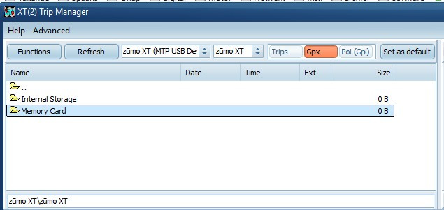

Just bought a new XT2 and am trying to use Trip Manager. Have 32 GB SC card formatted to Fat32 . SD card shows up in right hand window of exe but does not show up in left hand window ie XT files. I've tried everything ie reformat card, reset XT, etc but won't show up on XT side. Trying to transfer GPX files to memory card as recommended . Initially had 128 gb card and it showed up. Transferred bunch of routes to internal drive..worked ok .2nd batch of tranfers caused the unit to lock up trying to open routes.Reset Zumo and deleted routes and ever since SD card not showing up on left hand side of Trip manager.I'm up to date with the latest zumo and Trip manager software. Any suggestions would be appreciated

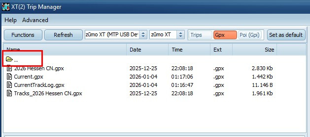

Provided your SD Card shows up in Windows Explorer, this is the method to access it in Trip Manager.
Keep double clicking the 2 dots to get one level up, until you reach the point where you see the SD Card.
If you want to set the default for GPX files to your SD Card.
- Click on the GPX button
- Navigate to the folder on your SD card you want to use. (Using the .. dots)
- Click on the 'Set as Default' button
