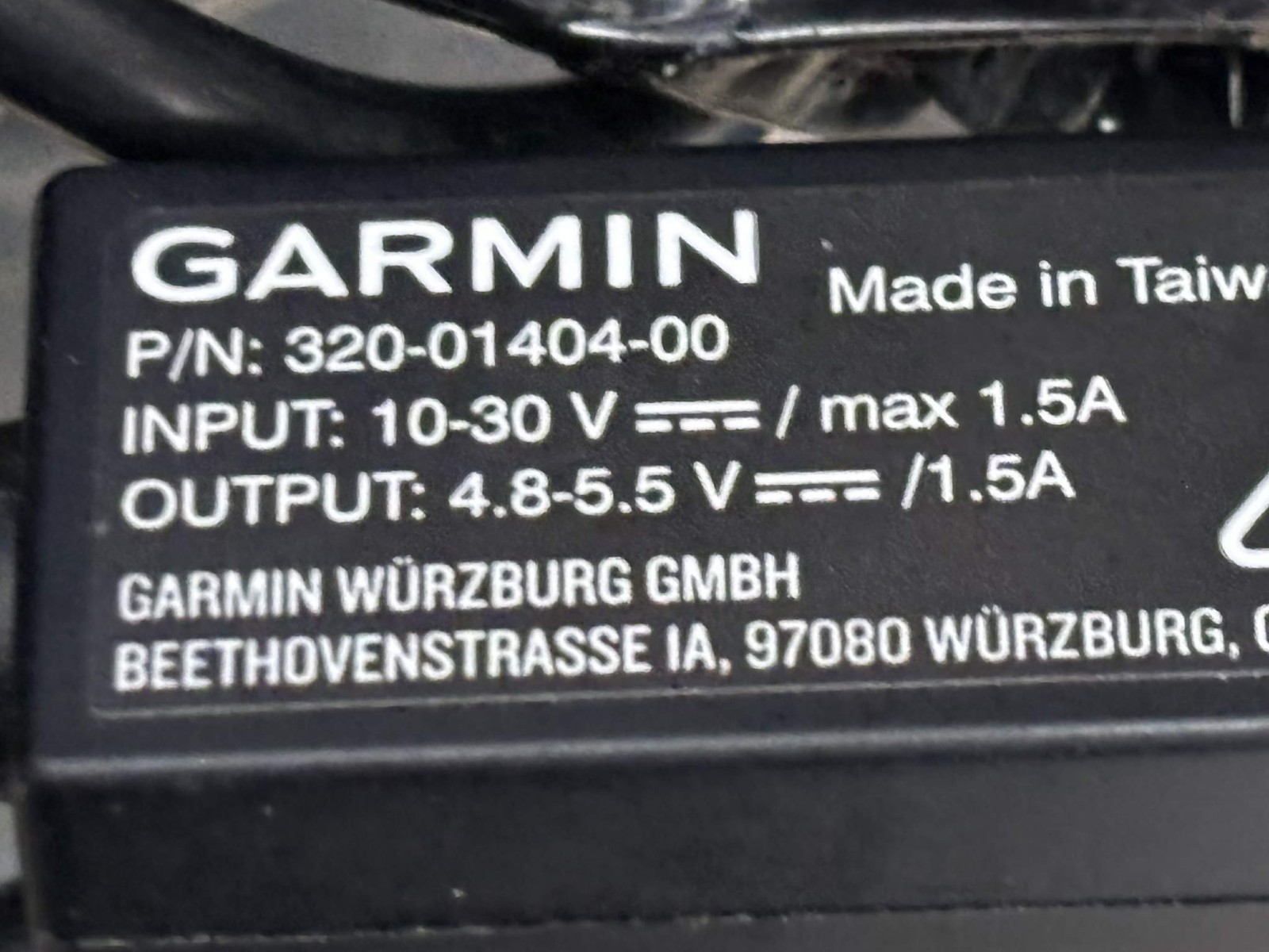

Re: When I Switch My Garmin Zumo XT To USB-C, What Wire Size Should I Use?
That is a good point. The device in the middle of the OEM cable shows this.
zūmo XT Motorcycle Power Cable
Input: 10-30V, 1.5A (max)
Output: 4.8-5.5V, 1.5A
For current draw on motorcycle cable when zūmo XT is not mounted, see Current Draw of the zūmo XT Motorcycle Power Cable.
https://support.garmin.com/en-US/?faq=A ... JTlWs7YacA
zūmo® XT GPS navigator:
When the zūmo XT is NOT connected to the motorcycle charging mount, the parasitic current draw of the Motorcycle Power Cable is 150uA @ 12V.
When the zūmo XT IS connected to the motorcycle charging mount, the current draw is Input: 10-30V, 1.5A (max) Output: 4.8-5.5V, 1.5A.

- Garmin 320-01404-00.JPEG (266.15 KiB) Viewed 714 times
