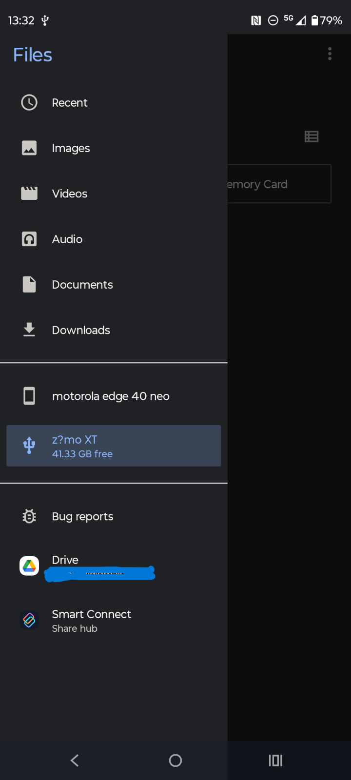

I'm not sure about the XT2 as I don't have one. But you certainly can with the XT and Older Garmin's such as my Zumo 340 and 390. For the older garmins you need a USBc to USBa adaptor to connect the phone to the Garmin USBa to USB Mini B lead. But any phone on Android 14 or above will be able to "See" the contents of the Zumo XT and presumably the XT2 which will need a USBc to USBc lead? The XT and the XT2 use the MTP Media Transfer Protocol to connect to computers. Older devices use Mass Storage and connect with older versions of Android as well as later versions. This make route planning and storage on a phone handy if you are using routing software like MyRoute app as you can transfer routes (in my case) to old zumo 340's or 390's via cable from my phone.
On my phone when I plug the Zumo in.
