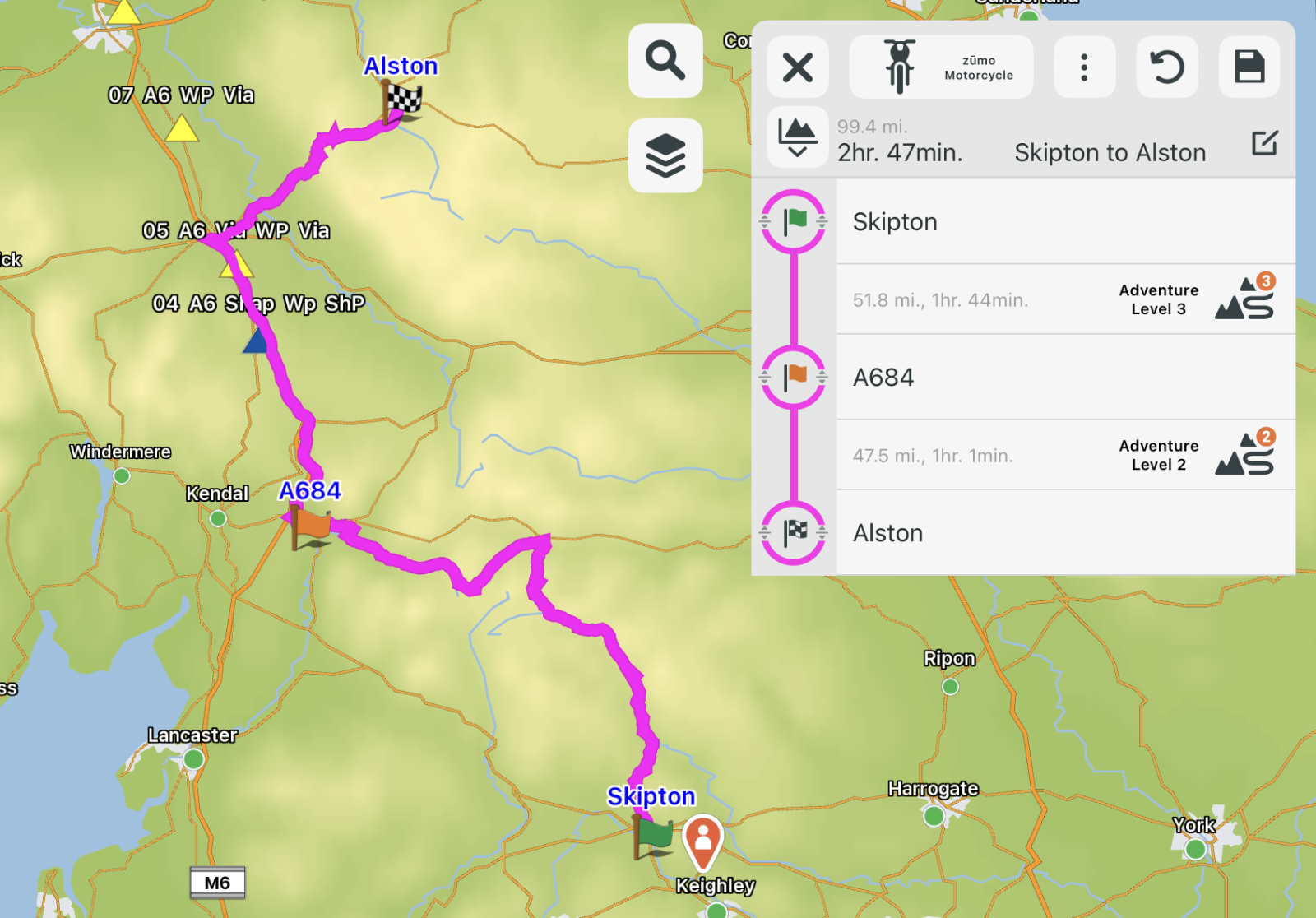

I’m currently working on a video about all the things that are wrong or weird with the Garmin Zumo XT2. Right in the middle of my preparation, I ran into yet another very strange issue, and I’d like to confirm whether this is happening to others as well.
At the start of my preparation, I did a detailed comparison of how the different Adventurous Routing levels and option settings affect routing. I used a fixed test route and tried all possible combinations. Based on this comparison, I selected what I considered the closest match to the Curvy Route option in Kurviger.com, which is my preferred route planner.
I’m now in the phase of testing detour behavior, and that’s when I noticed some very odd behavior with the Adventurous Routing levels on the XT2. At first, I thought this was just a small glitch during testing, but then I realized that something seems to have changed.
My test route consists of 5 waypoints. One of them (4) is a shaping point; the others are via points. The first two route segments use Faster Time, and the last segment (which includes the shaping point) uses Adventurous Routing.
I did not enable the global “Avoid Highways” option, because I wanted to be able to use highways on specific route segments.
When I originally did my comparison, I observed the following behavior:
• Adventurous Level 1: Almost identical to Faster Time, using highways
• Adventurous Level 2: Already avoids highways completely
• Adventurous Level 3: Almost identical to Level 2
• Adventurous Level 4: Adds a few more curves, but mostly unnecessary ones
Since that comparison, there has been at least one major map update. Unfortunately, I don’t remember whether there was also a relevant firmware update.

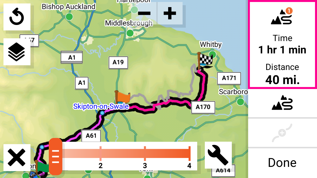

For reference, I’ve added screenshots from the Tread app on my iPad, which still show the behavior I observed on my XT2 at the beginning of January.
Now, however, I’m seeing the following behavior on the XT2:
• Level 1: Still the same — almost identical to Faster Time with highways.
• Level 2: Only a minimal change on the route segment from Via (3) to Shaping Point (4). This looks like Faster Time with Avoid Highways to me.
The segment from Shaping Point (4) to the destination Via (5) still uses highways.
• Level 3: The Adventurous segment now seems to apply adventurous routing — but again only from Via (3) to Shaping Point (4).
The segment from Shaping Point (4) to Via (5) still uses highways.
• Level 4: Finally, the entire segment uses adventurous routing — but it’s noticeably less twisty than Level 4 used to be.
What I find especially strange is that I’m seeing two different routing behaviors within a single route segment, even though only one Adventurous level can be selected for that segment.
Can anyone here confirm this behavior?
Is this a known bug that I might have missed?

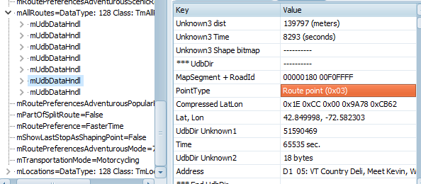

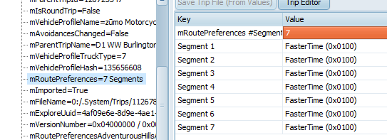

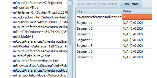

If you open the .trip file on the XT2 in Trip Manager, you can verify the XT2's view of segments and settings. It will show you:
the route segments and routing preferences per segment,
the adventurous level when applicable,
and what each segment is made up of.
Segment Content.png (45.61 KiB) Viewed 678 times
Segments are normally between via points but maybe your last segment became 2 segments somehow - via to shaping and shaping to last via?

When you load a route with Adventurous routing, the value of the slider is not the level that is set for the route segment. The only value that you can rely on is the one in the display for the segement on the right hand side of the screen - a small white number in an orange circle.
I notice that your screenshots show the slider in the position that matches the number in the circle - that isn't my experience - although it is a little while since I started to look into this. I decided that I hadn't got a clue what it was doing and I needed to find a couple of places in the local area for which the stanav would calculate 4 different routes depending on the settings in the XT2. So then I would know from the roads that it used, which setting it had adopted.
Only then could I work out what takes priority. Is it the fact that I have chose level 4, or is it the fact that I have Michelin Maps as a routing preference.
I don't think that you can set an activity number to anything but a whole segment - from what I have seen, the routing as a tag that is added immedidately after a Via Point is declared in the GPX file.

“TripManager” is a really great tool for seeing what is actually stored in the device in the route (trip).

smfollen wrote: Tue Feb 10, 2026 3:11 pm I'm not sure how I could verify what you are seeing but I can share some thoughts that might help you investigate.
Continously having an eye on that, but not with the TripManager ... the Dark Side of the Force - remember?
And all of the info look as aspected - but not the route.

jfheath wrote: Tue Feb 10, 2026 3:49 pm When you load a route with Adventurous routing, the value of the slider is not the level that is set for the route segment. The only value that you can rely on is the one in the display for the segement on the right hand side of the screen - a small white number in an orange circle.
Or the value in the .trip file, I know. And I checked this.
jfheath wrote: Tue Feb 10, 2026 3:49 pm I notice that your screenshots show the slider in the position that matches the number in the circle - that isn't my experience - although it is a little while since I started to look into this. I decided that I hadn't got a clue what it was doing
I already solved that puzzle. When you edit the a route, select a route segment with adventurous routing and press the adventurous button to change the level, the slider will not show what is currently set for the current route, but simply what you selected the last time when you used the slider.
jfheath wrote: Tue Feb 10, 2026 3:49 pm and I needed to find a couple of places in the local area for which the stanav would calculate 4 different routes depending on the settings in the XT2. So then I would know from the roads that it used, which setting it had adopted.
Oh, I allready went down that rabbit hole.
jfheath wrote: Tue Feb 10, 2026 3:49 pm I don't think that you can set an activity number to anything but a whole segment - from what I have seen, the routing as a tag that is added immedidately after a Via Point is declared in the GPX file.
And this is what I did and what I expected to happen. And this is actually my confusion. I should not be possible that one segment has two different routing modes between the routepoints.

In my experience, I can set the adventure level per segment in the Tread app, but on the XT2, every change is applied to the entire route. Has that been your experience as well?
In my opinion, the Kurviger app is much easier to use, especially when it comes to adventure. Export it as a track, and you're all set.
Re: Changed adventurous behavior on XT2
vigo wrote: Sun Feb 15, 2026 8:57 am
Tracks work for a lot of people, but I am not a fan of using tracks to navigate - I like to have the estimated time of arrival at the next 'pit-stop' particularly for my pillion. Also when navigating a track, if you deviate, that can be subject to RUT behaviour as well. I like to have the track displayed under my route so that I can see where the XT/XT2 has changed it - and I can choose to follow whichever I want. Typically, on a well prepared route, the Zumo will recalculate the current section to head the way I decided to travel.
vigo wrote: Sun Feb 15, 2026 8:57 am In my experience, I can set the adventure level per segment in the Tread app, but on the XT2, every change is applied to the entire route. Has that been your experience as well?
I can see why you might think that - but no. It applies it only to the seqment being edited. The problem is that when you select a segment to edit, the sliding scale shows the last value that was entered.
If you synch the route with the Tread App - not something that I recommend, but I do it occasionally - the Tread App on your phone or ipad will show you the setting for each segment. (A segment is a part of the track bounded by a Via Point at each end).
****Wrong ****Also the route planner screen on the XT2 will reveal the level as a tiny digit in an orange circle.****Wrong !!
I'm looking for some screen shots. I'll post some later. I found one - attached below. However - I was wrong - when you open up the Trip Planner App and select an existing segment, it shows the screen below, but the digit represent the current setting of the slider, not the setting assigned to that segment.
However on my phone and Ipad you get the entire route in a table on the right hand side and it shows the level assigned to each segment. Select the segment from the table to edit the setting. Click the image to zoom in to a full sized version.
Screenshot 2026-02-15 at 10.04.10.png (1.07 MiB) Viewed 507 times
