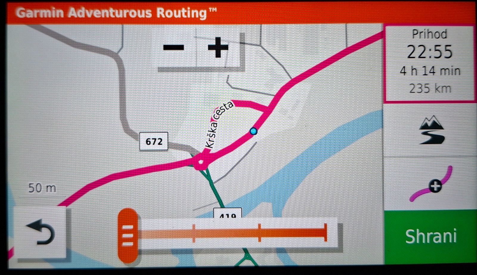

Hi everybody. I am still using the original Zumo XT and I always update everything, as soon as the message hits. My route planning software is MRA, and I have gold membership so that I can use HERE maps with my Garmin. I use via and shapping points and export to gpx 1.1 and then throughout Drive to Zumo XT... It works and generally I am happy.
Lately I noticed some weird navigation; I think I first encountered that in November, but not sure... And I didn't change any settings...
This is just one example of the weirdness:

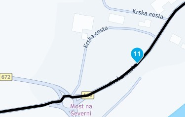

This is how one part of the map looks on MRA - and this is exacly as I want it:

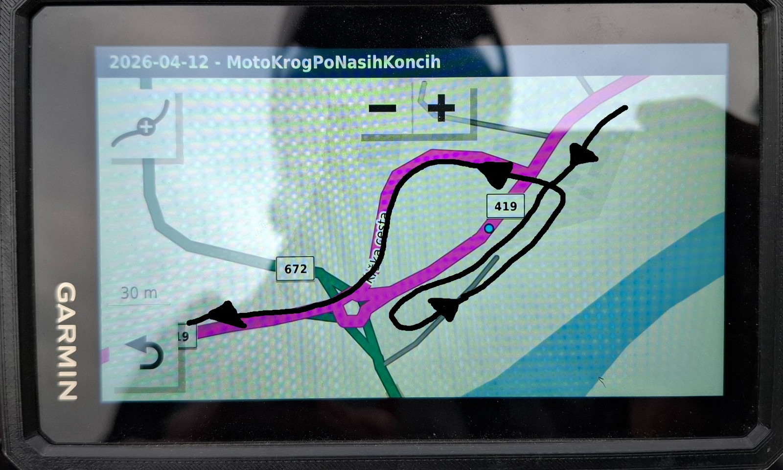

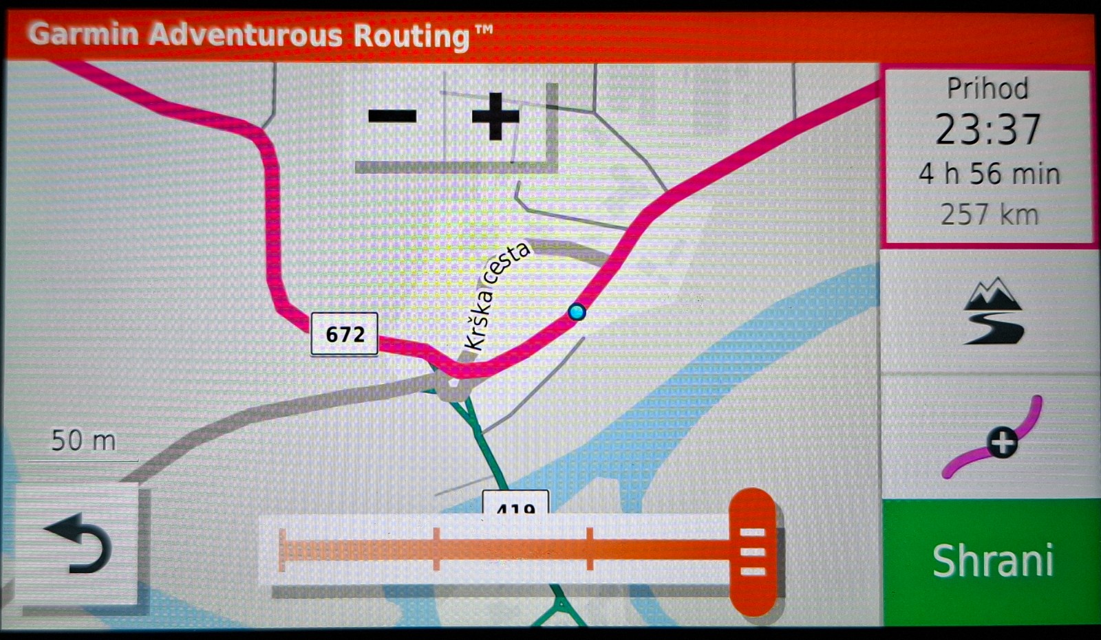

This is how it looks in Zumo XT maps and the black arrows shows how XT wanted to navigate me through this section:
By default, I have selected "shortest way" option. It is the same if I select the "shortest time" option. But if I select the "adventures routing" option, then I get (but notice that not the exit goes to some other road):
If I use the cursor "adventures routing" to less, it is the same as original pointless navigation:

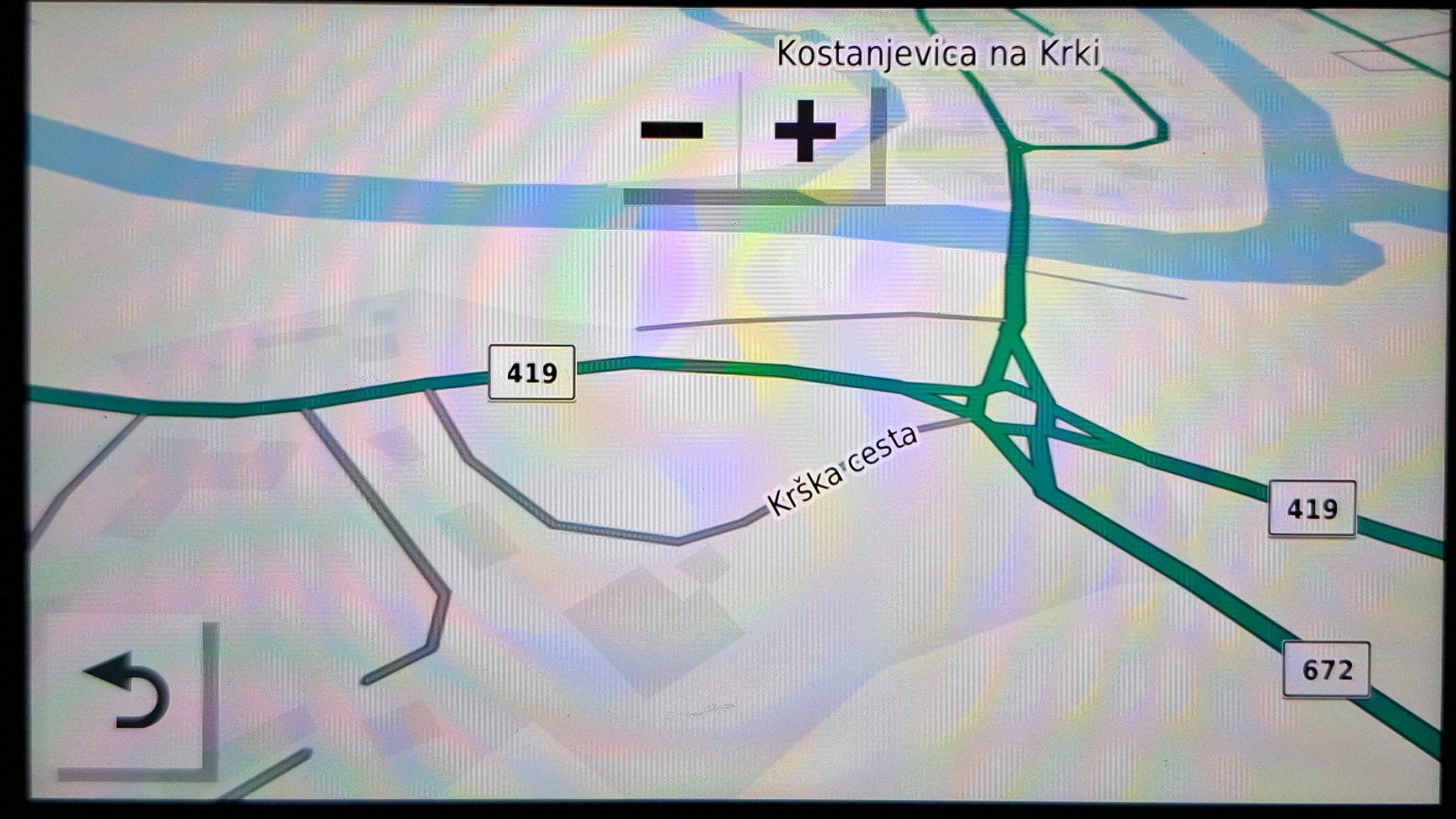

What is weird though, this is the original map on my Zumo XT of this section, when I don't have navigation active (it has everything connected and it shows that Zumo XT knows which road is the main one):

b1324 wrote: Sun Apr 12, 2026 5:28 pm What is weird though, this is the original map on my Zumo XT of this section, when I don't have navigation active (it has everything connected and it shows that Zumo XT knows which road is the main one):
This image appears to be what the XT would calculate if that route point (blue dot) was being detect by the XT as being in the lane moving away from the roundabout. The XT would circle you around the roundabout to route you through that route point and then would return back to the route which it decided was best done by turning left back to the roundabout. This is just a guess though.

Yeah, I wonder if the blue dot was placed accidentally in the wrong lane. Maybe zoom in further on BaseCamp and see if it’s in the correct lane.

This is a good point, but I don't think this is the case.

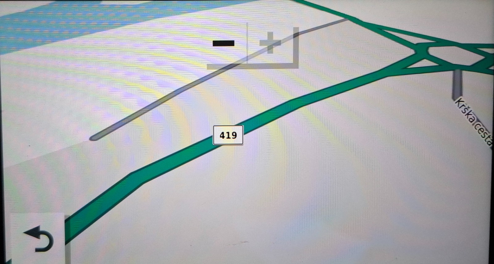

If I zoom to the max on my Garmin XT, it still shows this road as a "normal" road (it doesn't seem to separate lanes):
I don't use BaseCamp, I use MRA (MyRoute App) which uses HERE maps (same as Garmin). Also on MRA I cannot place the VIA/SHAPING point on the different lane in this road. I guess this road is just to narrow for this.

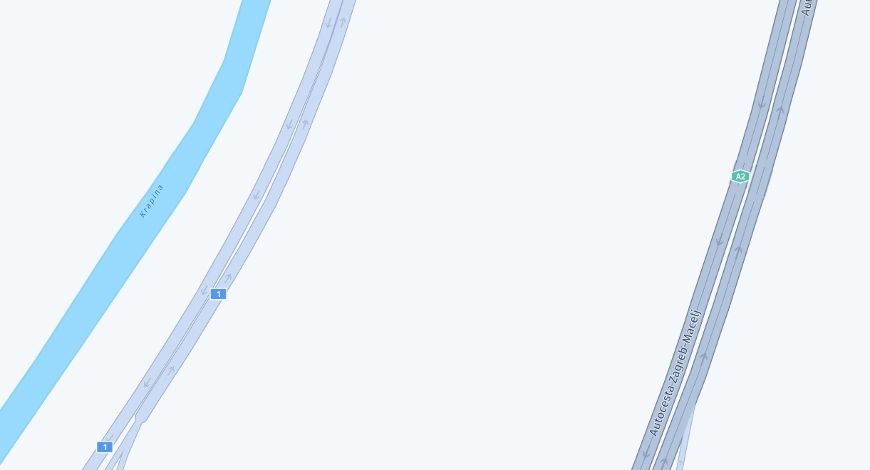

But if I navigate to different part of the map, there are wider roads which has separate lanes (on the left side is just some wide road, and on the right side there is the payable motorway):
I guess there must be something else...

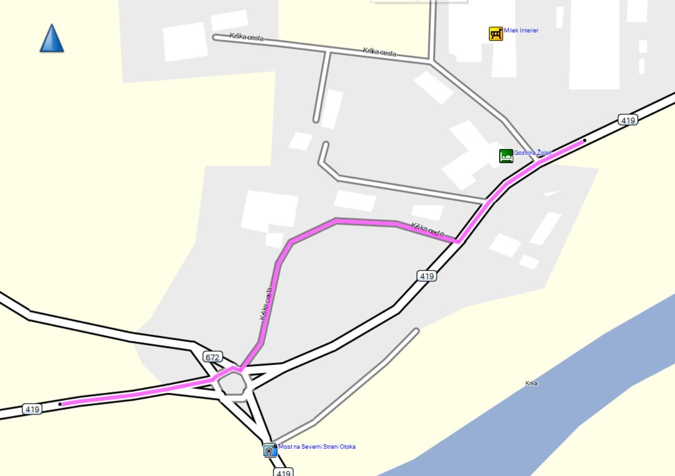

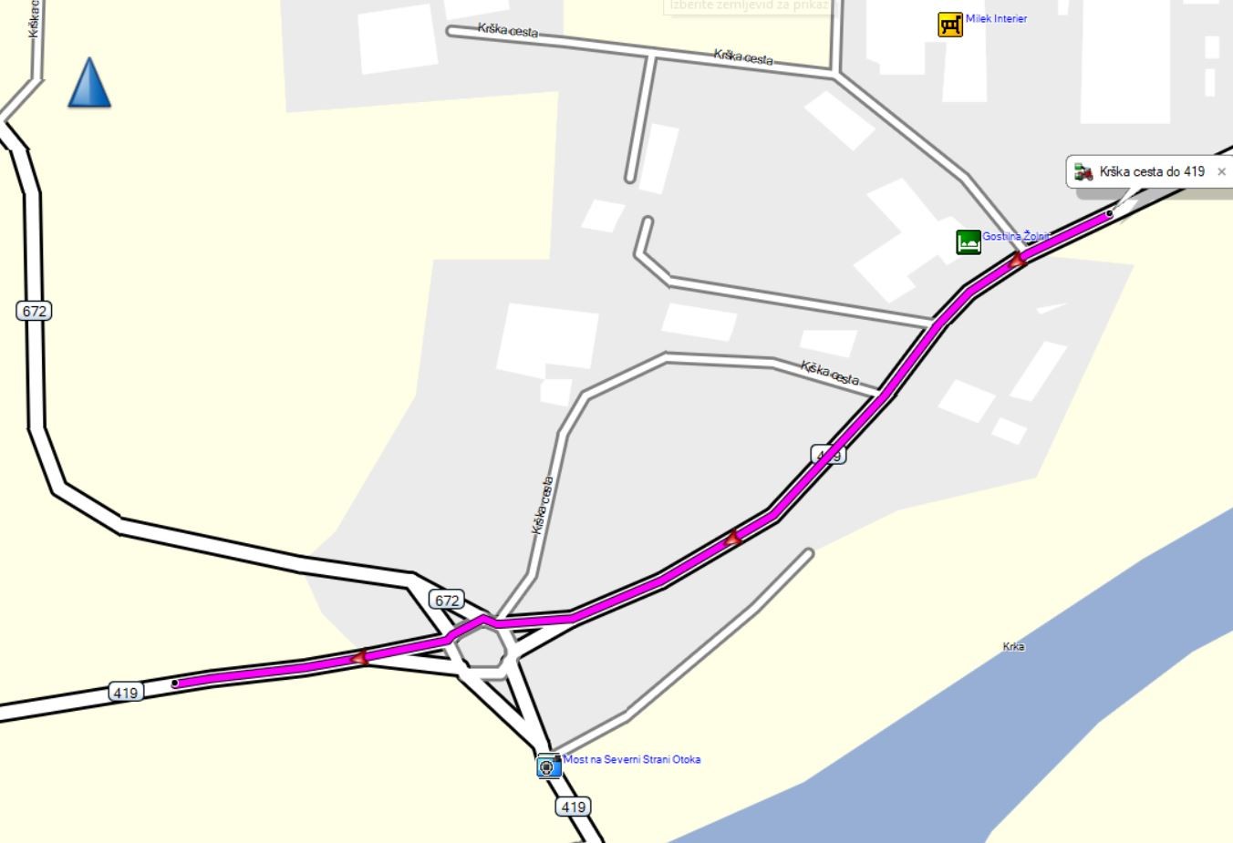

Interestingly, BaseCamp draws the road section in the vehicle settings for a motorcycle like this:
Zajeta slika.JPG (75.59 KiB) Viewed 620 times
in the car setting like this:
Zajeta slika1.JPG (86.36 KiB) Viewed 620 times
