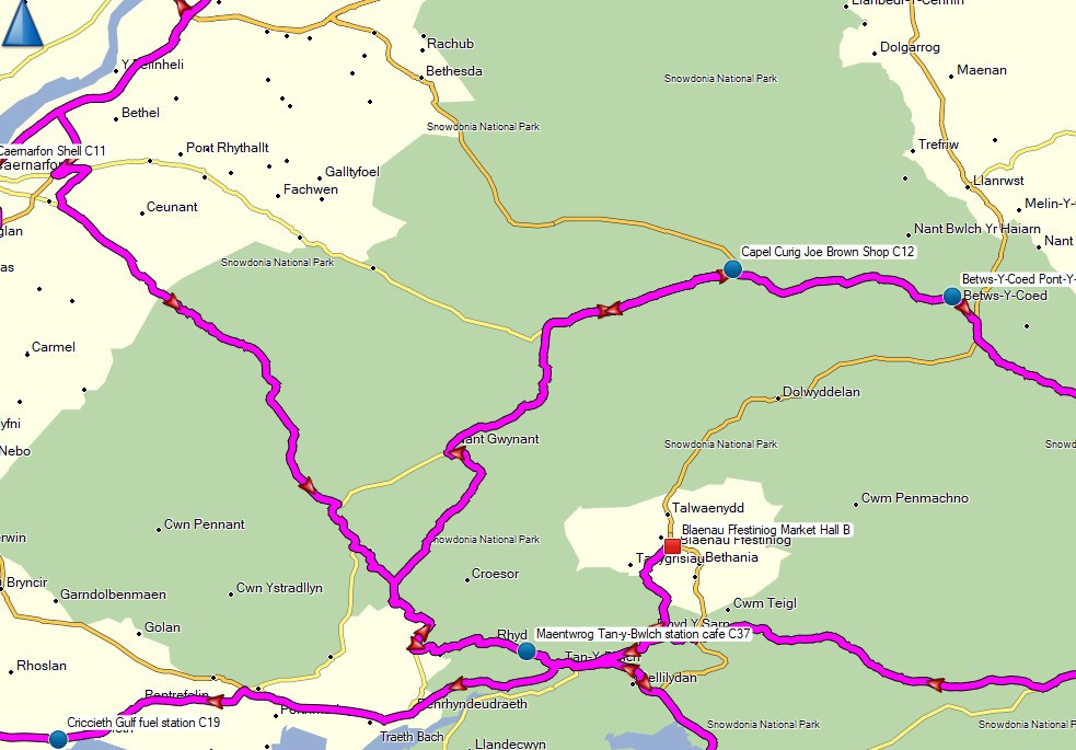

I'm frequently perplexed as to why BC (always set to "fastest" route criterion) will, when set to "Motorcycle" routing, send me off a fast main road onto what is usually some frightful minor road, albeit subject to the same speed limit as the road I have been diverted from, only to rejoin it a few miles further on but won't do the same when set to "Car" routing. Alse, if I ignore the diversion the journey time drops.

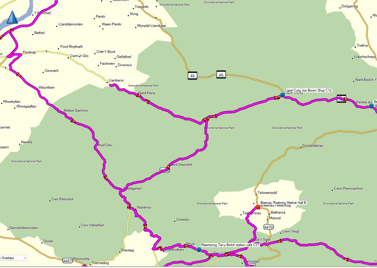

I've just created a route for a rally and the most horrendous deviation has been calculated by the default motorcycle routing.
Can anyone explain this, please?
TIA
Richard

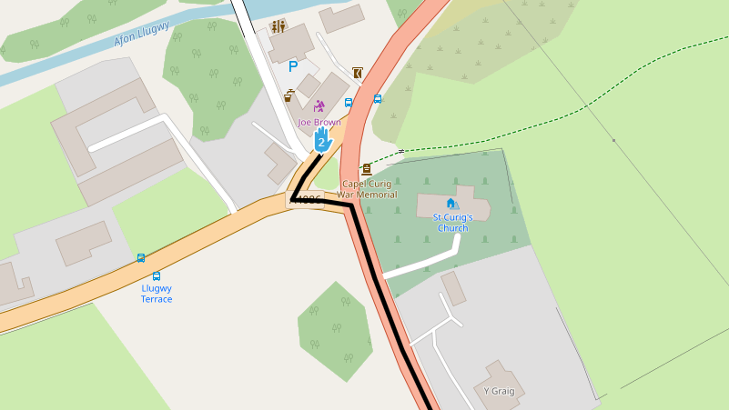

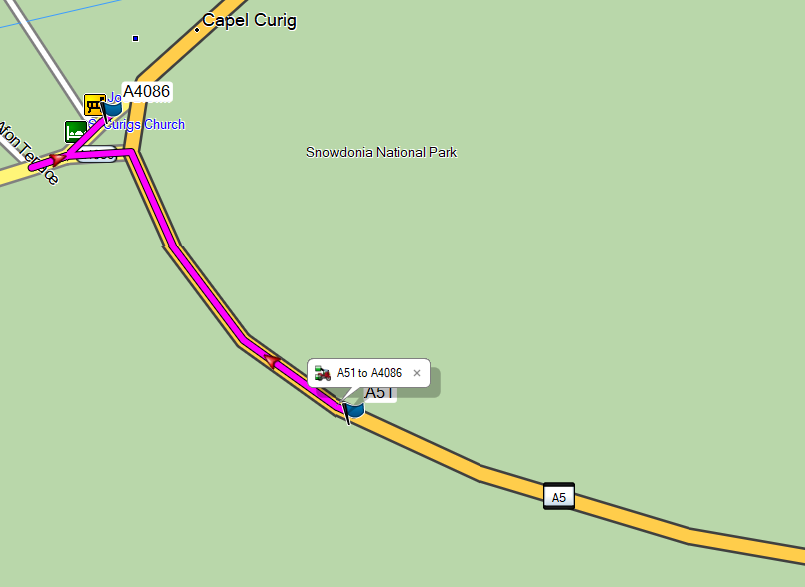

It seems that "don't allow U turns" was being interpreted by car routing and motorcycle routing in different ways. BC thought that bikes cannot negotiate some, hairpin, junctions but cars can - as shown in the screen grab.
Turning "Centre map" off, as suggested in a reply to my other post, helped in finding this quirk.

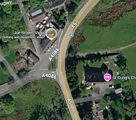

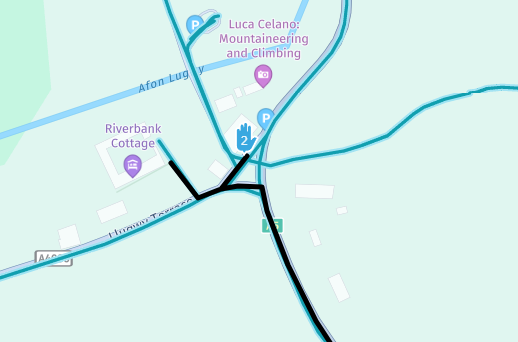

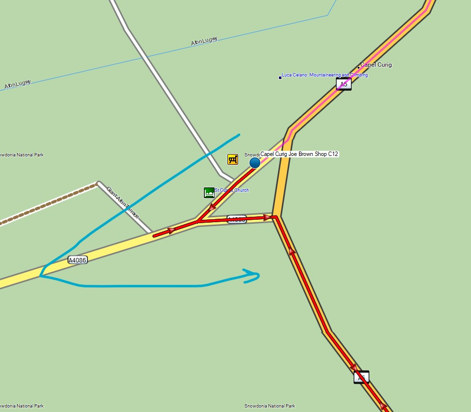

OK I've had a bit of a look at this and for the deviation at "Joe Browns" Shop this is a fault with the Here mapping used by Garmin if it is reported to HERE it should get fixed (Eventually).

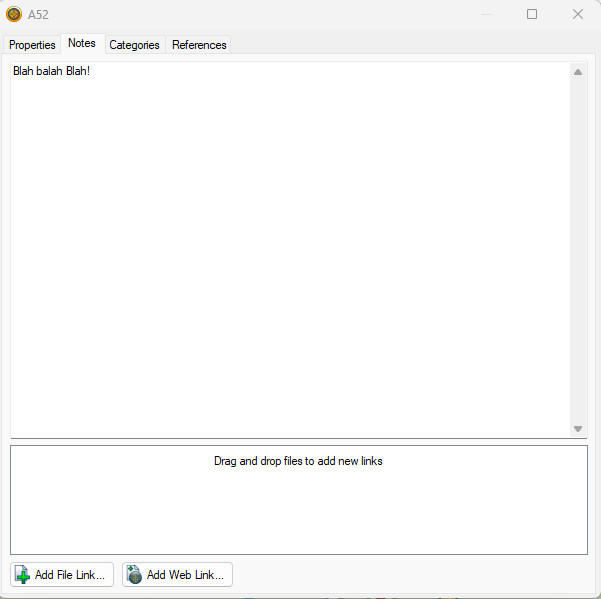

This is what it looks like on my Basecamp mapping CN Europe 2027.10 If I use HERE maps on MyRoute app route planner for the same Junction it does this. And if I use Open Street Mapping on MyRoute app it displays correctly. I'm not sure what Satnav you are using but you could get round this by leaving your last waypoint a little before the Junction at the A4086 and putting instructions to stop at the shop in the "Notes" section of the Waypoint attributes. On XT models the notes will be read to you.
With regard to the Faster Time setting sending you down minor roads. There are two ways to fix this. The best way is to scrutinise your route and fix deviations with shaping points on the roads you want to be on. Placing a shaping point every 3-5 miles pins the route and makes it more likely that everyone will end up following the same route if you are giving the GPX files for others to use. In this case I would also give them a "Track" of the route so that they can be sure that when they calculate the route on their own devices everything will match. To semi permanently stop Basecamp routing down little tracks you can also alter the parameters it uses to calculate "Faster Time". If you go to EDIT>Options on the menu and open Activity Profile you get this.

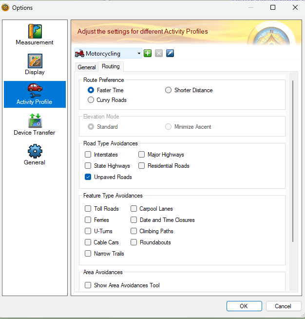

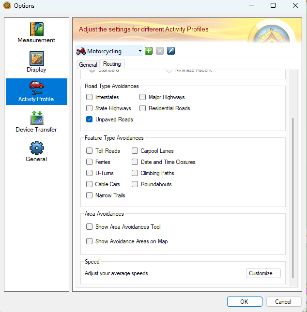

Go to Routing and scroll down to speed Customise This will open the speed dialog for roads these are the defaults If you reduce the speeds on the lesser roads it will make Basecamp less likely to use these when you plan a route.
