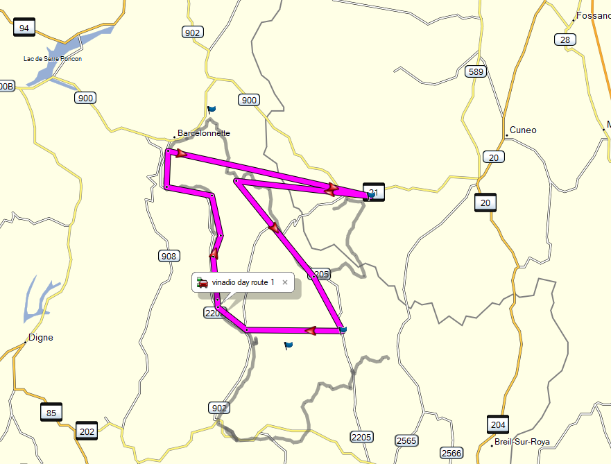

After I had sent the route to the XT - while reviewing them - I noticed that they were mostly straight line - direct routes, when transferring I also got the message " routes sent to xt were recalculated as map they were created on is not installed on the device"?
when I view the routes on basecamp using the map installed on the XT - it is lacking detail - with many of the actual roads not even shown.

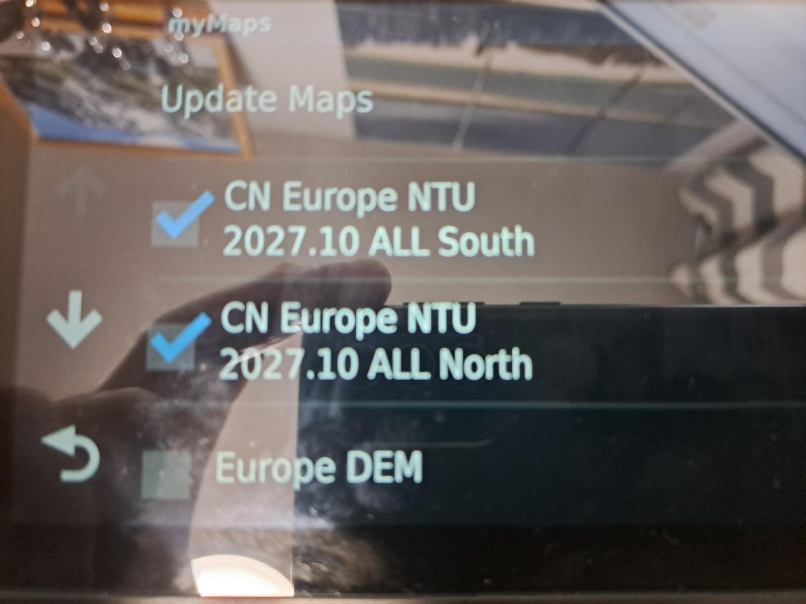

My maps on the xt shows cn europe NTU 2027 south + cn europe NTU 2027 north

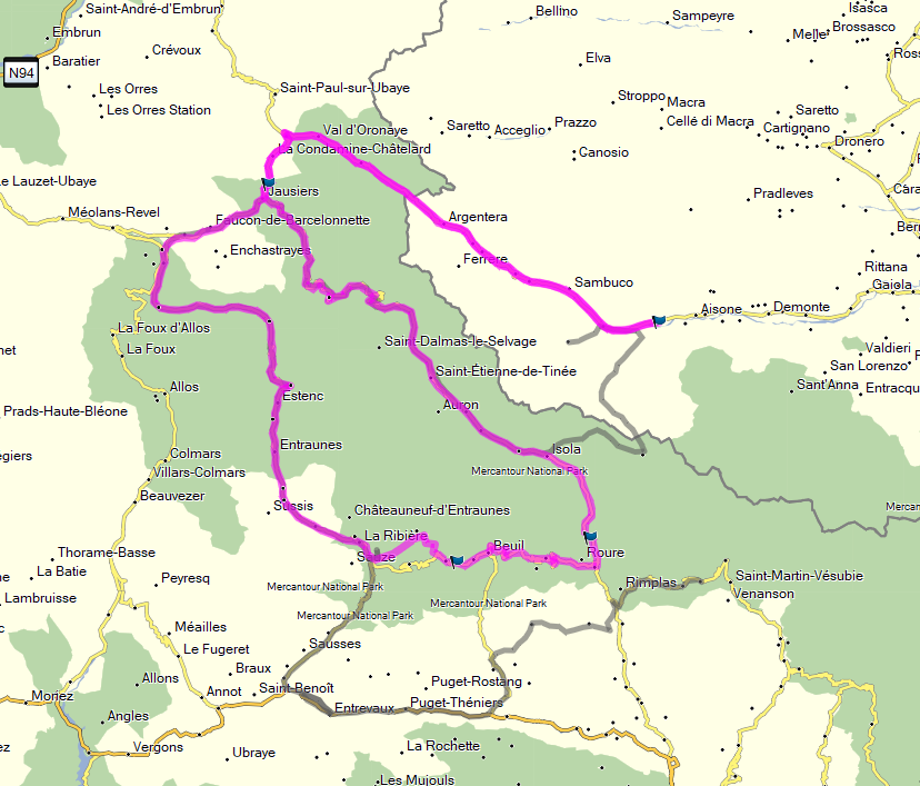

Screenshot 2026-05-07 232958.png (286.83 KiB) Viewed 273 times
Screenshot 2026-05-07 233244.png (211.21 KiB) Viewed 273 times
Screenshot 2026-05-07 233321.png (82.9 KiB) Viewed 273 times

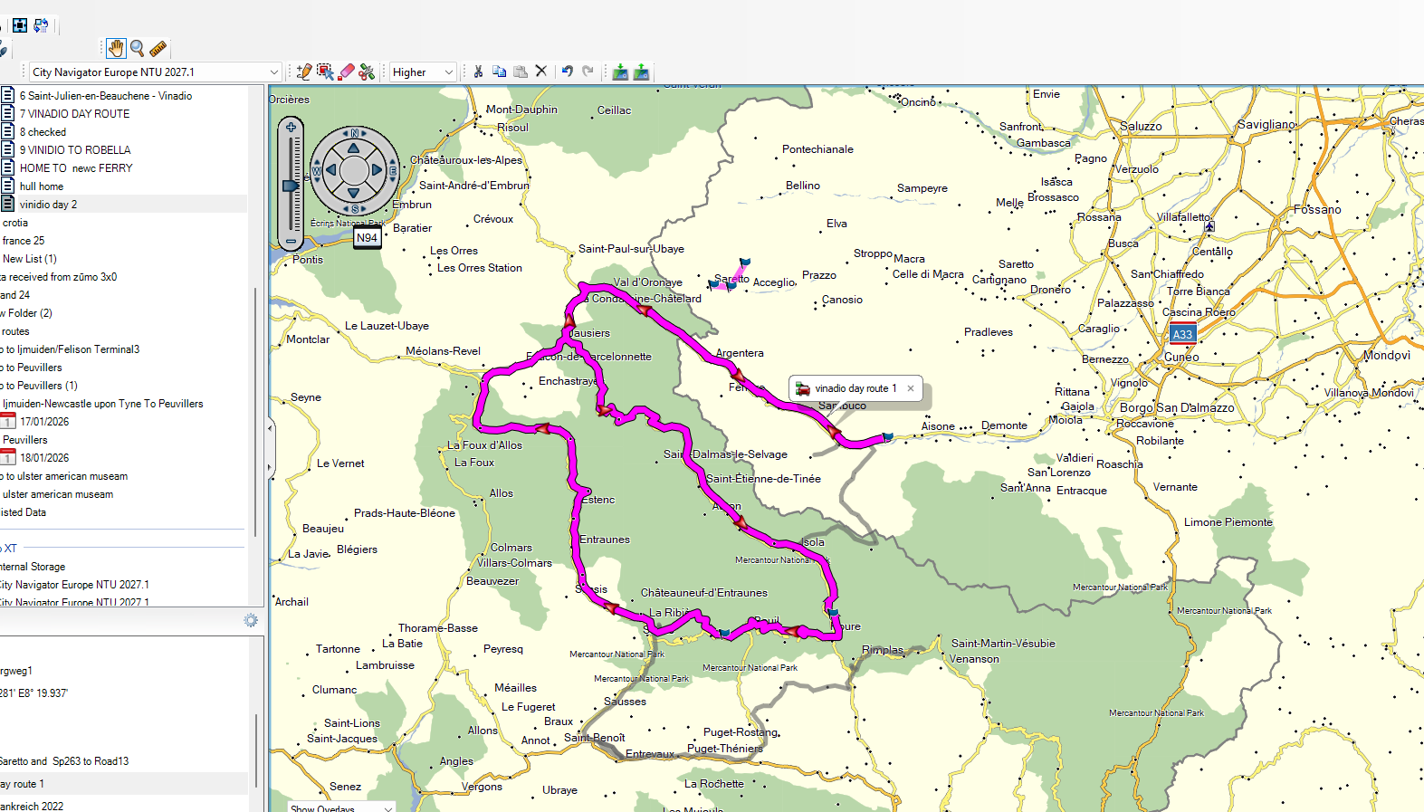

Definately says CN Europe NTU 2027.1 when I used the version installed on the Zumo XT photo 1 - but route is straight line with no detail
But when I use version installed on PC photo 2 - it all looks ok?
Steve
The attachment Screenshot 2026-05-08 003249.png is no longer available
Screenshot 2026-05-08 003721.png (640.16 KiB) Viewed 267 times
Screenshot 2026-05-08 003249.png (283.39 KiB) Viewed 266 times

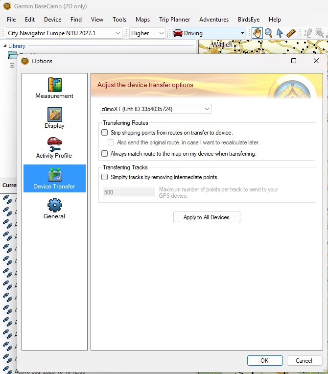

Not sure if this your problem, but please check the 'Transfer settings' in Basecamp. All checkboxes should be unticked.
To verify that the loaded maps on the Zumo are OK, you can use Garmin Express and try a reinstall of the maps.

4 Device transfer have unticked always match route map - unticked

one thing I have noticed, when I use the map installed on the zumo on basecamp
I can get detailed maps in north Europe but not south Europe?? In the drop down, there are 2 maps installed on the Zumo, I presume one for north one for south? When I select one of the - it comes up with an error - error occured while attempt to use this map?
