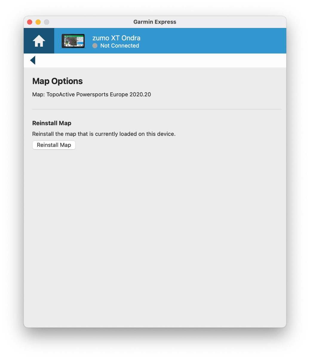

Re: Installing map to PC
I don't see the option "Instal to Computer" any advice for me. I just see "reinstall map" option.sussamb wrote: Mon Oct 05, 2020 9:24 pm You should see a Map options button, then you can elect to install map to your PC.
Thanks.
download/file.php?mode=view&id=606
