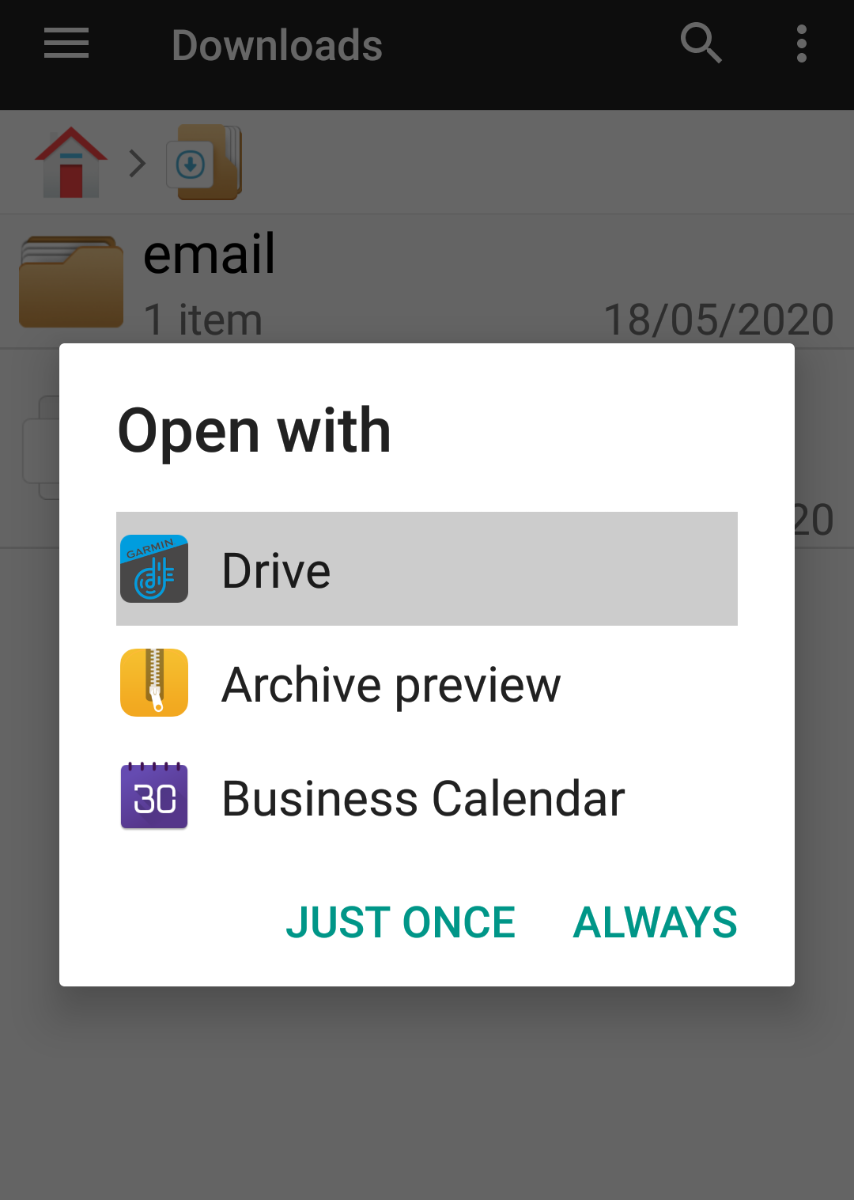

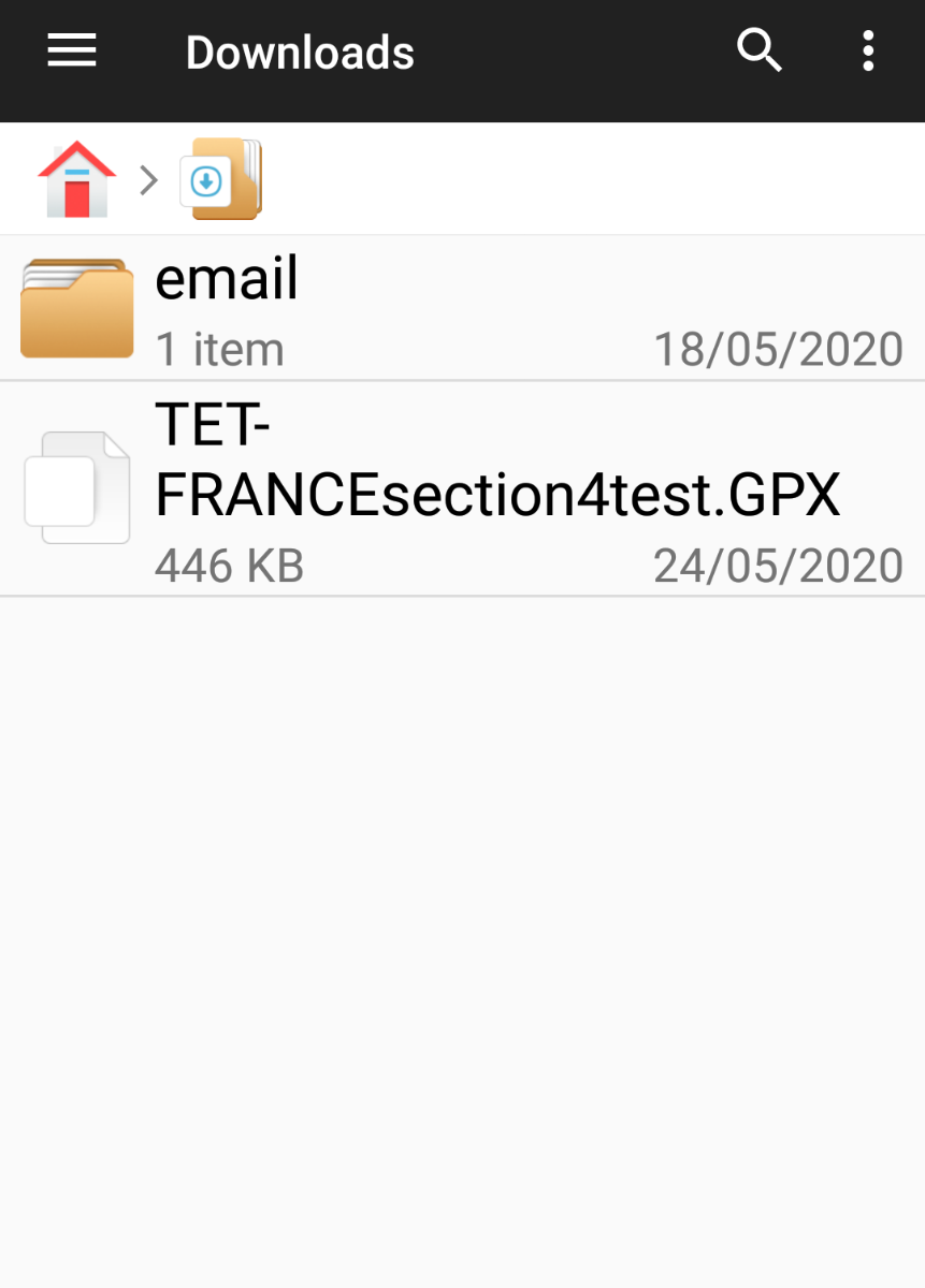

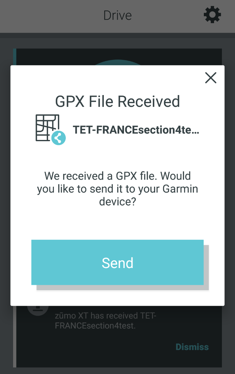

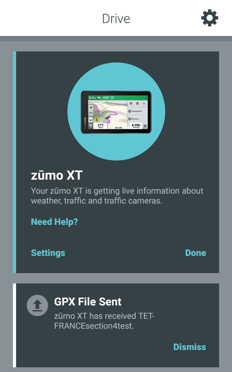

install Garmin DRIVE app on your phone, download your TET gpx file to the phone (i renamed it) , click on the .gpx file and open with DRIVE, transfer the file to the Zumo XT.
The gpx file will be found in the XT's TRACK section.

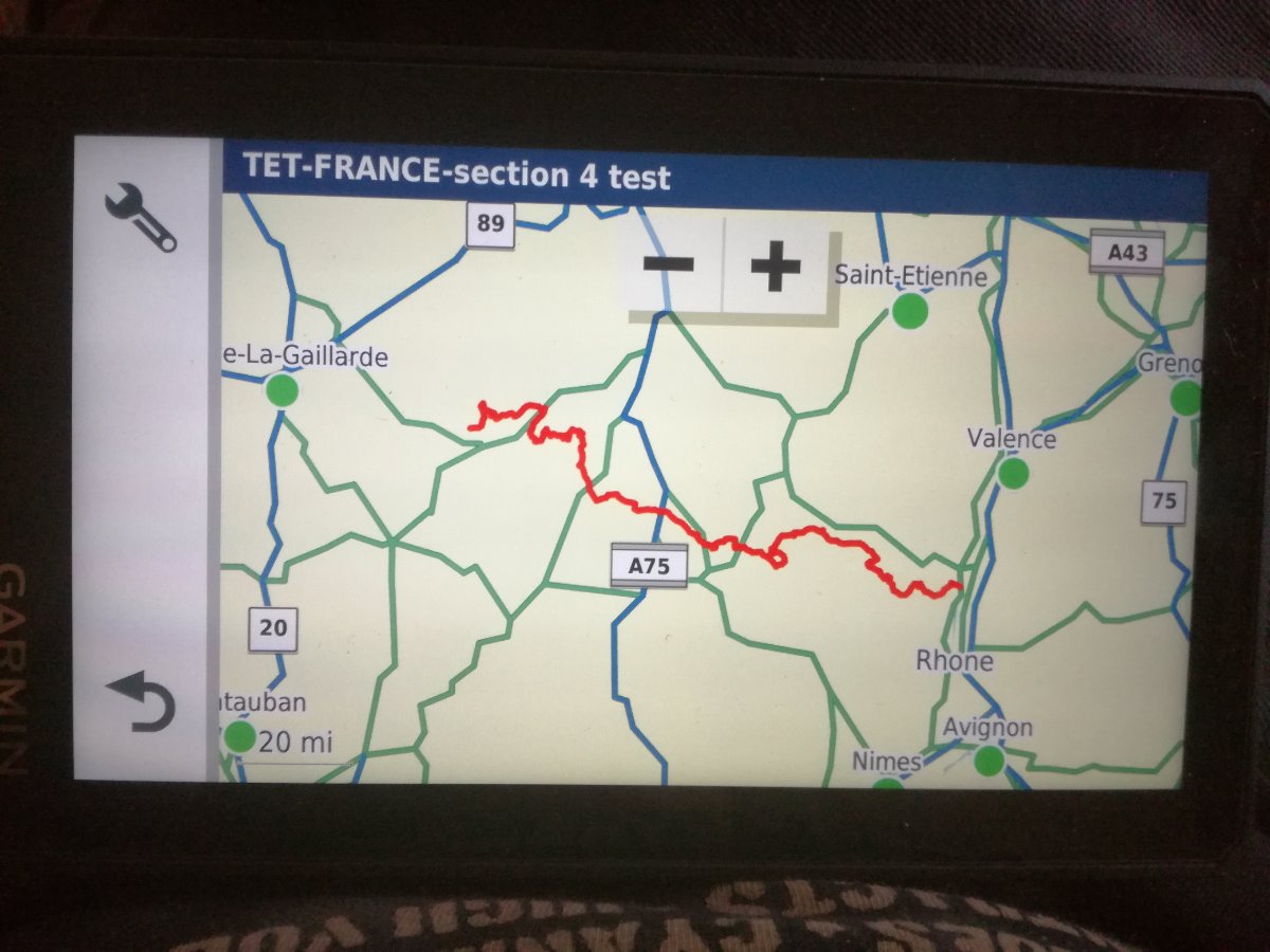

I was able to see the track onscreen but when I tried to convert it to a Route the XT got stuck on 18% ?? .. whether it was too big or an invalid file I do not know 🤔
