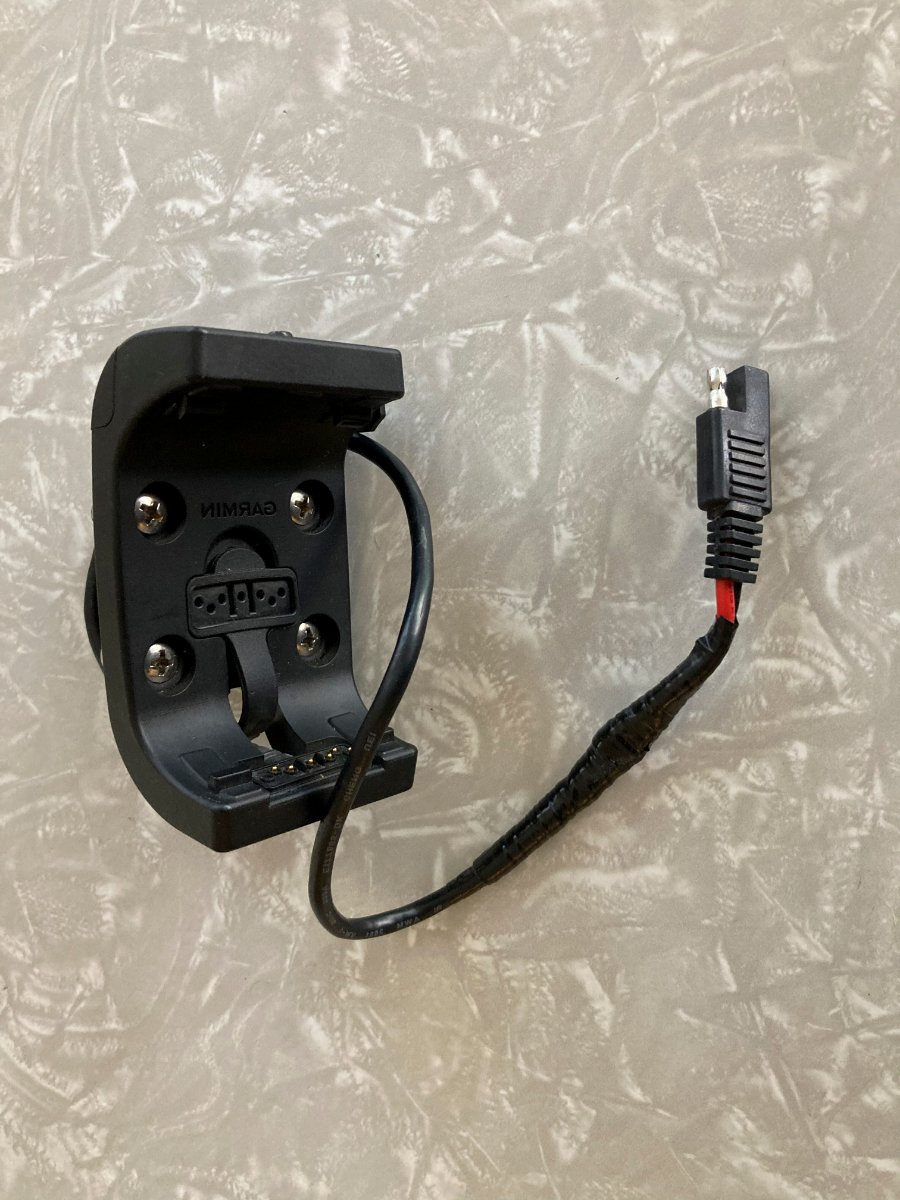

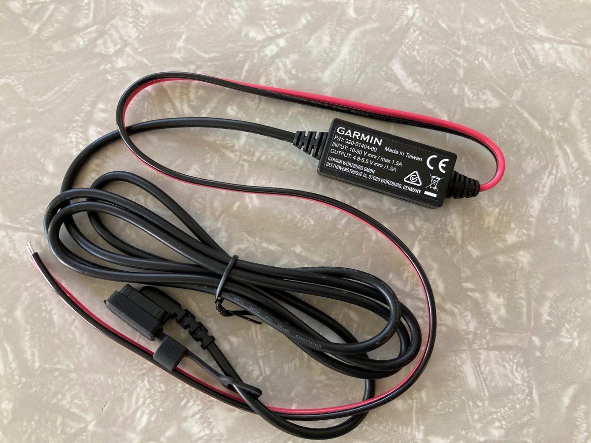

Hello...is the little plastic box on the power supply of the zumo xt anything more than a collector of the power and ground wire? I'd like to shorten it way up so that the mount becomes easily removable like I did with my Montana mount. Using the same SAE trickle charger connection up by the handle bars and a ram mount I can remove the whole thing and transfer between bikes. Just want to make sure I'm not cutting a suppressor or something that's vital. Thanks!

The black box is a converter it converts 12v to 5v
The lead from that to the connector is NOT just two wires I believe its coax cable so not easy to put a connector on it

What are people doing for a quick removal of the mount for these? The montana had several wires that were more for plugging in audio etc...5 wires maybe...just connected the red/black and it works great. The zumo xt is starting to look like a return with all the extra steps to use it...not showing up on a mac desktop like all the garmins I've had prior. The mount stuck on the bike all the time is a deal breaker. Need an easy off solution.
Re: Power Supply Wiring
The Zumo mounts are is designed to be permanently fixed on the bike, and the wiring is direct to the battery using the lead with the built in 12v to 5v convertor.
The only ways that I can think of to make the mount easily detachable are:
* permanently mount the harness and put in an exposed waterproof connector in the 5v side
* is bundle the wires neatly onto the mount and have a handy 12v connector close to the mount.
Dont be tempted to use the Usb connector for power. The car mount uses this, but the vibrations on a bike will likely damage it - not to mention leaving the connector open to the elements.
