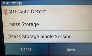

To check the transfer settings on the Zumo.
Map->Speed indication (bottom lef)->Hold circular speed button for 10 secs until screen changes.
Find configuration and settings -> MTP settings. Choose MTP for media transfer ( gives device name), or Mass Storage - which gives drive letters.

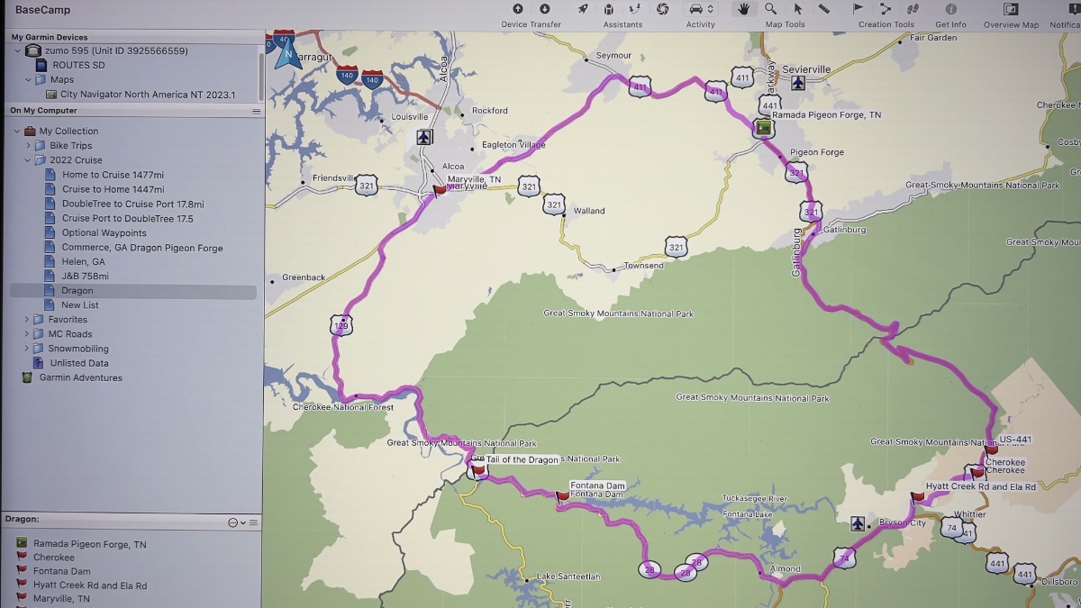

Thank You David, I will keep trying along with keeping an eye on Garmin to see if they make any progress in future updates. My only workaround for now will be creating maps in BaseCamp and downloading the GPX files to my SD card for the Zumo. You along with others here on the forum have been great in trying to get me up and going. I'll report back if/once I get up and going..... Appreciate it. RayBluenoser2 wrote: Sat Apr 16, 2022 4:59 amGlad to help, or at least try to, anytime. I would keep trying the AFT with it and using different combos of connecting it with the Zumo on or Zumo off. That was the first step for me to know that a connection was possible. Also try to connect Basecamp as I remember it connecting to that software and not Express. If I think of anything else, I'll let you know. Best Regards, DavidPaulaRay wrote: Fri Apr 15, 2022 7:40 pmTried the MTP Settings earlier on and just now with my new data cord that arrived today..... No Luck. The micro USB tab looks fine with the exception of Garmins sloppy metal work around the tab on all of these units when new. I only have three settings to choose from in which I tried them all (see below). I would say that Garmin needs to update their software for these new M1 Mac's. Worked OK on my Intel based 2016 MacBook Pro. Now the new processor is Apple Silicon which could be the problem. After using Garmin for over 20 years and knowing how there software engineers and updates are, I would have to say I'm S.O.L. for quite a while."IF I'm lucky enough" to get this going, I will definitely report back here with the resolution. Anyway, I do sincerely appreciate all the help and time that you have given me.Bluenoser2 wrote: Fri Apr 15, 2022 2:28 am

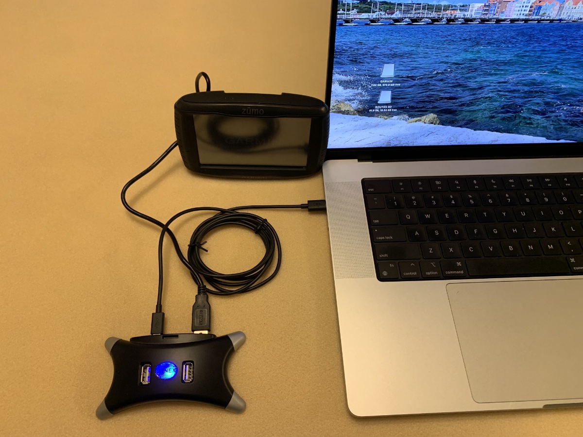

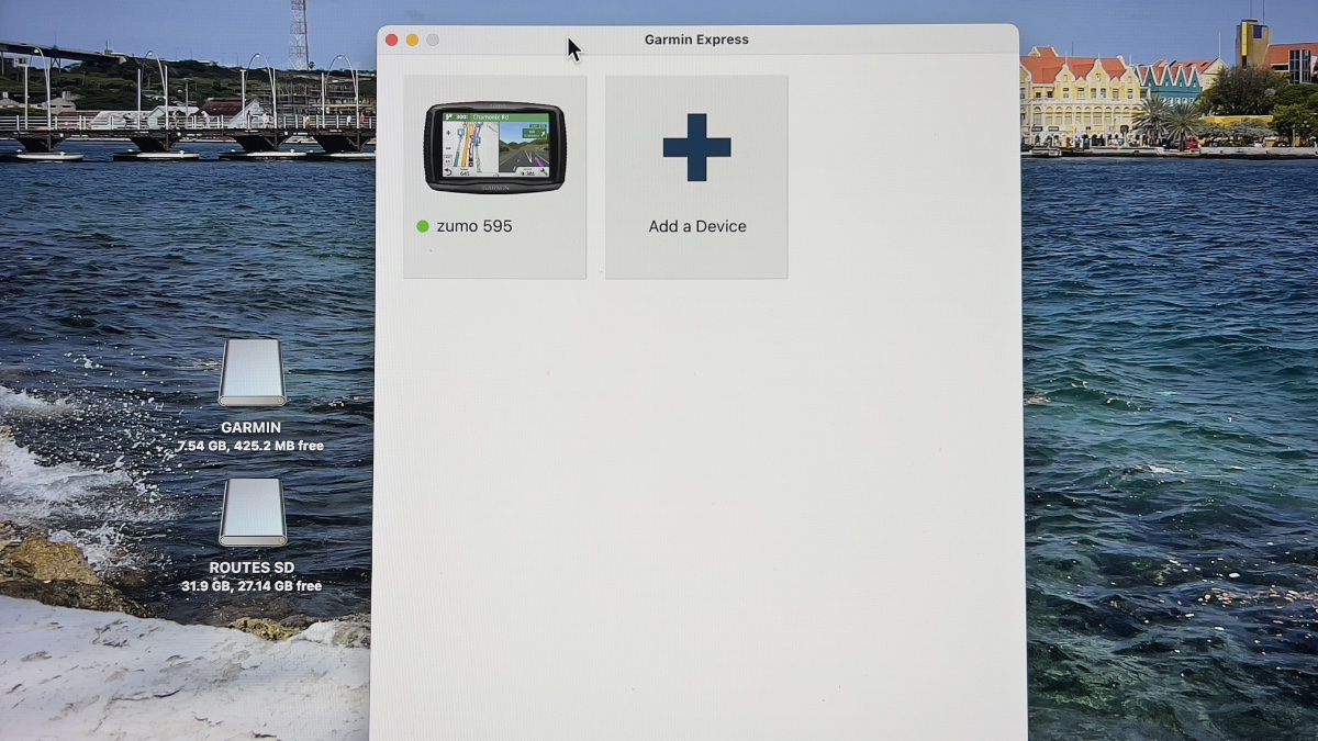

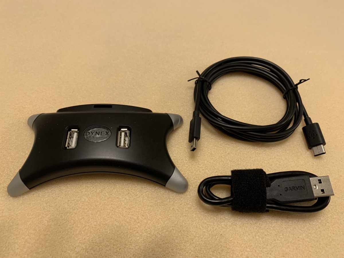

SOLVED!! First, a huge THANK YOU to everyone here for all your time in helping me get this resolved!

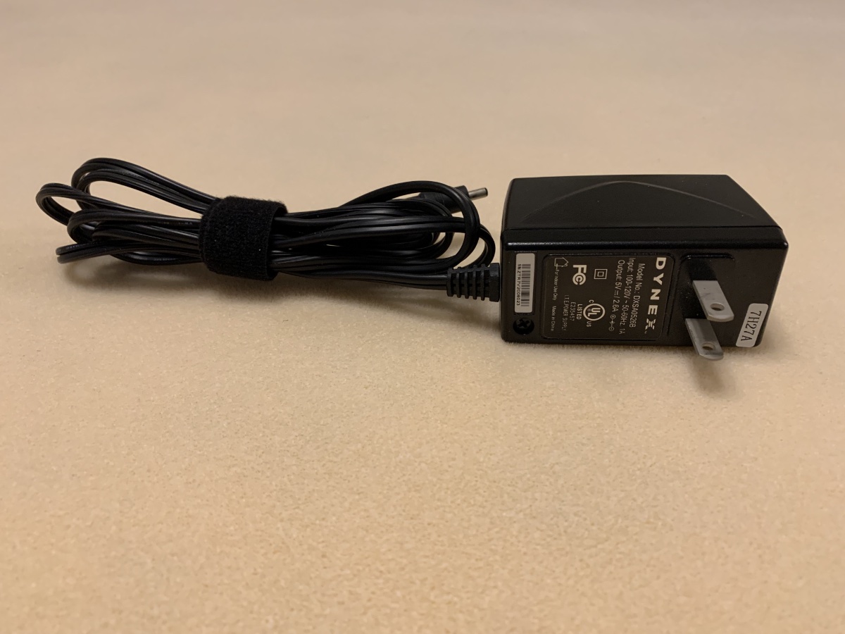

My son-in-law gave me the following Dynex USB 2.0 hub along with the power adapter. This along with a USB-C to Mini-B Belkin cord and the oem Garmin cord did the trick. I did tests with the power adapter with and without it which worked either way. I'll probably just use the power from the MacBook Pro M1 making it one less cord to plug in.
This particular hub has been discontinued but, there are a few of these on eBay (link below) with one being new. I would say any 2.0 hub will do the trick just as long as it has 480Mbps for data.
I'm extremely happy with this getting me up and going but, I still feel the same about Garmin. They really need to get their act together and catch up with today's technology when it comes to Mac's. Even the newer units for example; Zumo XT and GarminDrive units as listed here are giving people fits;

Although not on that list, my 595LM is and has been checked on MTP Auto Detect since day one. I did try the others with all three not being recognized during tests "without" this old 2.0 USB hub.

Although not on that list, my 595LM is and has been checked on MTP Auto Detect sine day one. I did try the others with all three not being recognized during tests "without" this old 2.0 USB hub.
