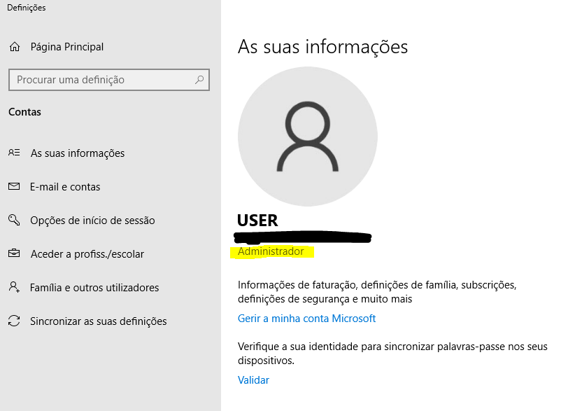

My PC only has this account "User" and it is already at Admin level:
Yellow highlight: Admin level of "User" account
Garmin support already sent me an .gma file by email but that didn't work too.
@FrankB , do you think this JavaWa method will work differently?
My hard drive has enough free space and also tried on my son's PC and run into exactly the same issues: map locked on Basecamp
My PC has Windows 10 Pro but his has Windows 10 Home
Thanks for the help.
