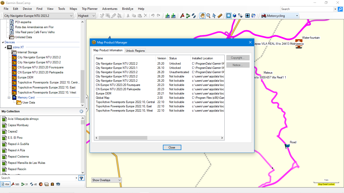

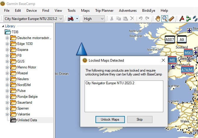

Opening Basecamp, the map was there but said it was locked.
Locked map message everytime I open Basecamp

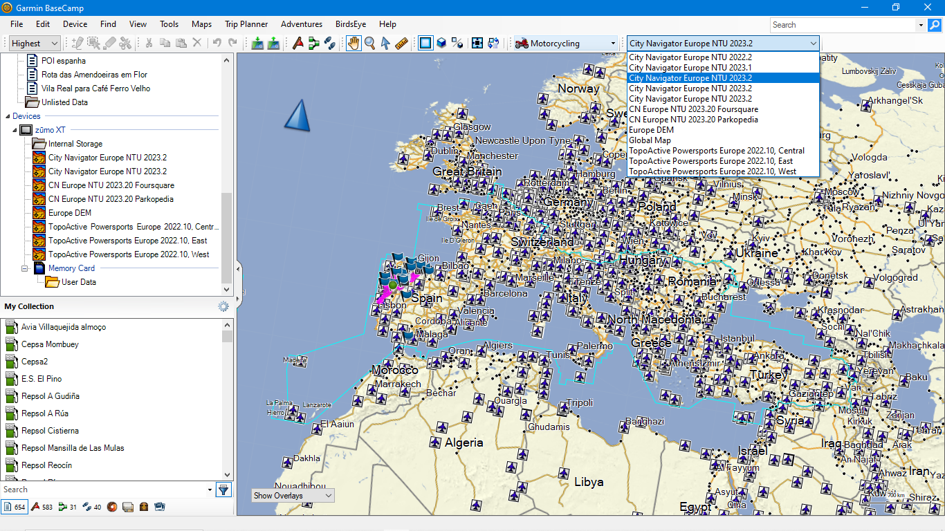

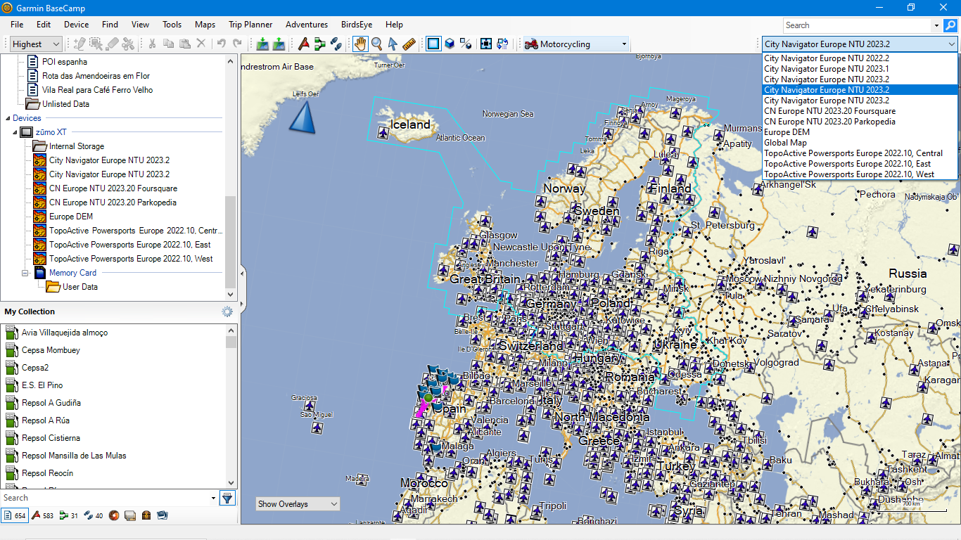

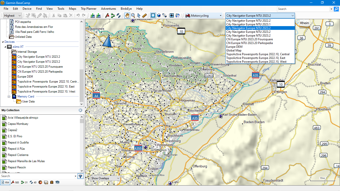

With Zumo XT connected it shows the map divided in two zones, North and South divided by a blue line. I guess this is normal because of file size limit on FAT32. Limit is 4 Gb so it's divided in two 4 Gb files (North and South)
Using 23.20 map from Zumo XT: a blue line surrounds the Europe North. Inside blue line the map is detailed, outside it lacks detail, only shows main roads, like the Global Map
Zoomed area of the same map in Zumo XT to show the different detail between South Europe and North Europe in French/German border
Selection of the other 23.20 map in Zumo XT shows a blue line around Southern Europe and the opposite happens regarding map detail to the Northern portion of the map
Selected 23.20 map installed on PC with no blue line around any Europe zone but message "Map detail locked" message on the bottom right corner.
Contacted Garmin Support and after two weeks of suggestions it still doesn't work. Tried opening GE and BC as administrator, they gave me an unlock code that changed the map status from "locked" to "unauthenticated" wich in fact is the same thing, uninstalled BC and reinstalled it to no avail...
Map management after introducing unlock code supplied by Garmin Support. Map status changed from "locked" to "unauthenticated"

I can fully use BC with the 23.20 map if the Zumo XT is connected to the PC but it is so slow and since it is separated in North and South zones it's not possible to plan a route that crosses one zone to the other because BC only uses one map at a time.

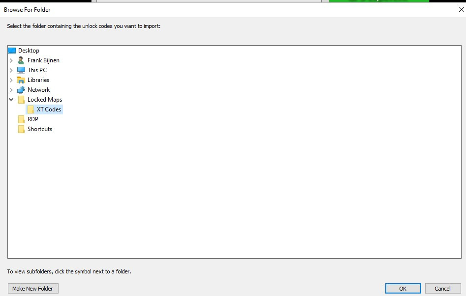

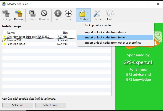

But to solve this issue you could also try JaVaWa GMTK. https://www.javawa.nl/gmtk_en.html
Step 1) find the GMA files on your ZUMO XT. On mine they are in 'This PC\zūmo XT\Internal Storage\.System\Map' (You will have to make the .System folder visible in the developer menu. More info: app.php/ZXT-P84)
Step 2) copy them to you hard drive
Step 3) Use JaVaWa GMTK to import the GMA files. (Import unlock codes from folder)
Note: JaVaWa GMTK cannot import directly from the XT because it uses MTP
Good Luck

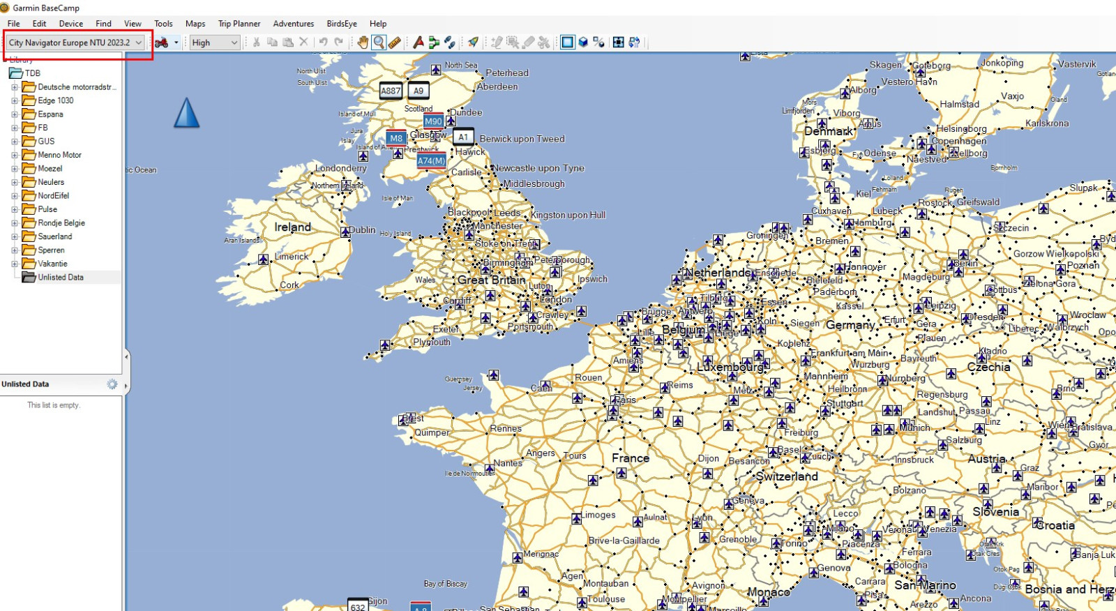

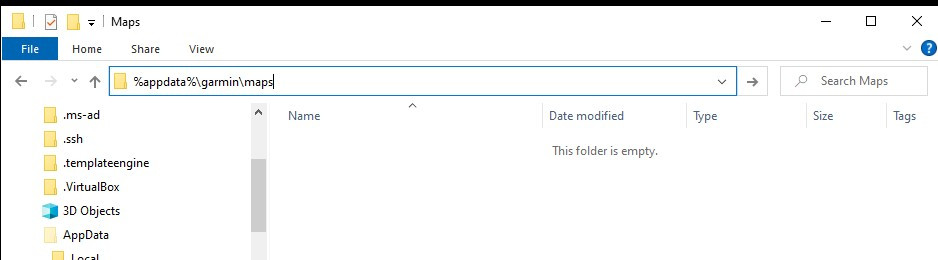

For my own piece of mind I did the following test.

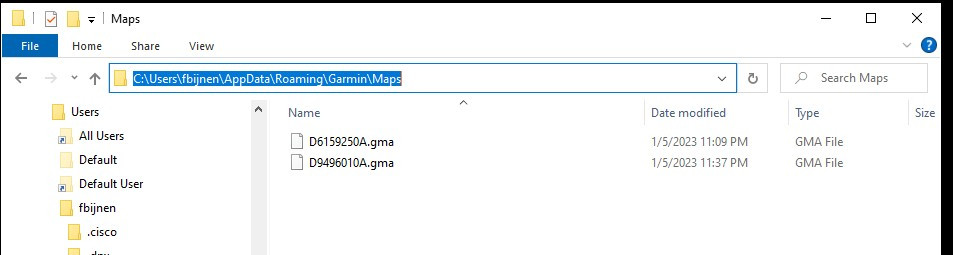

1) Removed ALL codes from my laptop. These are stored in %appdata%\garmin\maps, Just type it in the address bar of windows Explorer. But you can also search for all *.gma files on your hard drive using Windows Explorer.
2) Checked Basecamp. It said that the map was locked.
3) Closed Basecamp.
Did what I posted earlier:
4) Copy the GMA files from the XT to the hard drive.
5) Import it with JaVaWa GMTK
6) Checked the folder from step 1. It now contained the GMA files
7) Started Basecamp and the Map was unlocked.
I don't recommend that you do the same thing, unless you feel you are confident to do this. Especially step 1. This is another way of saying I'm not responsible.
I would recommend to follow Garmin Support directions.

My folder is like this:
Highlighted is the .gma file sent by Garmin Support to me
The other two I guess are for 2022.2 and 2023.1 maps...
Posts: 984
Re: Europe NTU 2023.20 map locked on Basecamp
Yes that's the folder.
I do not see the Codes from the XT. I Checked with 2 XT's. My own XT and the one from my son. The files from the XT's are named like:
D6159250A.gma
D9496010B.gma
and dont have those long names...
I would prefer to unlock with the files from the XT.
