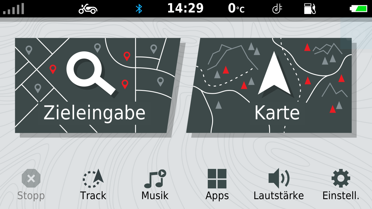

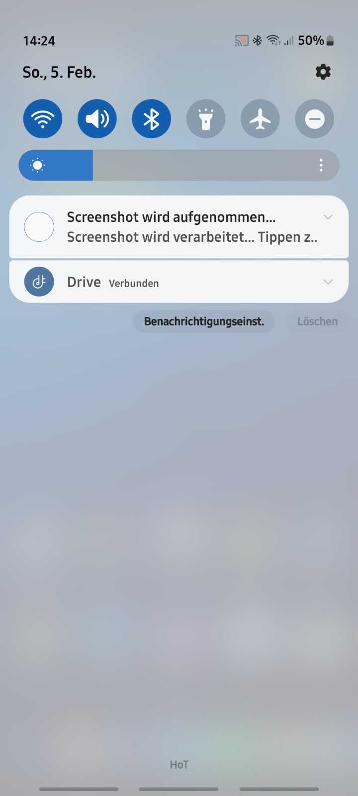

There is no 'Drive' app on the Zumo XT - what @jfheath means is, that the Garmin 'Drive' app on the Smartphone is always active, you can't disable it!
Normally it's running 'invisible' in the background - if it's connected to the Zumo XT, you should see a 'd' logo in the status bar of the Zumo XT and also a 'd' logo in the notification area of your smartphone - at least on an Android phone...
For example:
For example:
Bye, Robert

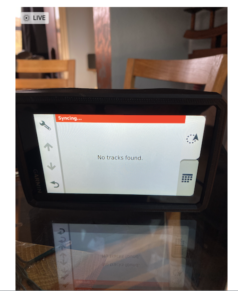

I then go through the killing of explore but this time before I power up the XT, I disable bluetooth and wifi on my ipad.
power up, check explore it is not activated, screen with blue buttons, click cancel
check apps>tracks all the tracks have disappeared but the routes are still in apps>trip planner. screen shot below
![Image]()
I then enable bluetooth and wifi on my iPad and sit and watch the tracks screen on my XT after 30-45 seconds it starts to sync without any intervention from me.
![Image]()
