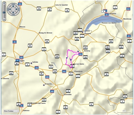

Relief shading on hills.
I can't have been paying attention when I spotted this, because it wasn't showin it this morning. And my searches were crashing Basecamp again.
I'll send you my GPX file that imported perfectly. See if it loads on yours. PM
Anyway I investigated. Discovered two things - both of which I knew about from years back, and remembered a third.
1. My XT was plugged in to the computer when I got the relief shading. I didn't think so, but I must have had the Europe DEM map selected - unless it loaded it in the background. Edit Ah - it displays with shading if the Zumo version of the 2022.3 map is accessed. I don't know if there is a way of getting the DEM map onto the computer.

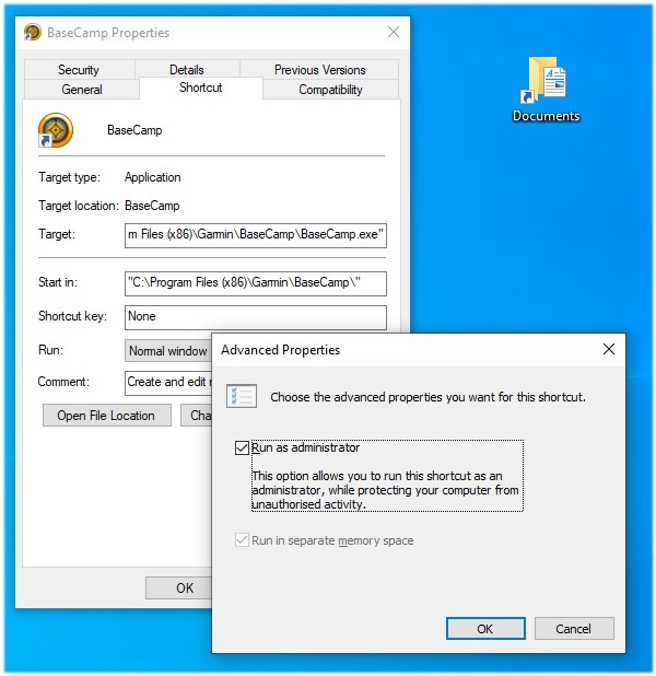

2. For certain things to work in BAsecamp, you have to run it as administrator. I've always had a shortcut on my desktop, set up like that.
Find the EXE file for Basecamp, create a shortcut, put it on the desktop, Tick the run as administrator box.
Having just deleted everything and reinstalled it, it started crashing during searches. As soon as I ran it as an admin, it worked perfectly.
Run As Admin.jpg (64.6 KiB) Viewed 3146 times

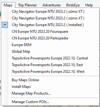

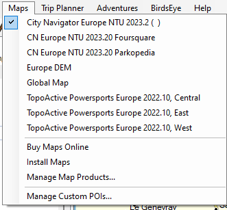

Now, something new. I am surprised to find a map menu different from the one I had before (GPS connected)
maps menu.png (17.97 KiB) Viewed 3128 times
When before the Maps menu was looking like this (GPS connected):
maps menu before.png (15.52 KiB) Viewed 3128 times
Strange... How is your Maps menu looking when your GPS is connected ?

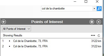

Like you I have been testing the crashes when searching.What I have found that makes NO difference:
- Reverting back to old (legacy) Basecamp version. Instead of crashing it used a lot of CPU.
- Reinstalling, cleaning up all left-overs like tile cache etc.
- I even freshly installed Windows in Virtualbox.
- Running as admin.
- Connecting the XT, and using that map.
- Using the OSM map.

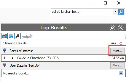

Two (2) things that seem to make a difference, at least in my tests.
- The level of zooming. If I zoom out the map completely, so that Europe is completely visible it does not crash.
- If you first click on the 'More' button it does not crash.
From here it crashes:
From here it does not crash:
no crash.jpg (21.76 KiB) Viewed 3118 times

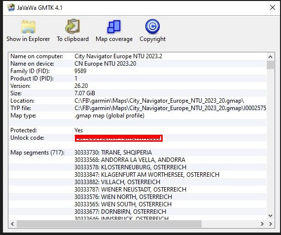

And to get back on the original subject, why it is recalculating so long on import. 2 Via points that you @jfheath identified earlier
- 0040 Chanaz
- 0096 Col de la Chambotte
have a subclass field with a mapsegment number that is not part of City Navigator
<gpxx:Subclass>1461 38 4F E5 08 1280EE061200000000000000</gpxx:Subclass>
Mapsegment nbr:
08 E5 4F 38 => 149245752 ??????
For example Via point 'Route du Pont Neuf' has a Subclass with a mapsegment number that can be found in CN 2023.2
<gpxx:Subclass>0000 F9 DA CE 01 6E20FE060F20040095800F19</gpxx:Subclass>
Mapsegment nbr:
01 CE DA F9 => 30333689: CHAMBERY, FRANCE (not visible in screenshot JaVaWa GMTK...)
The 3rd waypoint '0000 Nonglard Route de Chez Dupraz' that you mention John, was used as the start and already had the special value '00ff'. I'm not so sure that that is causing a problem.
If a GPX is loaded with an unknown mapsegment number i'm not surprised that the XT starts to recalculate. The special value '00ff' seems alright, that's what @chris7444 confirmed.
Now for me the question that remains is, how did the invalid mapsegment numbers get there? It could very well be the result of the Basecamp crashes. Who knows?
Map segment numbers can be found with Javawa GMTK
