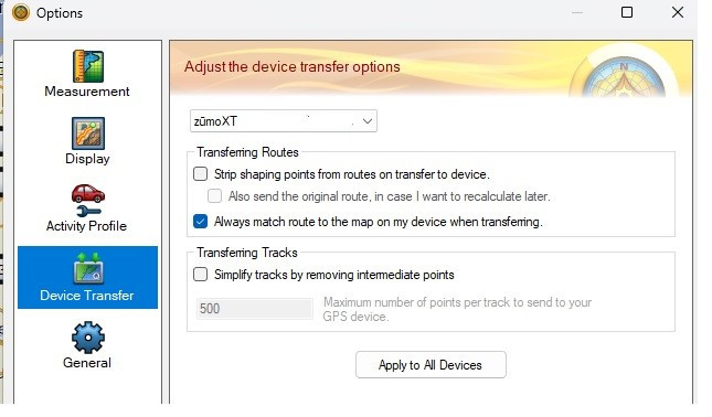

Ive just ticked this box on my system, Always match the route to the map on my XT. Previously it was unticked, and I've suffered from the U-turn problem. I'm not certain what it does, or if it will have any affect on the U-turn issue. does anyone understand what this check box does ?
It tells your Zumo XT, that it should re-calculate every route that you transfer from Basecamp to the Zumo XT to be sure, that it matches the maps on the Zumo XT - and is a really bad idea to tick it!
Normally it's first rule of all, to have always the same maps in Basecamp and on the Zumo XT! And as normally its really not wanted, that the Zumo XT does a recalculation of a planned route (as the result could(!) maybe differ), best option is, that no one(!) of the checkboxes on this page is ticked!

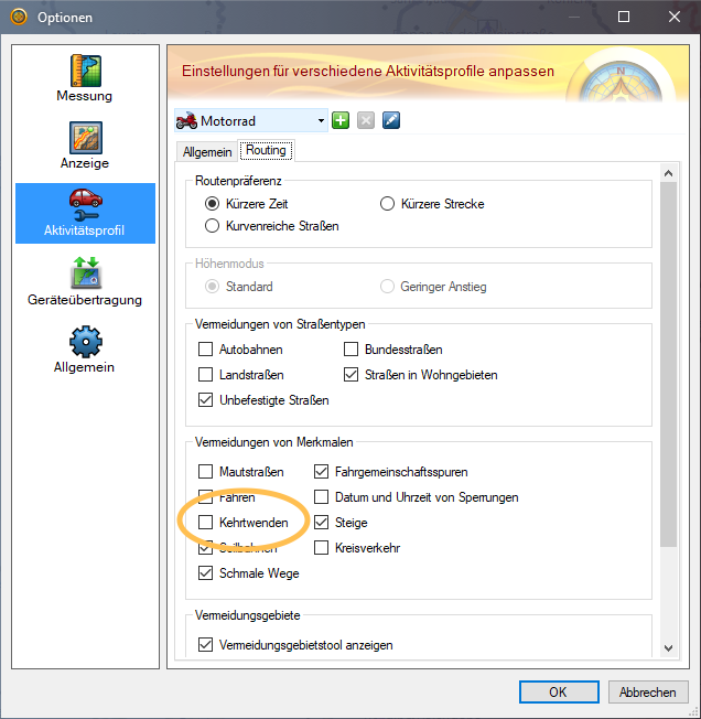

The U-turn-issue is a setting on another page of the options - it's 'Activity Profile', choose your used profile (e.g. Motorbike), 'Routing' and on this page 'Avoidance of features' (or so, sorry i'm speaking german!) and there 'U-turns' - this should be unticked(!)

Thank you Robert. I now understand this. My main issue is that if you go off route, the XT recalulates anyway, and can change the original route, or worse, go into this u-turn loop, which I've seen trying to get off the A2 heading north into Switzerland to avoid the San Gottard Tunnel. I always put via points in my route to force the XT to take me on the roads I want to, not where it wants to. I change profiles on basecamp to check the route is the same in different profiles to ensure nothing changes. I am now wondering if forcing a recalulation on uploading the route might stop the strange behaviour some have seen when going off an active route and the subsequent recalulation ?
Keep all of those check boxes unticked. And when you have done that, make sure that you click 'Apply to All Devices' - unless you only every plug in the same device. But one day, that may well catch you out ! It retains your settings for each unique device that you ever plug in.

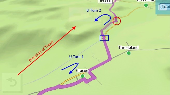

So just because you are getting repeated U turn demands, doesn't indicate that you are in the RUT that I have been talking about.
The Repeated U Turn RUT loop is when the XT stops trying to get you to the next route point, and instead starts to get you back to the closest point on the route. And because it is plotting a new bit of route behind you each time you ignore a U turn request, that is now the closest point on the route. It is laying a breadcrumb trail.
You can see it doing this if you do not allow it to perform a U turn. Instead it will try other tactics to get you to head back the other way - using side road loops. So it will continue ahead to a road junction where it has spotted a road that will take you back in the opposite direction to rejoin the road that you have just travelled somewhere behind you. It never seems to take a road that will continue in the same direction of travel and then turn back. And that is how it reveals what it is doing.
So the above is an example. I have been traveling in the direction of the red arrow and I have stopped somewhere off the top of the screen. The blue arrows indicate two locations where the XT has wanted me to head back south west, and where I have ignored it. The XT is demanding that I go back about 5 miles to a roundabout where I left the original route. So I have stopped to zoom into the route that it has plotted. The magenta line shows the route heading to the bottom left hand corner from my current position at the top of the map.
So I am heading NE, the XT is trying to get me to go SW and I have been ignoring it .
I travelled along the yellow B6265 and ignored two demands to turn off the yellow road and head back in the opposite direction. From where I am, the direct line back to the roundabout is to follow the yellow B6265. But the plotted route isn't doing that. It is taking me back to the route that it plotted, and that now inlcudes the roads that it tried to use to get me to turn back at U turn 1 and U turn 2.
I can only think of one reason that it would do this. Look near Cracoe. I was heading up the yellow road. IT wanted me to turn right and follow that rectangular trip literally around the houses, to get back to the road heading SW, without performing a U turn. So I was on the route up until the 'e' in Cracoe, where the XT wanted me to turn right. That is the point of deviation. The route back from that point is from the letter e in Cracoe, under the green disc and SW after rejoining the main road. That is its route from that point. The red circle is now the last point where I deviated from its route.
But I continue. and it finds another place to turn me back. It could ask me to turn left at the blue rectangle. It doesn't. It plots the route along the yellow main road to the red circle, asks me to turn left, and back southish to rejoin the main road at the blue rectangle.
So now sitting at the side of the road at the top of the screen I am looking back at the route that it has plotted to take me back. It has me heading down the B6265 to the red circle. This is where I deviated last fromt he plotted route. It hasn't even bothered to calculate a route down the main road - it has tagged the route onto the point where I last deviated, and is taking me down the side road of the return loop. The same when I get to Cracoe. The obvious route to the roundabout 5 miles off the bottom of the screen, is to use the B6265. Instead it has used the rutrun loop that it previously calculated.
It is only calculating a route to the last point of deviation, and using the route that it had already calculated before then. And there is never any way that it will do anything different. It has no intention of getting me to the next route point. Except it seems when I get less than a mile from the original route. Then it gives up.
And so far, the thing that seems to trigger this is the forced recalaculation of an imported route. Not just Basecamp, it does it with MRA routes too.
But not if you build the route on the XT.
