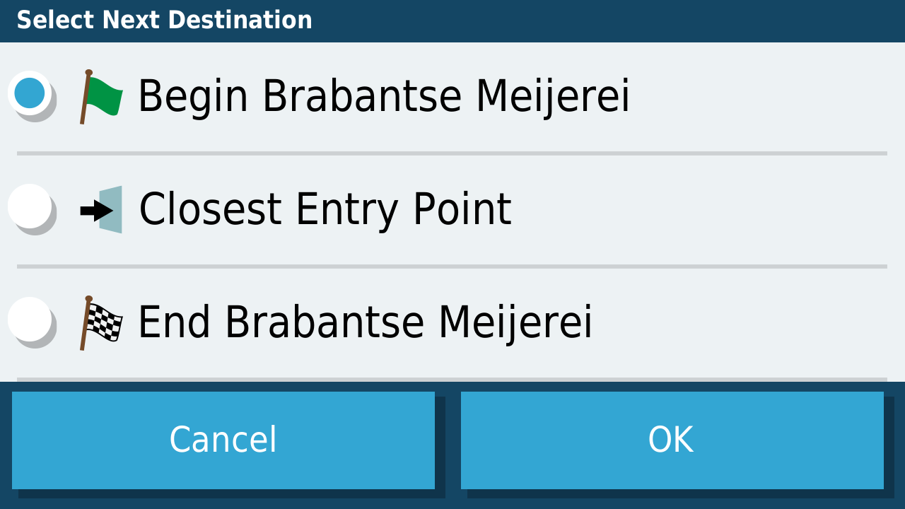

How I start the route/trip:

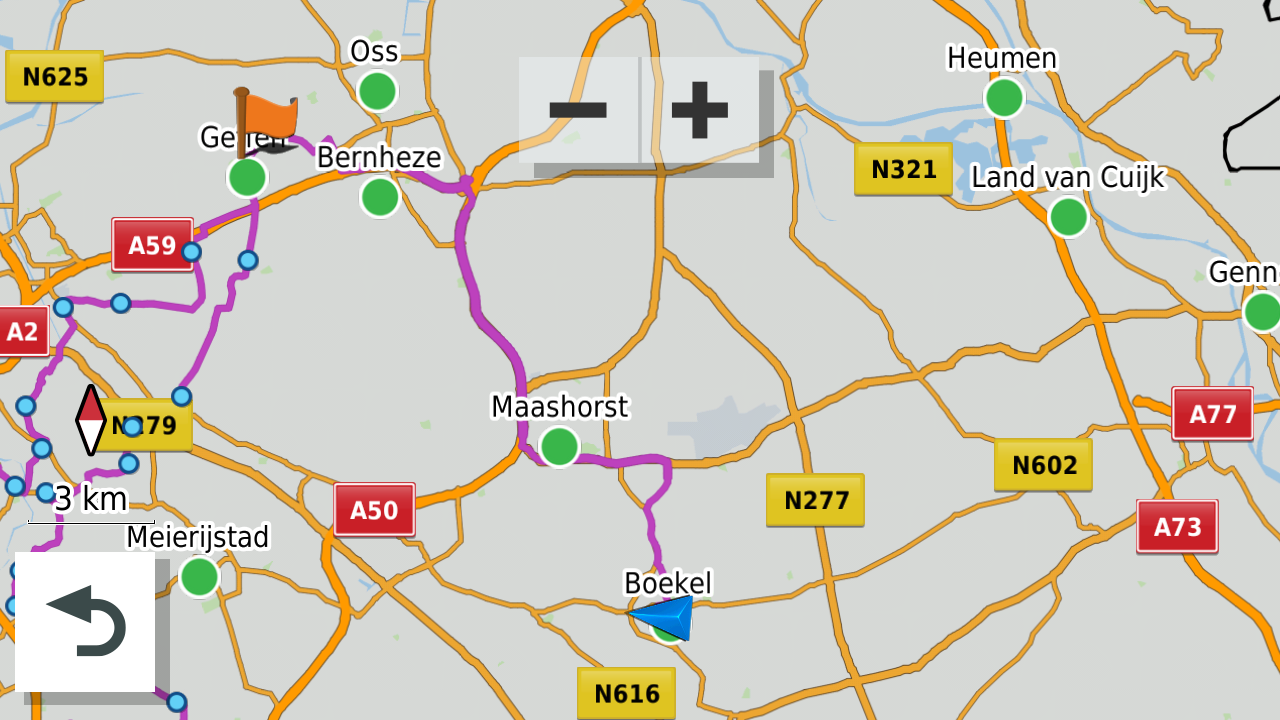

The route calculated by the XT from the current position to the Red Flag. (approx 25 Km)

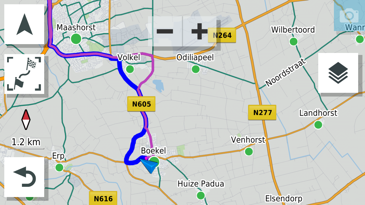

The blue line is the track I actually drove. Deviated twice
