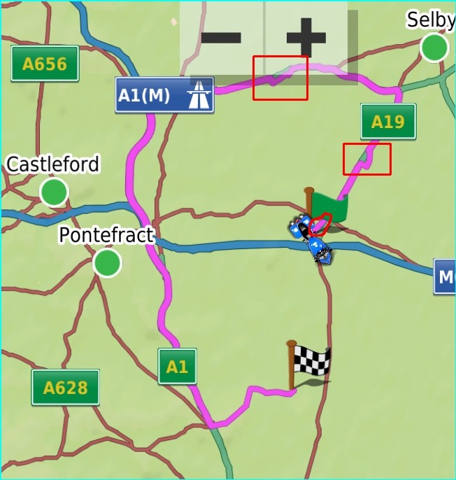

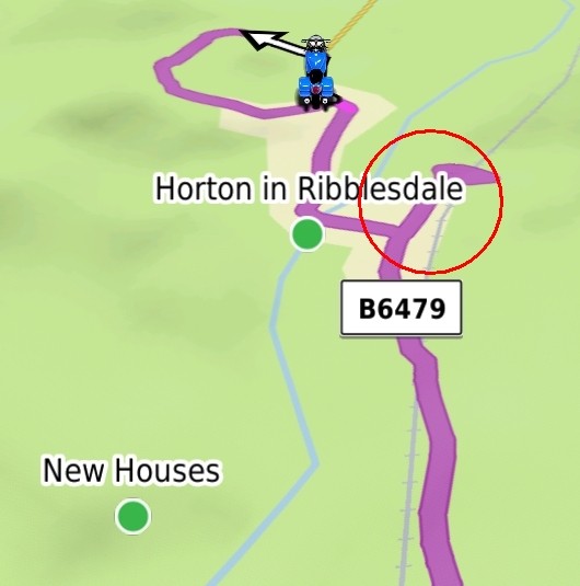

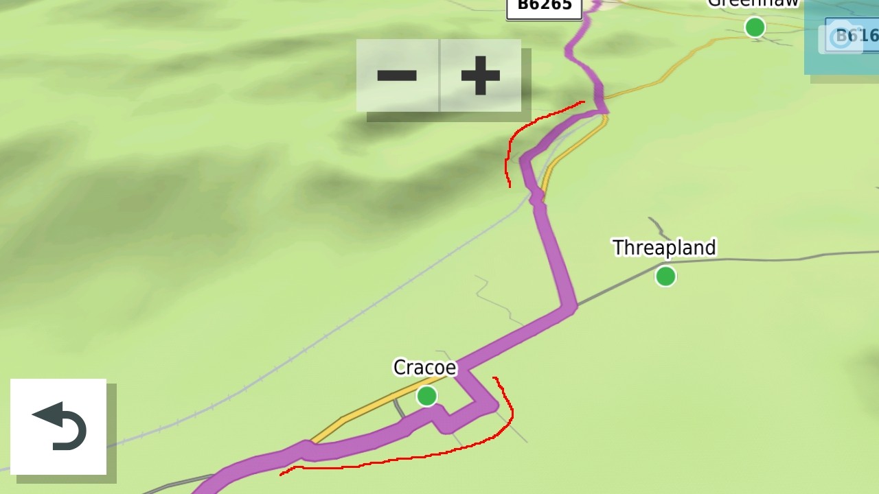

    This detour off the main road is very visible on the preview map, and they become part of the route back. And I think that this is definitive evidence that the XT is no longer attempting to take you to the next route point. Attached are three examples of this behaviour. Click the image for a better view.
    The route back includes all of the places where it plotted a way for me to turn round. If it was plotting a route to a particular point, it would not include those loops. The only conclusion that I can draw from this is that it isn't trying to get me back to a route point. It is trying to get me back to the last point where it told me to turn back. Repeatedly.
    On the map showing Cracoe, the motorcycle is off the top of the screen. The satnav is wanting me to head south. The marked locations are where it attempted to use side roads to loop me back - and they are still part of the route that it has plotted for me to go back.
RUT loop 1.jpg (81.47 KiB) Viewed 1750 times
RUT Loop 2.jpg (37.29 KiB) Viewed 1750 times
RUT Loop 3.jpg (82.35 KiB) Viewed 1750 times
