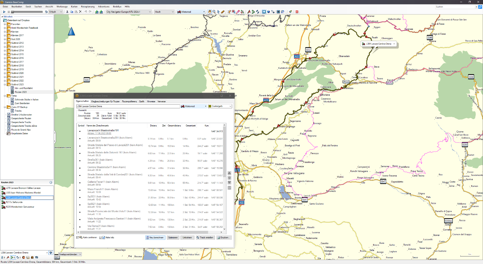

Hmmm - as far as i know, there is no switch for 'auto naming' in Basecamp!?
When you start to plan a route, the name is taken from the starting point to the finish point of the route - i normally double click the route in the left list and open the route information and there i change the routes name to what i like - but this also works, when i click on the name of the route in the left list and change it there!

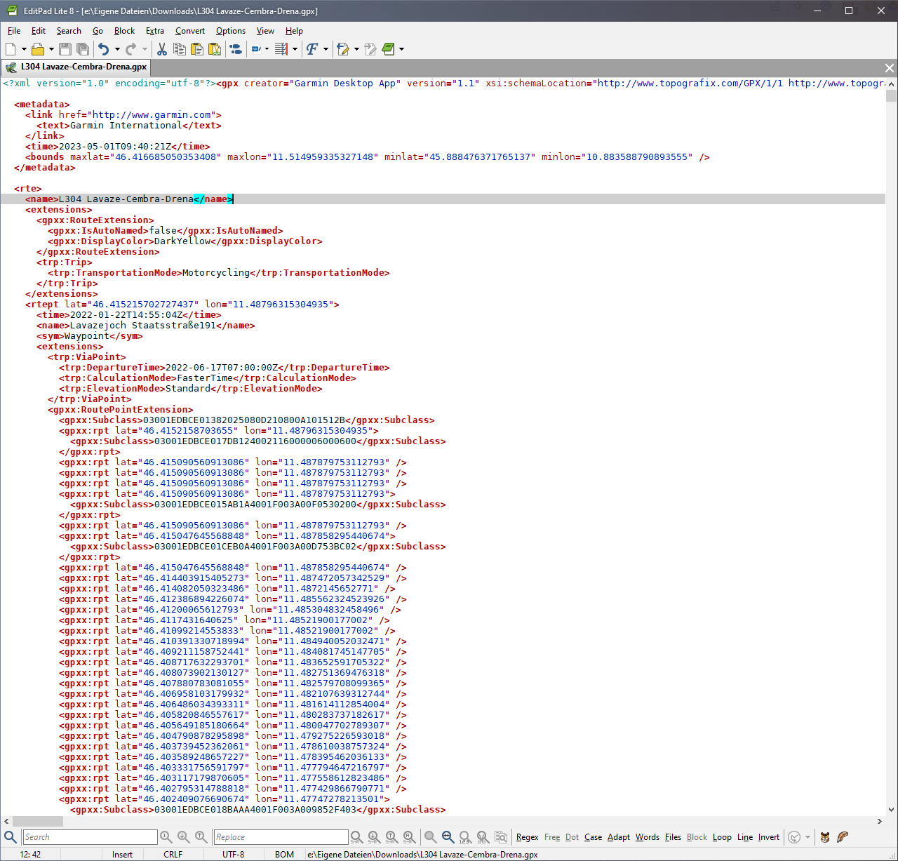

The name of the list is displayed on the Zumo XT just as i named it - also the GPX file contains 'my' name in the XML code - just tried it a few minutes ago - here are two screenshots...
Basecamp with open route information window:
Exported GPX file of the above shown route:
The XML code of the exported GPX file
2023-05-01 (1).png (228.52 KiB) Viewed 2672 times
As you can see, my given name is the same in Basecamp and in the exported file - and also this name is shown after importing this route in the Zumo XT...

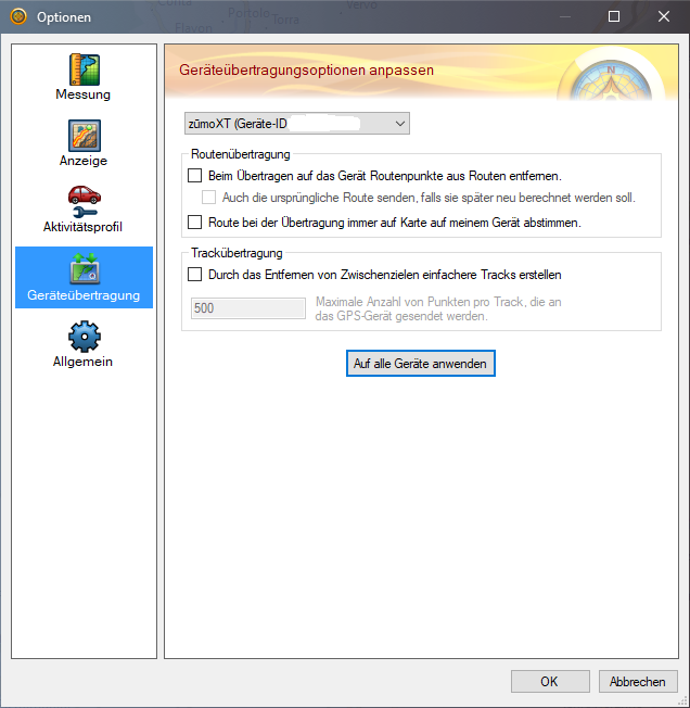

Did you, maybe, have in Basecamp any of the options in 'Device Transfer Options' in the settings ticked? They all should be unticked(!)...
2023-05-01 (2).png (82.03 KiB) Viewed 2672 times

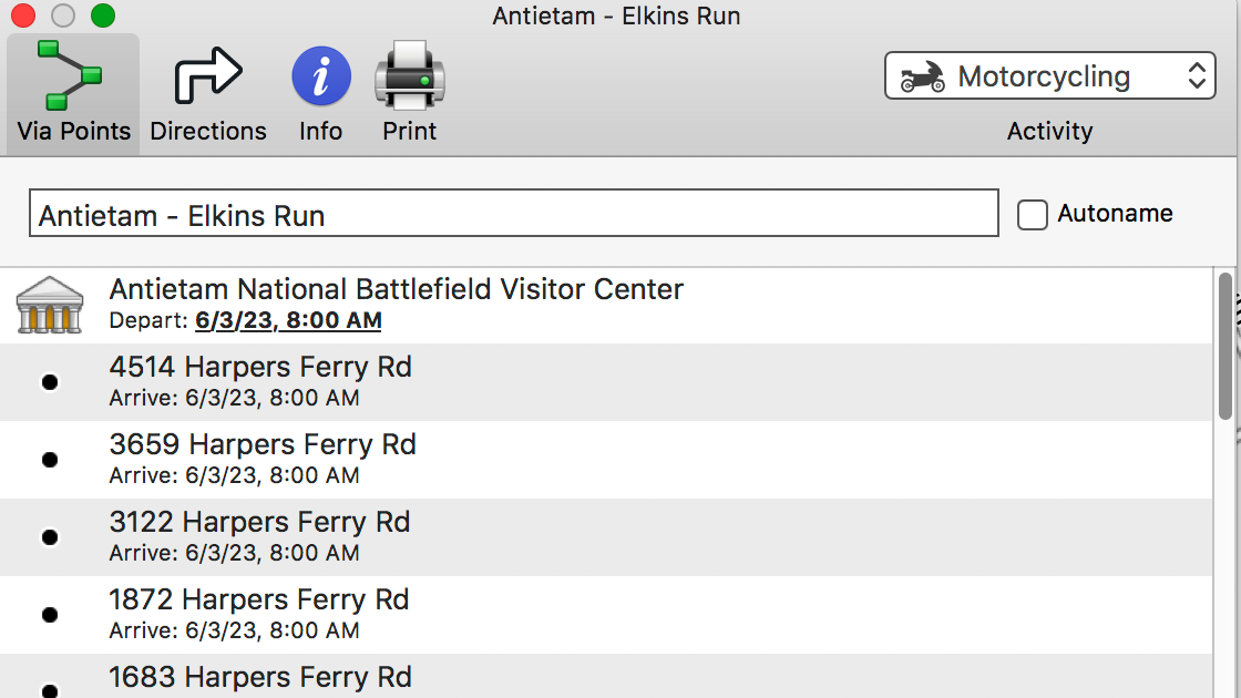

This may be a difference between Mac and Windows versions of BC? Here is Mac, with a check box for "Autoname."
Screen Shot 2023-05-01 at 6.55.29 AM.png (170.86 KiB) Viewed 2667 times

@Rofor - I'll check the "Device Transfer Options" tonight.
@Danham - Mine is a Windows 10 computer and there is no box shown for auto naming as you show. Looks totally different.
Thanks.

I checked the "Device Transfer Options" and the only box checked was the 2nd one that related to forcing the exported route to use the map on the device. I unchecked this box and changed the name from the lower left pane, exported the route to both of my Zumos and the name I changed it to did appear on the device when I booted up the Zumo.
So, although I don't see how this checkbox (checked or unchecked) would have anything do to with the name of the route, it did work and appears to have solved the problem; However, I guess now I will just have to make sure that the maps I use on Basecamp are the same as the maps in the Zumos. I wonder what issues this will create if they are not the same.
Thanks for the help.

@WilcoJunoHotel
WilcoJunoHotel wrote: Tue May 02, 2023 11:31 amSo, although I don't see how this checkbox (checked or unchecked) would have anything do to with the name of the route, it did work and appears to have solved the problem; However, I guess now I will just have to make sure that the maps I use on Basecamp are the same as the maps in the Zumos. I wonder what issues this will create if they are not the same.
The naming of this option is a bit misleading, as it don't check if the map used for planning and the map on the Zumo XT are the same - it signals the Zumo XT to ever do a recalculation of an imported route, even when the map on the Zumo XT and on Basecamp are the same!
