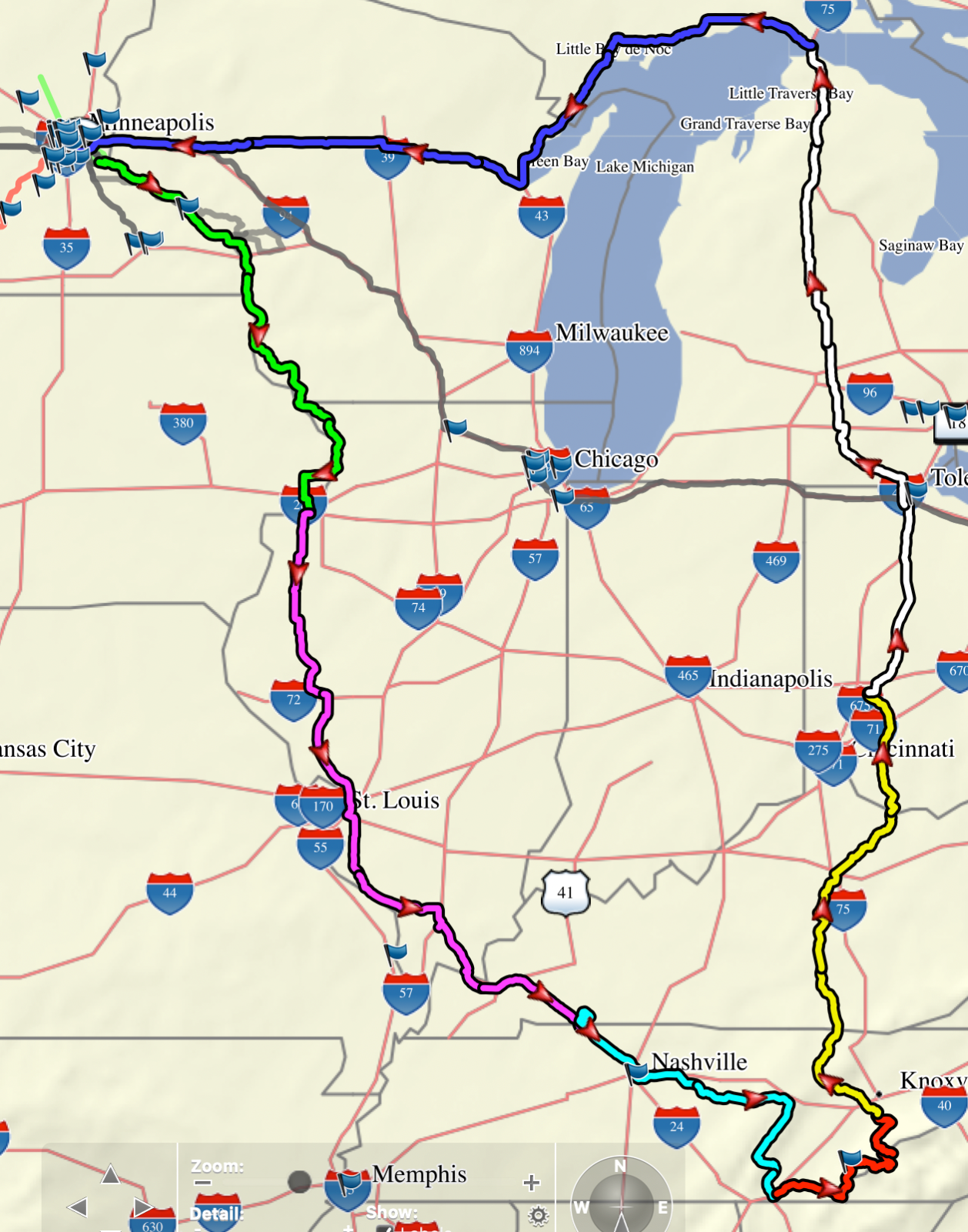

The past few years when I've taken long trips (5-7 days), I've had saved logs of the full ride from start to finish.
Pulling the tracks into basecamp, it was a relatively simple process to combine the multiple tracks from each day into a single track per day. It's kind of fun to display them all on the map to see my entire route! If I did it right, there's an example attached to this message...
