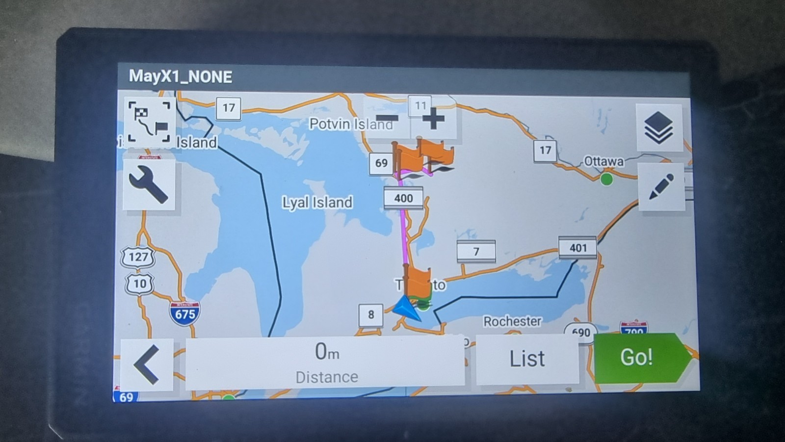

Some further experiments, because I (the user) should try to figure out the workarounds to use this $1000 CAD unit.
Went back into BaseCamp, set the route profile to NONE. This takes the route and assigns CUSTOM ROUTE OPTIONS
Screenshot 2023-07-18 102502.png (39.7 KiB) Viewed 2601 times
Scenario 1 - BaseCamp EXPORT .GPX to Tread App, import into Tread, Calculate, Sync to ZUMO XT2
Route 1
BaseCamp - Route says 333km 4h14m NEW 272km (not expecting this to be accurate as it is point to point)
Tread App - Route says 333km 3h39m NEW 333km 3h39m SAME
Zumo XT2 - Route says 333km 3h40 NEW 333km 3h40m SAME

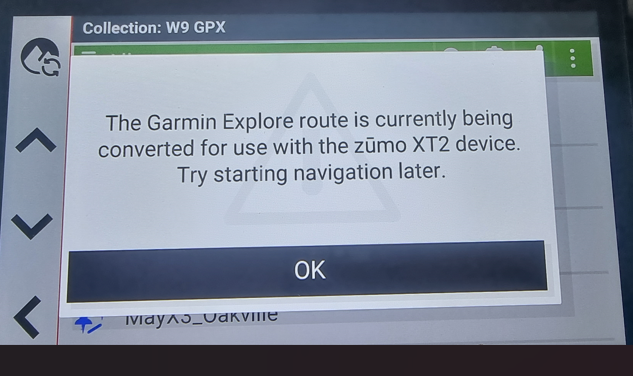

Scenario 2 - BaseCamp EXPORT to ZUMO XT2 via BaseCamp and import into unit bypassing Tread App
IT DOES NOT LIKE THIS AT ALL!!!!
I got this on my unit... pretty much a non-starter.
