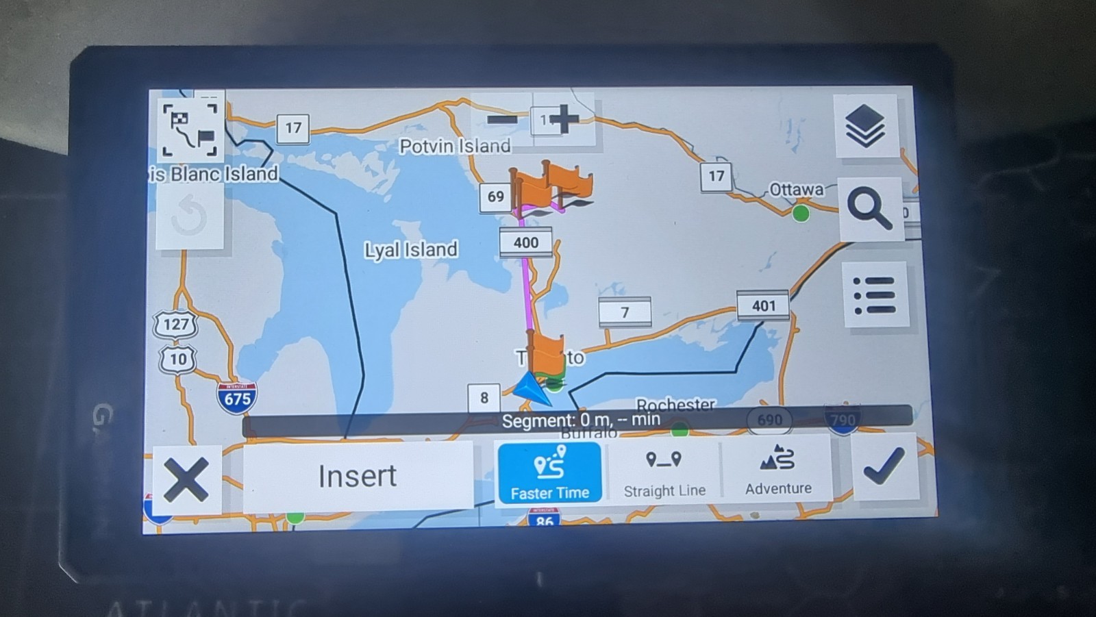

Wow! You have hit on many of the frustrations of Zumo XT owners. The Tread app adds a level of complexity that seems absurd.
Some tips when using preplanned routes:
1. In a route, never have the start and end points the same. You saw why. Make the start point some distance away from your physical starting point. For routes originating from my house I set the start point about 50 yards down the street from my house.
2. Only use Closest Entry Point when absolutely necessary. It requires that the device do some calculating which you don't want (more below).
3. With the XT, it is in charge when given the chance. That means that you want to do everything you can to prevent it from doing any calculating. Going off-route and then letting it recalculate will result in the entire remainder of the route being recalculated based on what the device thinks it should be. Skipping a point will always result in a recalc. That is an example of a situation where you can not avoid a recalc. Different devices produce different results when they recalc. I see this regularly with my XT and my riding buddy's Nav VI. It is hard to understand why you and your wife's devices calculated differently though if they where the same device, same map, configured identically, and using the same route file.
4. As mentioned, recalcs can cause havoc. In route planning, strategic placement of route points that will force calculation along the roads you want is paramount. I will always open downloaded GPX files in BaseCamp and add additional route points as appropriated to try force the device to maintain the route.
5. On the XT, you can have a track displayed on the map while you ride a preplanned route. Having on track of the current route displayed on the devices map makes it easy to spot a route change due to a recalc. You then have the choice of manually following the track or stopping/restarting the route. An unknown to me is whether the XT2 has this capability and if it does, how you get the track file on it if everything must flow through the Tread app. BTW, the track file is created in BaseCamp. The transfer to the device includes the route and its track.

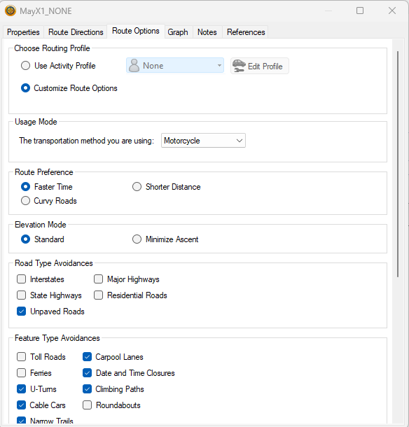

Some further experiments, because I (the user) should try to figure out the workarounds to use this $1000 CAD unit.
Went back into BaseCamp, set the route profile to NONE. This takes the route and assigns CUSTOM ROUTE OPTIONS Scenario 1 - BaseCamp EXPORT .GPX to Tread App, import into Tread, Calculate, Sync to ZUMO XT2

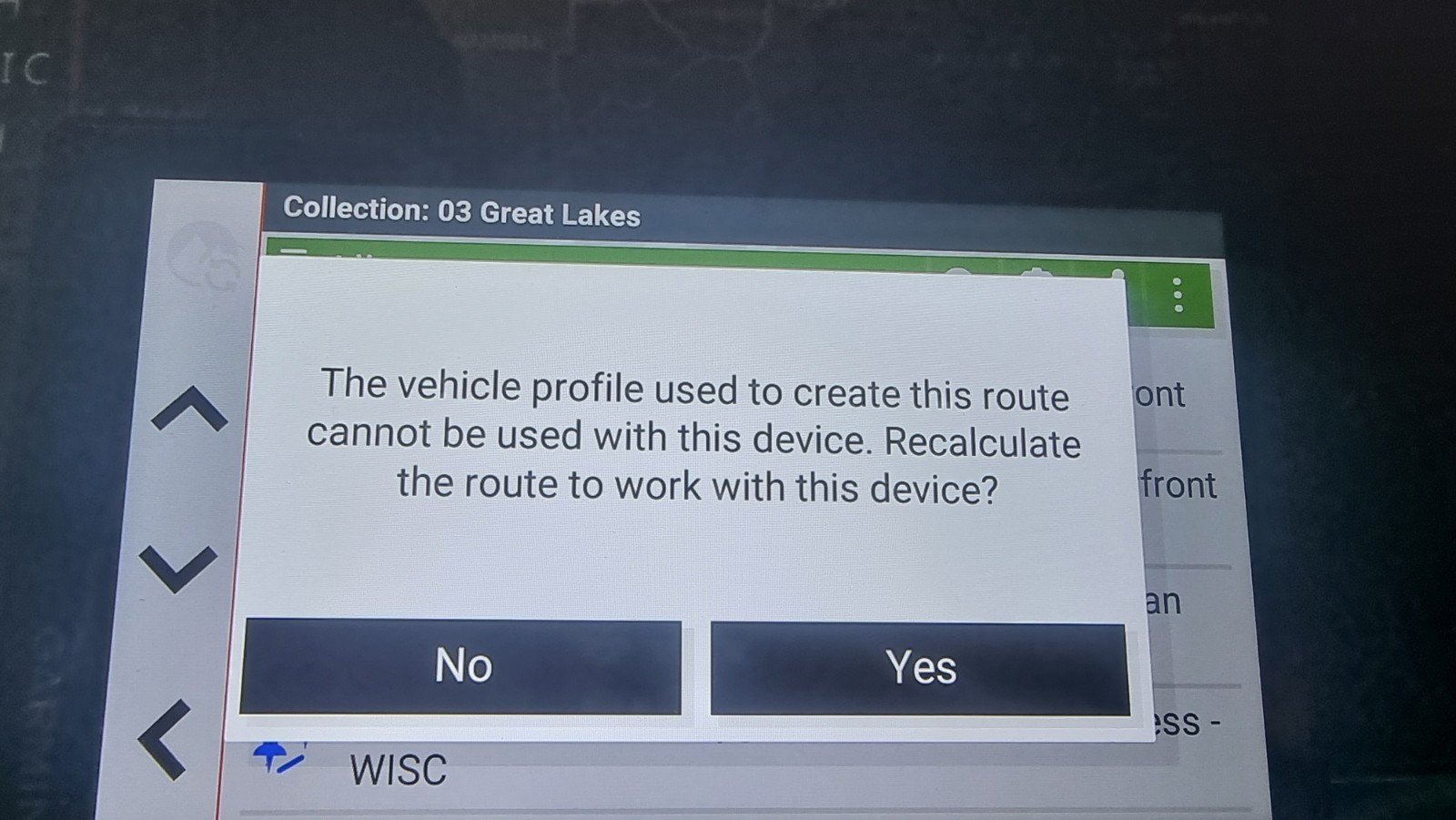

Scenario 2 - BaseCamp EXPORT to ZUMO XT2 via BaseCamp and import into unit bypassing Tread App
IT DOES NOT LIKE THIS AT ALL!!!!
I got this on my unit... pretty much a non-starter.

On the XT there is a button on the map that allows you to skip a point. You may have to turn it on. To do so, view the map, tap the three-dot button, then the spanner button (wrench). This will open the Map Buttons options screen. There are three positions where you can select a specific function button. Any "Plus" button is a location where you can add a function. You can change one by trashing it and then adding a different one in its place. The "Skip" option is the one that creates a button allowing you to skip the next point. Hopefully the XT2 has this same functionality.technoguppy wrote: ↑Tue Jul 18, 2023 3:09 pm There used to be a pop-up on the 595 and 660 "Skip this waypoint" when it tried to reroute you back to your route. Haven't seen that pop up on my the ZUMO XT2 yet.

Just a note about Basecamp profiles - mentioned a couple fo posts ago.
None of the information that you set about avoidances in the BC profile is transmitted to the XT. None of it.
The only information that is transmitted is :-
1) the activity profile name - Driving/Motorcycling - which convertes to Car / Motorcycle in the XT
2) Faster Time / Shorter Distance
3) Direct Profile - which sets the XT to use Straight Lines.
If any other profile name is used, (like Custom profile in Basecamp, or none from any other program) , then the XT defaults to using Motorcycle.
If any other routing preference is used (like Curvy Roads in Basecamp), the XT defaults to using Faster time.
It may then cause the route to recalculate and if you have any of the other options ticked, then the route may differ wildy fromt he one that was created by BC.
If you want to know more about this behaviour on the XT, then I did a fairly complete summary in this section and following pages here.
