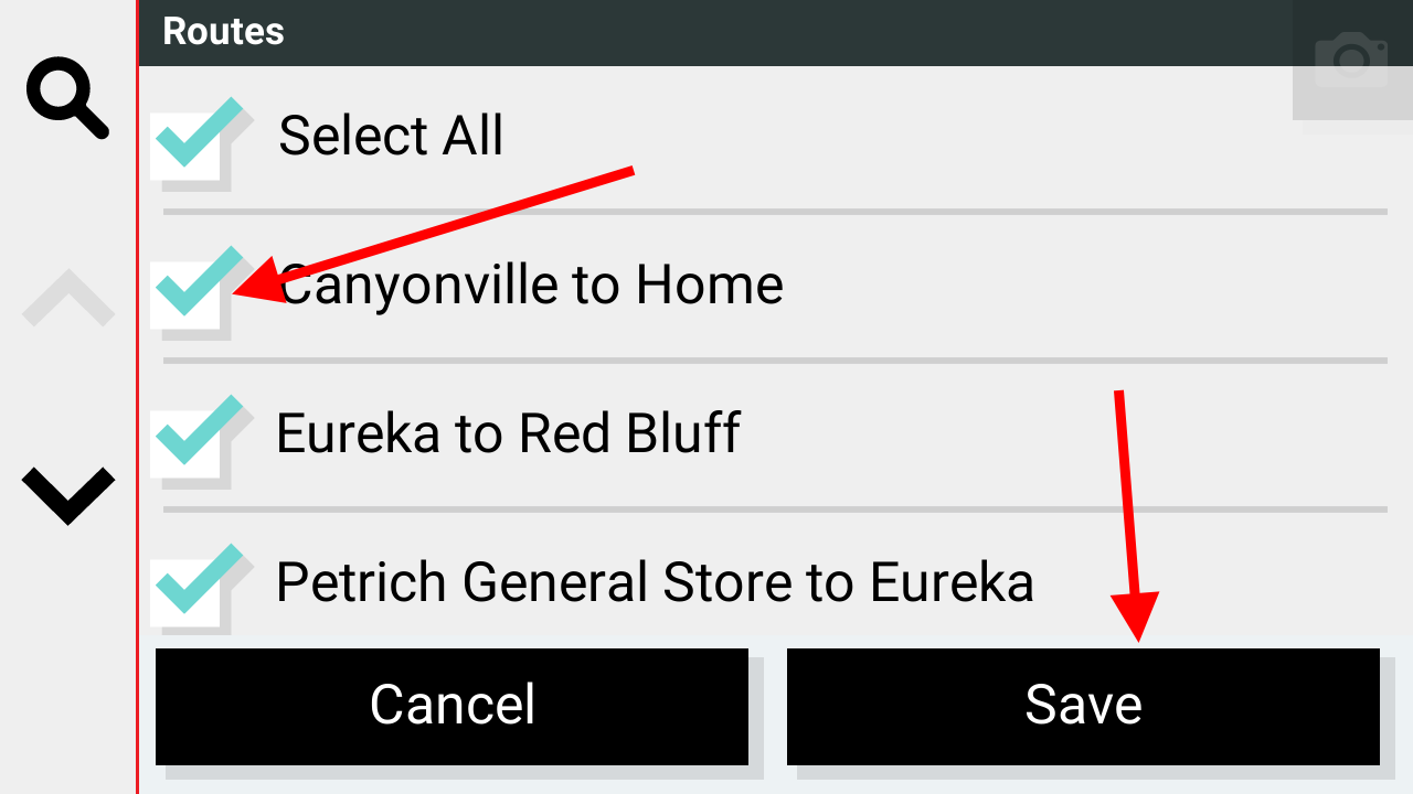

To transfer my routes to the GPS, I select the four routes that make up my trip, right-click on one of the selected routes, and select "Send To..."
Choose "Internal Storage" on the XT2.

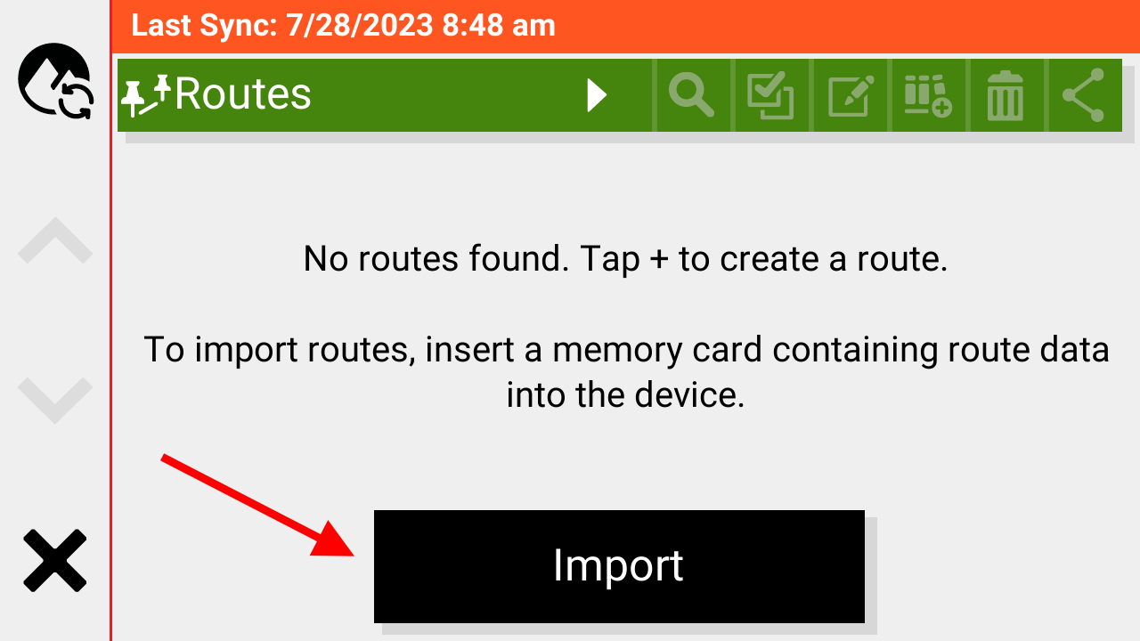

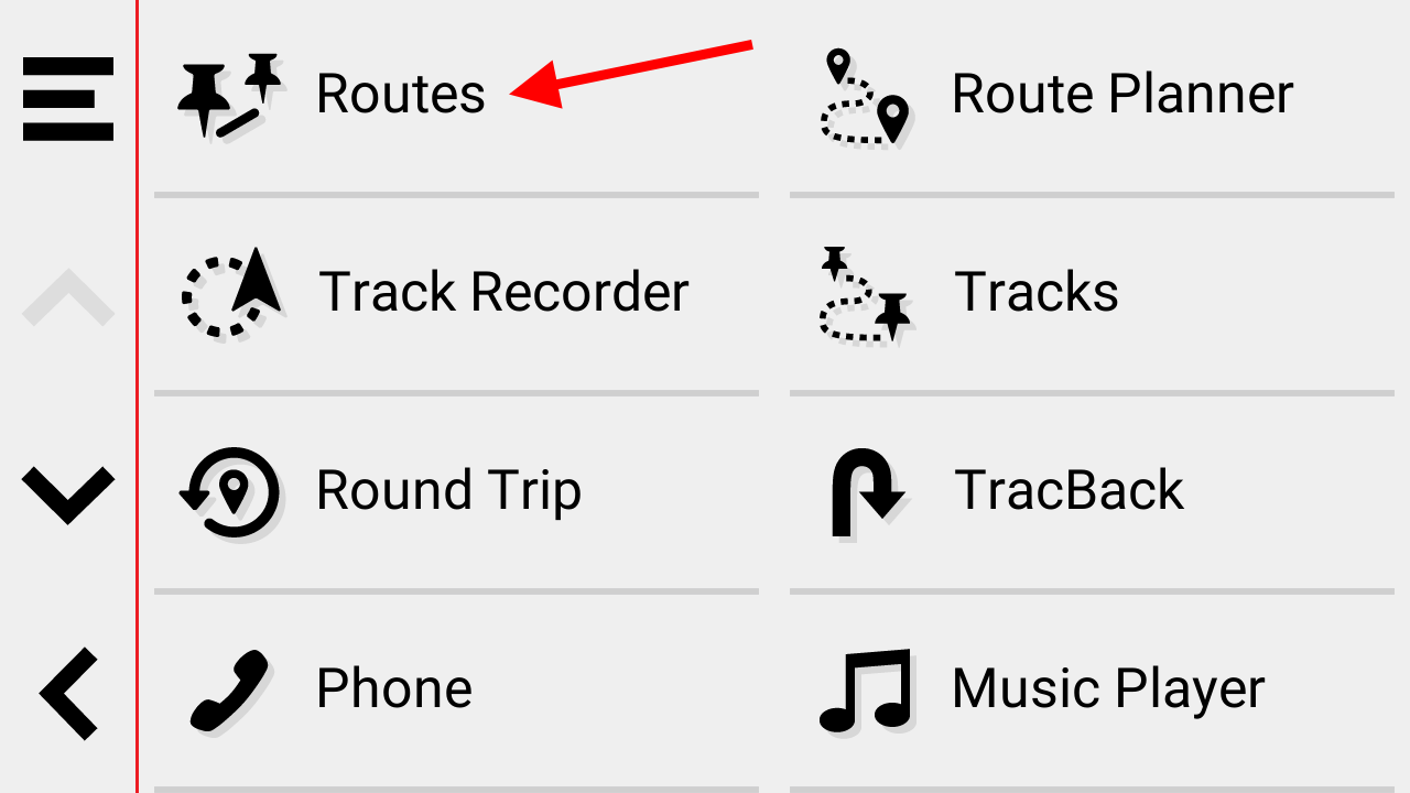

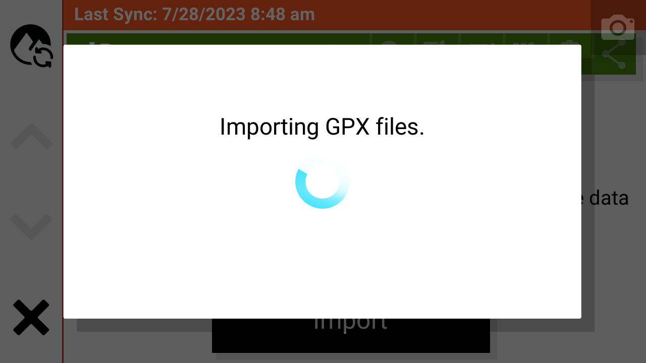

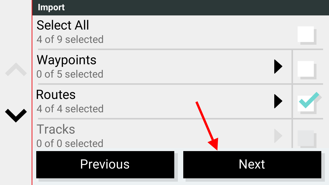

After that, unplug the XT2 from the computer and let it boot up. Then do the following on the device.
Hope this helps. I'm far from an expert, but if you have any questions about the process I used, feel free to ask.

I suspect that when the user taps the IMPORT button it's probably just searching the device file system for any file that has a gpx extension. That leads me to notice that it's in the same place on both my 550 and the XT2. Now I'm thinking, the "Send To..." option in BaseCamp isn't doing any magic, it's likely just a wrapper around "export the selection to temp.gpx and copy to device."
So, I copied temp.gpx from the XT2 to my computer, went into BaseCamp and exported my four routes as GPX, and used BeyondCompare to compare the two files. The only differences were that the waypoints in the file that I exported explicitly had two WaypointExtension elements, one in the gpxx namespace and the other in the wptxl namespace.
