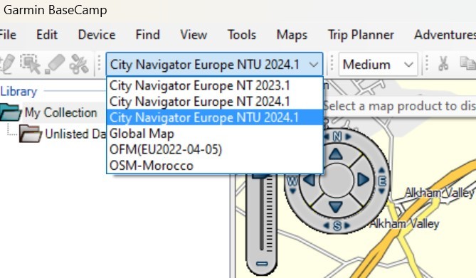

When you open Base camp, do you get this option?
oddball
Posts: 16
Joined: Thu Jul 27, 2023 2:48 pm
Re: Map selection
Post by oddball »
Yes Les ,the map shows up in Basecamp under maps.
