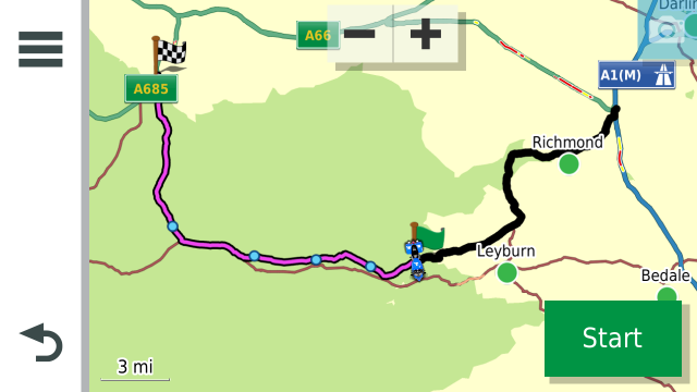

I've been pondering on this very conundrum for a while now. The sharing routes issue, not the being smarter...... You are smart enough to spot exactly what was going on.
I don't have an answer. What I do have is a lot of answers that don't completely solve the problem. Stuff that you know already.
Different Zumos behave differently.
Zumo 660s do not have shaping and via points - but it has route points which behave like shaping points. The route is one continuous section and you can leave it and join it wherever you want and it will pick up the route from the place where you join it and navigate ahead.
You can make the 590, 595 and XT behave like this too. Just don't put in any via points.
With a route like this, if you turn Off-Route Recalculation 'Off' then as soon as you deviate from the route, navigation goes silent. It springs back into life when you rejoin and doesn't bother trying to make you go back.
So this happens with the 660, 590, 595 and XT. Although there are some additional odd behaviours with the XT - that do not affect routing. I had a 550, but I was only just getting to work out how the different routing points worked when it stopped working altogether, and Zumo sent me a brand new 660 instead of a reconditioned 550 !
Now it is a good idea to have Via Points in a route - but they really must be placed where you know that you will definitley stop and regroup. Otherwise they can interfere with the above flexibility of the route.

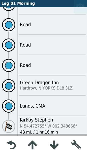

There is one thing that you can do with the 590, 595 and XT. Take a look at the zoomed out map - tap the caption bar at the top, then the map symbol in the top left corner. This shows the route with your position and the shaping and Via Points plotted.
Then show the trip list for the active route. You can see the shaping points ahead. Find one that you want to navigate to next - assuming that you have to detour. I'm going to miss out the next shaping point, and head for the one after that. So that is the third one from the end.
So the one I want to head for is the one above the Green Dragon Inn.

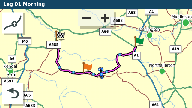

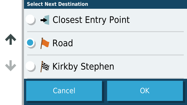

Tap it. The route will recalculate.

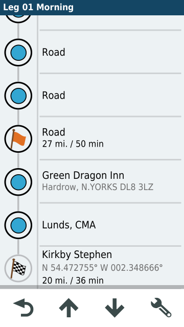

But it has converted that shaping point into a Via. (it is safe to do it this way. It is not safe to convert it back to a shaping point - it will relocate it.
Note that this has now edited the route that was imported. You don't give it permissiont o do this, but it has now changed. If you stop the route and reload it, the new Via point will be in the re-loaded route. You could delete it and reimport it from the transferred routes that may still be in temp.gpx - that will be the original - but Basecamp overwrites temp.gpx every time a new USB connection is made and files are transferred. On the XT check it is there to import before you delete it.
Now stop the route, load it again from Trip Planner and when you say Go, the new Via Point will be there to select as the next destination.
