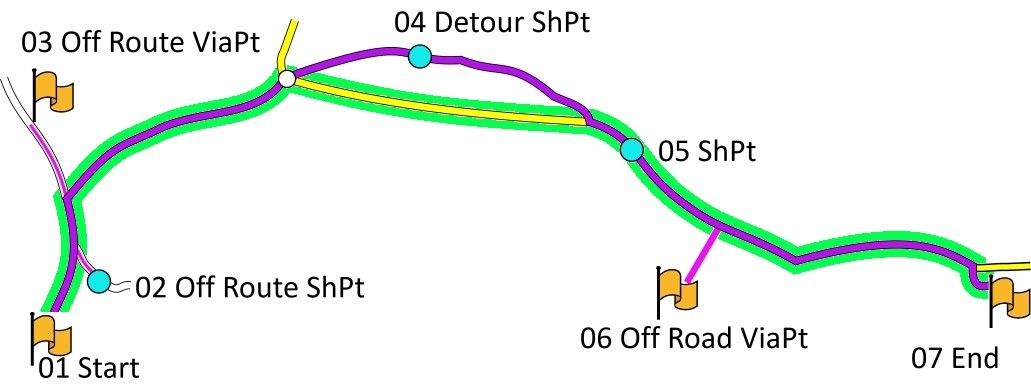

Here is the test route: (Click to see a larger image)
I stopped just ahead of the white rouandabout - after 03 Via Pt and before 04 Shaping Point. I needed to Skip the 03 Via Point which I had not visited, and to which the XT was still trying to get me to turn round and visit. After skipping the route was still plotted ahead at the roundabout (2nd exit) to take me to 04 Shaping Point.
I set off again to the roundabout and took the third exit, rather than the 2nd - which was the way that the route was originally plotted. As soon as I took the third exit, the route recalculated to find a new way to get me to Shaping Point 04. This is shown on the screen shot taken from the video recording. (Click to see a larger image)
This clearly shows the way ahead and after a mile doubling back to visit shaping point 04. Up ahead, just after the junction is shaping point 05. I ignored the demand to turn left to visit shaping point 05 and the XT calcuated the way ahead on the originally plotted route - not minding that I had missed point 04.
This is exactly how it should be. And is exactly how the 590 and 595 would have behaved.

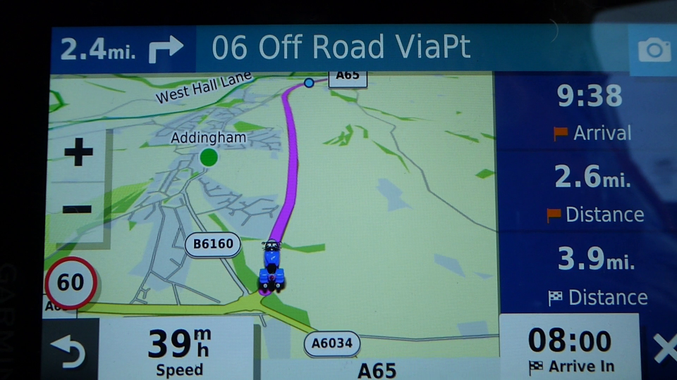

Missing 06 Via Point
Unseen - 06 Via Point is off road. There is no way to get to it.
Saved Route repeatedly demanded U turns after I had gone past it. When I turned round and went passed it again, it continued to do this. It kept asking me to turn round and go back until I got home again.
Imported Route. Allowed me to drive straight past, and just as if it had been a shaping point allowed me to continue ahead to the finish point.
This behaviour is inconsistent with how it behaved at Via Point 3, which was also off route. (Although 06 was closer). But I had pressed skip after not visiting 03 Via Point.
