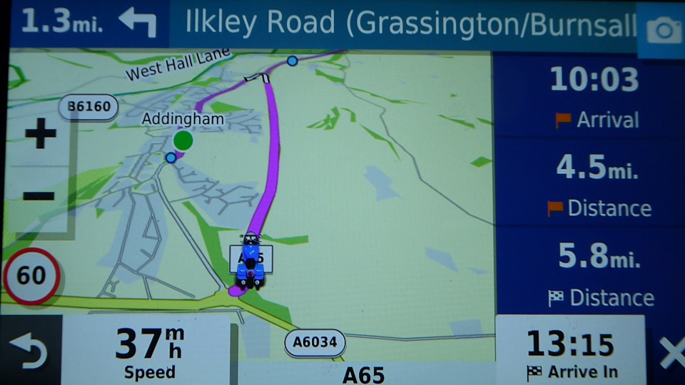

ZUF 01.png (802.38 KiB) Viewed 1394 times
This clearly shows the way ahead and after a mile doubling back to visit shaping point 04. Up ahead, just after the junction is shaping point 05. I ignored the demand to turn left to visit shaping point 05 and the XT calcuated the way ahead on the originally plotted route - not minding that I had missed point 04.
This is exactly how it should be. And is exactly how the 590 and 595 would have behaved.

This is the screen shot just after taking the third exit fromt he roundabout, having ignored the satnav which was directing me to take the second exit. (Click to see a larger image)
ZUF 02.png (775.03 KiB) Viewed 1394 times
Note that 04 Shaping Point has disappeared. The route is plotted ahead to visit 05 Shaping Point and continues to the right turn for 06 Via Point. When I passed 05 Shaping Point, the Zumo changed the shading of the magenta line to indicate that I had entered the next section. But shaping point 04 had gone, it had been removed from the route.
My interpretation of this is that having got lost, it was now heading for the closest entry point. The route just ahead of 05 Shaping Point is probably the closest - and as we know, any route points before the closest entry point are ignored.
