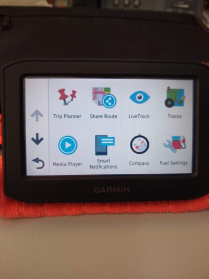

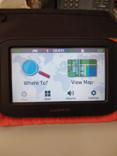

OK so we start here at the Home Screen
Open Apps

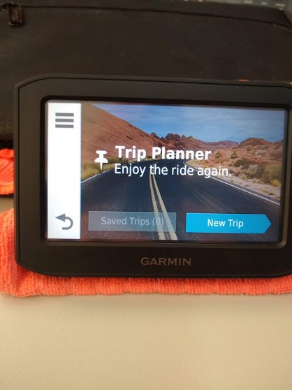

Open Trip Planner
Then Open the Sub Menu using the Icon in the top left hand side that looks like 3 horizontal bars.

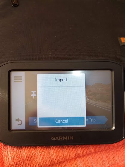

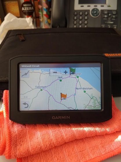

Having opened the Sub Menu
You get this

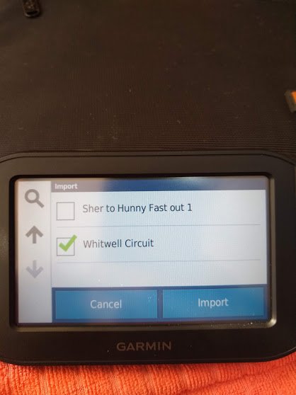

Open Import

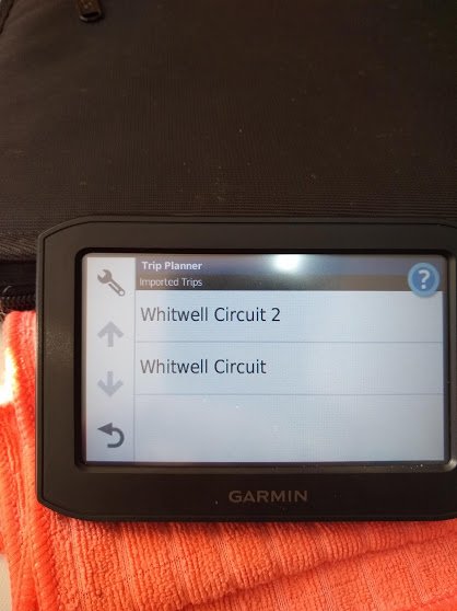

Check the box of the route you want to import and open using the blue Import button
And there you have the route ready to GO

And just to prove (to myself) that it wasn't a fluke
I did it again this time with a new route that had not been on the Zumo before
