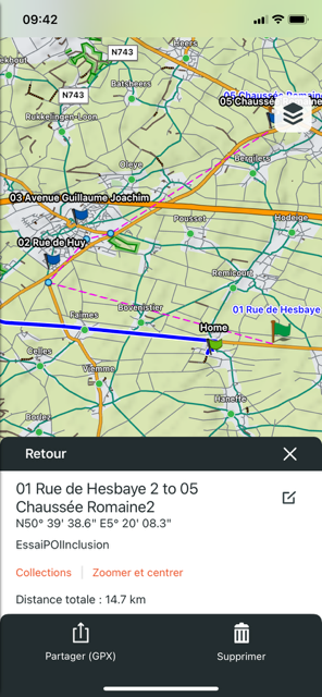

The route just after opening in explore with Tread:

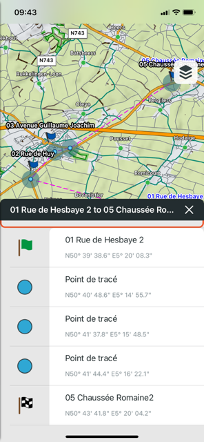

The corresponding shaping points:

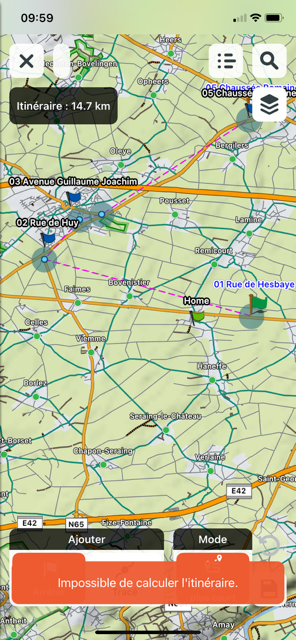

When I try to edit the corresponding route in Tread, error message:
The mods induced by the sync between the explore db and the XT2 are not very safe either way...
