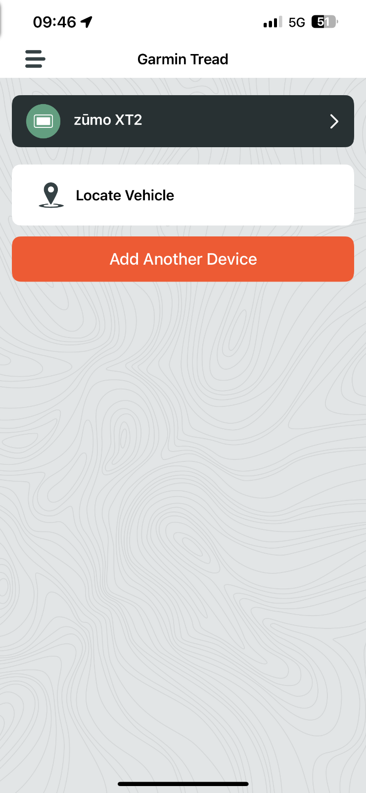

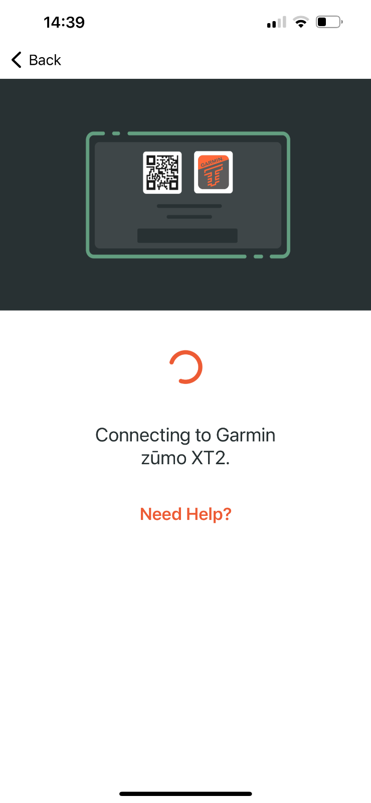

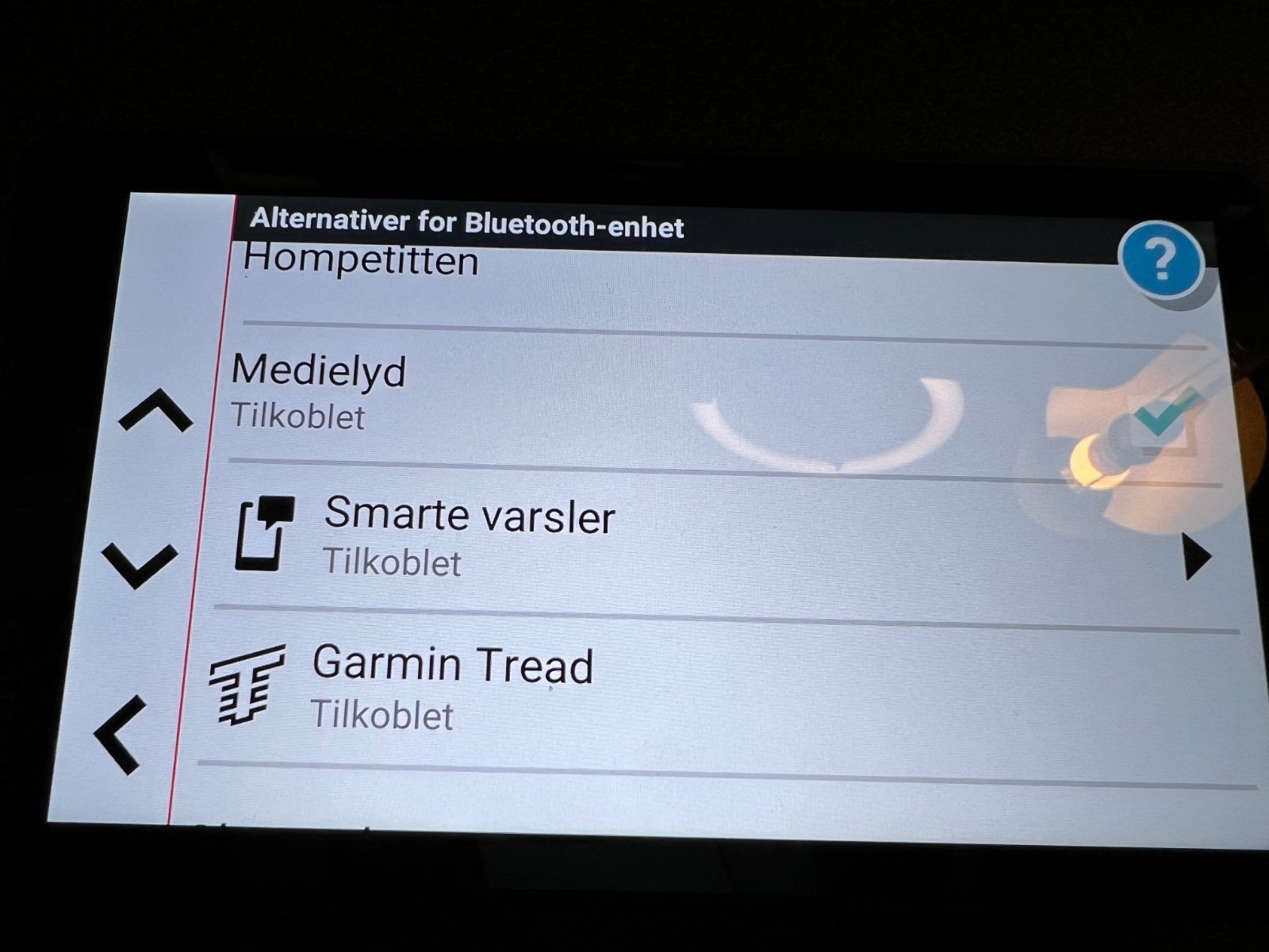

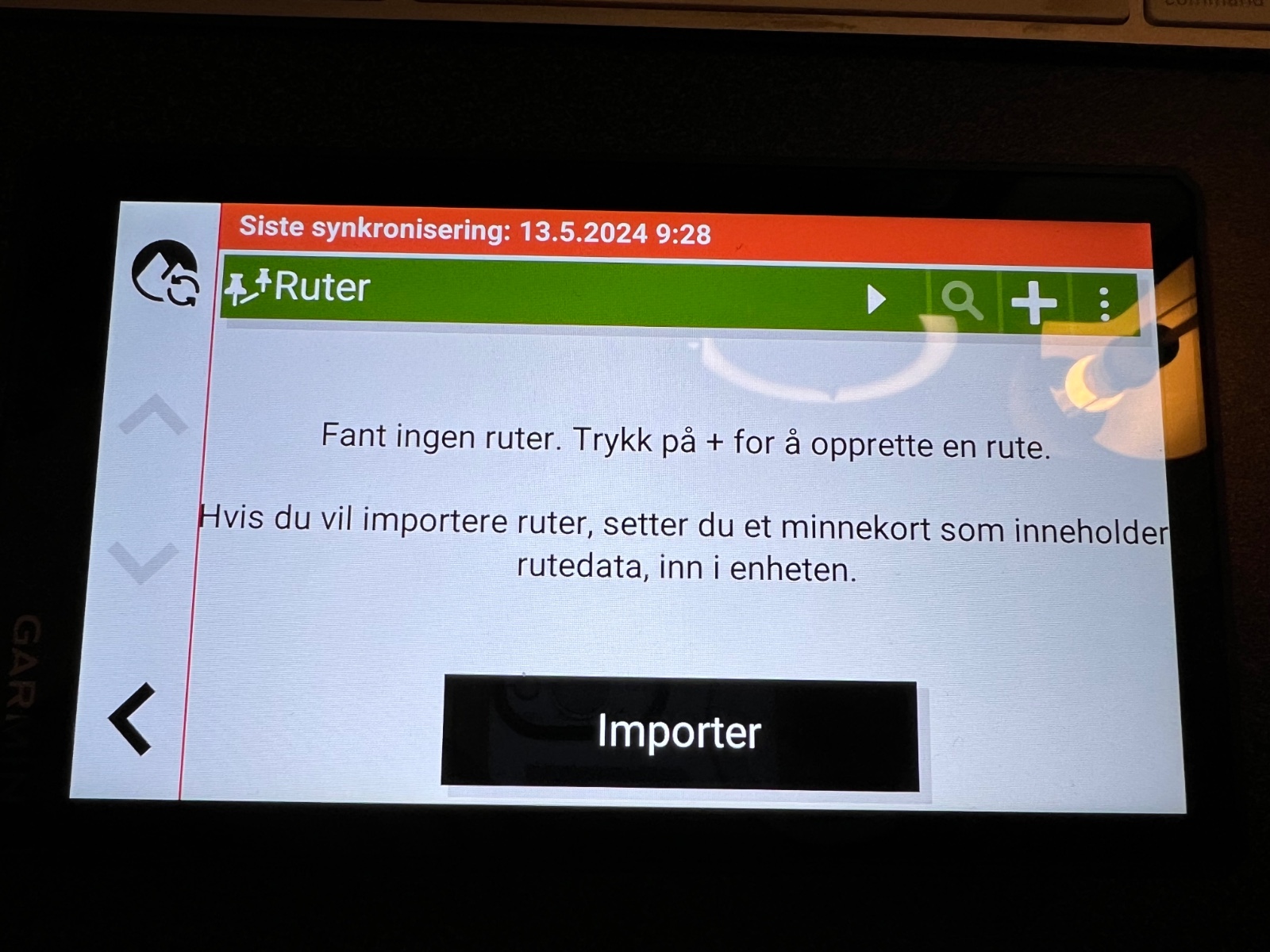

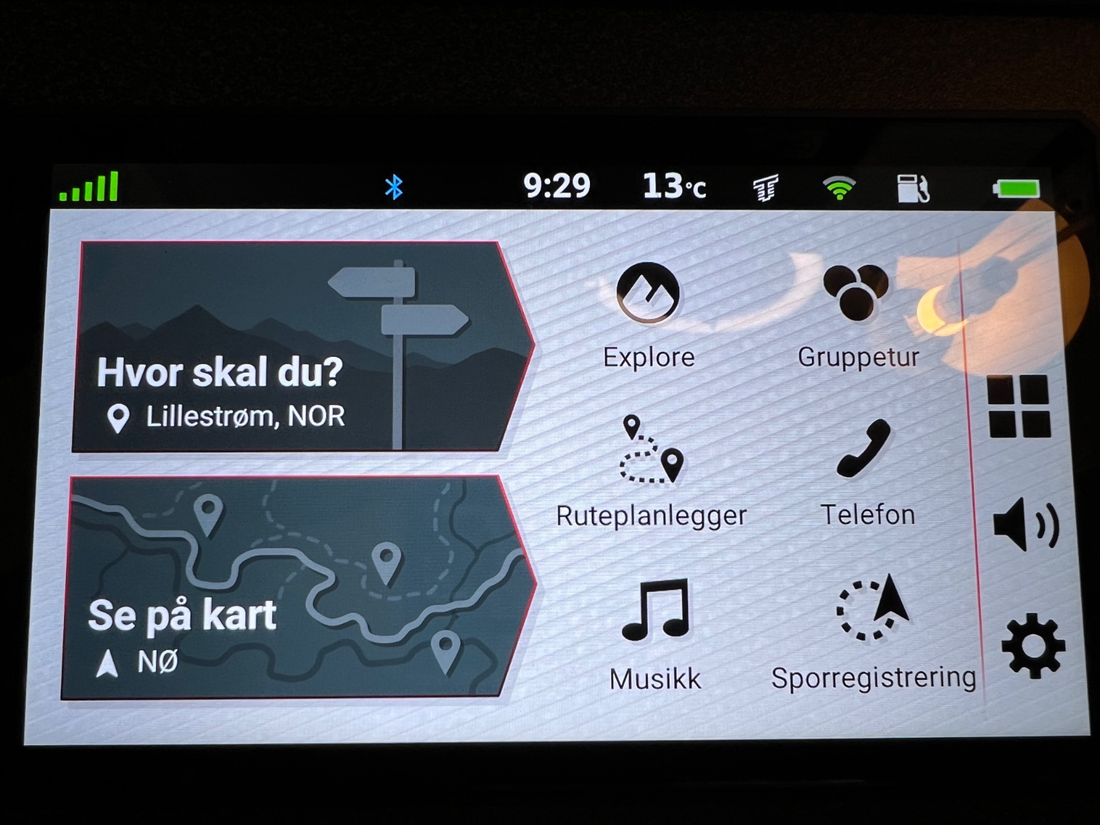

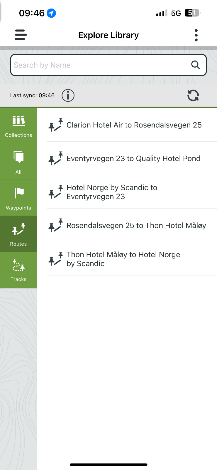

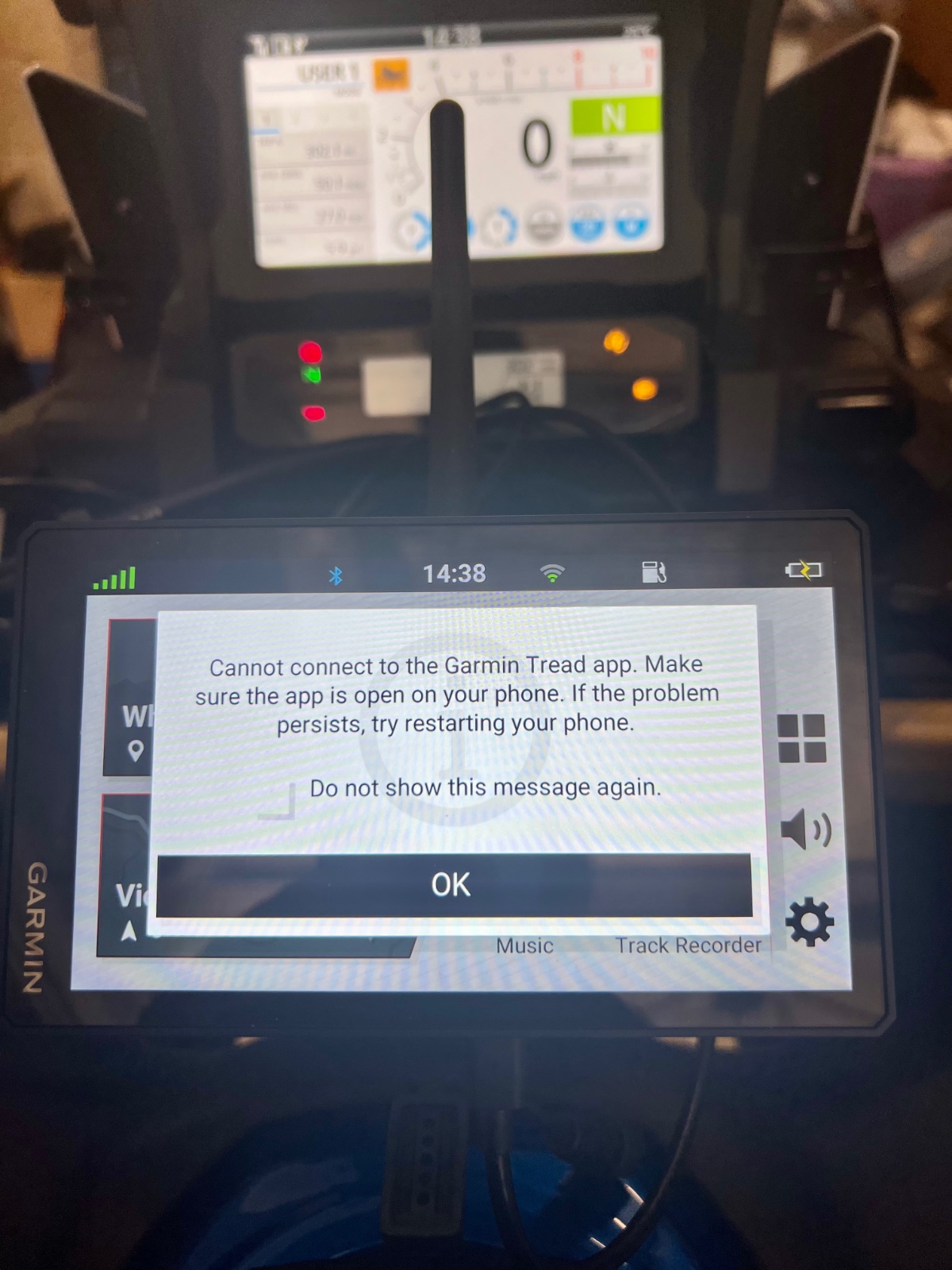

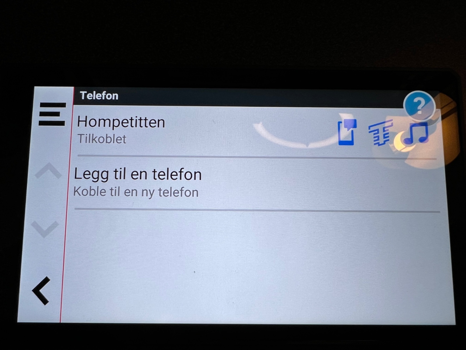

Tread app and XT2 are connected and syncs. But only from the XT2 to the app. Routes on the app are not synced to the XT2. Why?
I’ve rebooted the XT2 several times. I’ve uninstalled and installed the app. No difference.
Attached are pictures of the app and XT2
Thanks

Re: Tread app not syncing to XT2
Garmin has really dropped the ball with the Tread App connection to a XT2. Nothing but complaints about how unreliable it is.
Most reliable way to get your personal routes to work correctly, (from my personal experience and reading other posts) is to use "BaseCamp" to plan the route and then send to the XT2, via direct cable connection between a PC and the XT2.
BaseCamp WILL notify you that it doesn't support the XT2, but just ignore the warning and go ahead and send your route to the XT2. There's a tone of tutorial videos on how to use base camp. Here's how I learnt to do it. The video series relates to the earlier Zumo XT, but with a few "tweaks" it will also work for the XT2. On YouTube search "Mapping and Route Planning for Adventure Bike Riders"
Thanks for the reply. I can import via the SD card, and it works... I am now importing my GPX files into Explore on my Mac, then entering the explore app on the phone, and exporting to the Tread app, and it somehow works... So workarounds work, but not as intended with the Tread app in a easy way
