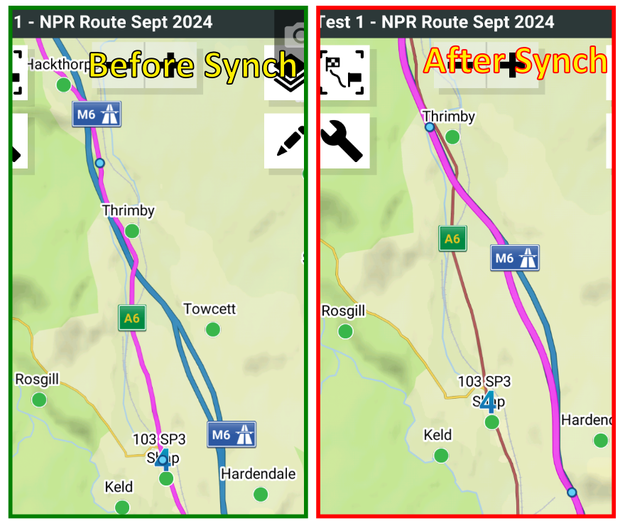

Imported Routes on the XT2
Imported routes tend to become altered on the XT2 if they are synchronised via the Tread App on your phone.
Here is an example of the problem. The route one the left is what I planned and sent to the XT2 as a gpx file on the SD card.
This route stays like this - as long as it isn't synched with the Tread App. As soon as it synchs, then it changes the route and moves the shaping points.
A few of us have reported this to Garmin - but please, if you come across it then report it as well. THe more they realise that it is a big problem the more chance that they might do something about it.
