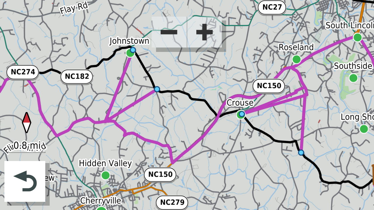

Awhile ago I posted about a re-route due to a road closure. The resulting route was what appeared to be a bunch of direct routes to route points that were not part of the original Basecamp-created route. It was not made up of parallel lines or ones that radiated from a single point, they just zig-zagged and crisscrossed through farm and wood land. I was able to manually route myself around the closure and then restart the route. All was well after that. I will add the screenshot image once I find it.
Found it. The black line is the track line of the original route.
Re: XT routing madness
I wonder if the road closure has something to do with this ?
It looks as though it has a perfectly good alternative route plotted, (if you ignore the straight lines) - given that it cannot go along the route of the black track. But then it has those shaping points to visit.
If you plot shaping points in a field, rather than on a road, then the Zumos get as close as they can to that point and then and bee-line to that point, then double back along the same straight line to where it left the route. If there is another point it does the same thing.
If there are two points close to each other, both on non-navigable roads, it cannot visit one, then the other. It has to visit one, turn back to the navigable part of its route and then straight line to the other.
As far as the XT is concerned the black line is not navigable - there is no road there (there is, but it is closed) - so it is the same as being told to reach a shaping point in the middle of a field.

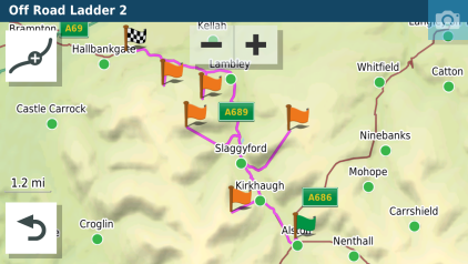

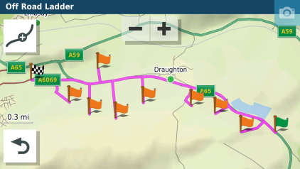

I've seen this in the early days of owning an XT. I was trying its reported abilty to navigate along tracks and trails - so plotted a series of shaping points on a bridleway - open to horses and bicycles, but not to traffic. But the map didn't know about that.
Like this:
and this:
Both routes on roads running alongside a hillside. No navigable roads there, so find-your-own-way straight lines it is. A couple of the spurs manage to find a cart track for part of the trek, or someone's drive !
Actually, that recalculated route on your (@Peobody's route - odd as it looks - is perfectly navigable. You follow the instruction and when it turns off in a straight line into a field, you ignore it. You're on the magenta line, its only a shaping point. It wont try to take you back to it. The only issue would be at the right hand end where it finds a side road before it goes across fields, as it is less easy to spot that it is about to take you through the nearest quagmire when it firsts turns you off the main road. But the magenta line going ahead and also taking a side road is a big clue.

jfheath wrote: Mon Oct 07, 2024 5:08 am I wonder if the road closure has something to do with this ?
The shaping points (blue dots) on the black line are the ones that were in the original route. That is mute though because the closure was right about where the "NC182" badge is. Everything that goes on beyond the shaping point a Johnstown is garbage. It should have routed to that point and then through the remaining route points.

Yes - I thought that might be the case - BUT - the road closure information is not very precise.
I was once in Derbyshire (middle England) - nice roads, nice hills. I got a warning that the A6 was closed. The A6 is a major road through Derbyshire - but it actually stretches for over 280 miles from just north of London, up to the Scottish border.
I decided to ignore it - there would be road signs surely. I was traveling the A6 north for about 25 miles, and all of the time it kept trying to divert me from it. There wasn't any hint of road works. When we got home, I looked it up. Near to where it was first announced, there was a roundabout. Left headed south, I was heading north. About a mile south of the roundabout, there were some road works - managed by traffic lights. But traffic was flowing. Yet according the satnav the entire section that I was riding was closed
Elsewhere in the Dales, close to where I live, they did some work on the main streets of a few small towns. The sections of road were closed for this work, at the same time - but only from 22:00 to 06:00 The rest of the time the traffic was flowing reasonably freely. Yet according to the info that the satnav was getting, it wasn't at all passable.
So it's not what is actually there - it is what the satnav has been told is there. And it is not to be relied upon.
Maybe it wasn't the road works - but I reckon that your scenario is close enough to the examples I gave for it to be something like that.
The route has recalculated, and for some reason it does not think that the black track road can be navigated. But it has to visit the shaping points.
