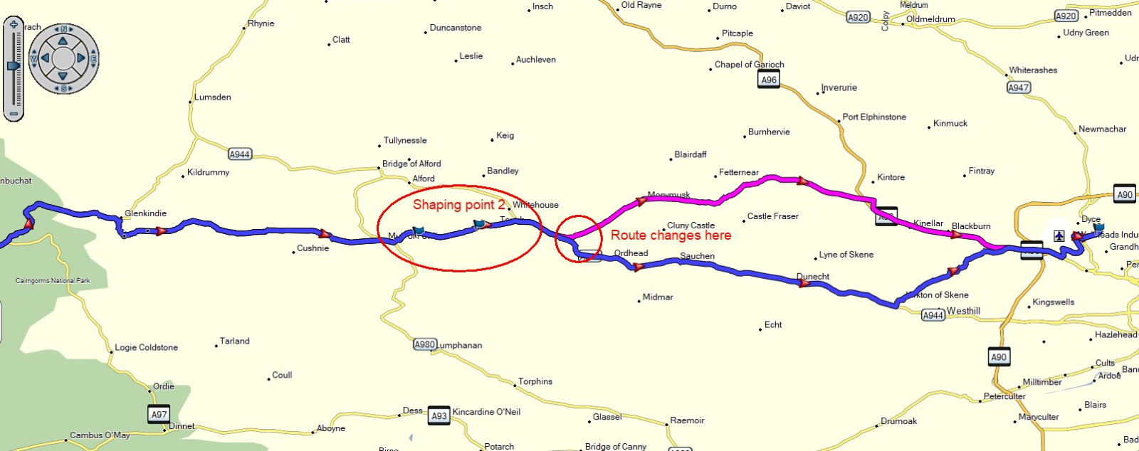

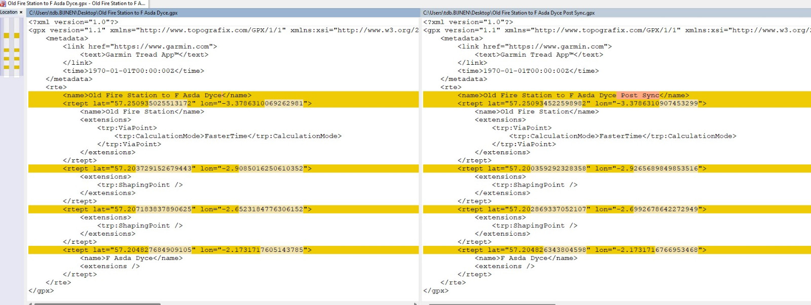

I dont have an XT2 and cant contribute much, but I was interested and downloaded the GPX files. There are 2 things that I dont quite understand. Apologies if it's not relevant.
1) Not only the 2 shaping points are moved, but also the start and end point. Just a little, you may not notice it in Basecamp. But Thread changes not only Shaping points! See the compare screenshot.
2) The 2nd shaping point is moved a bit earlier in the route. (more east). But I dont understand why the resulting route in Basecamp should be different. The point where the routes are different are after the 2nd shaping point. May be irrelevant.
Compare:

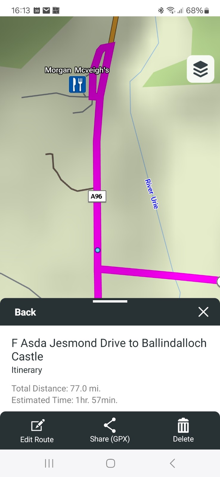

Played with producing a route in my XT2 and then syncing it with Tread. The shaping point moves, but the route still follows the logic of where it was prior to the sync! Shaping point was near to my way point of Morgan Mcvies.
Garmin support updated with this gem :lol:

FrankB wrote: Tue Oct 29, 2024 8:33 pm 2) The 2nd shaping point is moved a bit earlier in the route. (more east). But I dont understand why the resulting route in Basecamp should be different. The point where the routes are different are after the 2nd shaping point. May be irrelevant.
I think that the route changes are due to Basecamps superior routing logic, which seems to avoid the faster roads problem that afflicts the XT and XT2.
The northern routing is about a minute shorter if the start point is before the junction near to Tough.

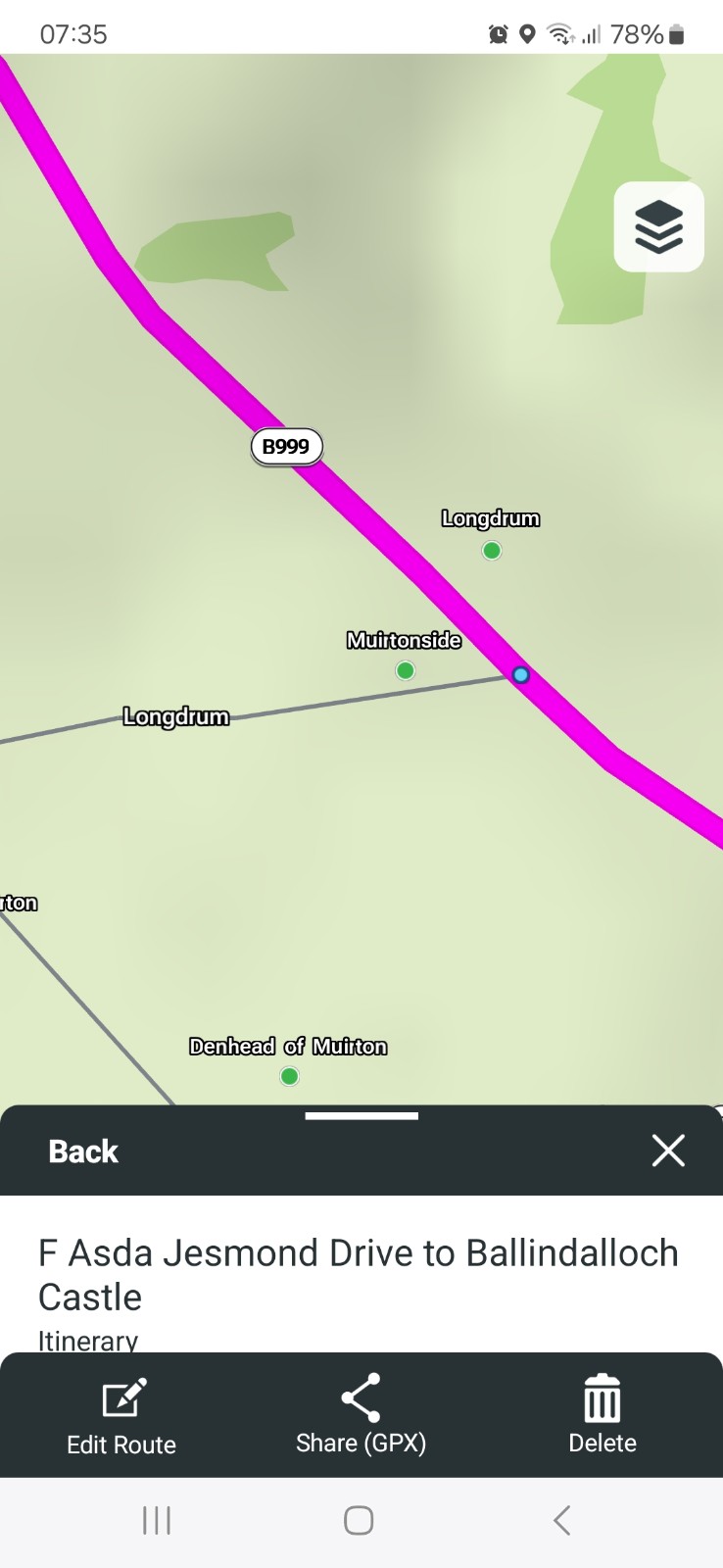

jfheath wrote: Wed Oct 30, 2024 9:58 pm Does anyone know whether there is a potential map difference between Tread and the XT2. Do we assume that Tread is always using the latest maps? So what happens when the XT2 has not been updated, but Tread has.
I have the latest CN EU NTU 2025.20 on my XT2 and I'm sure if nothing else there is a difference at least in their presentation.
If you look at the below screenshot (from Tread) at Longdrum, it has a green dot to the north of the B999, but text below the minor road off to the west. The text position corresponds to the CN EU maps position.
Google maps agrees with the Tread map: https://www.google.com/maps/place/Longd ... FQAw%3D%3D
