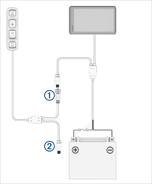

jfheath wrote:The thread discusses the way that the handlebar controller is wired up. The downloadable instruction manual suggests a cable that did not exist when the controller was announced. The three cables that did exist (power cable and two varieties of Y cables) were not mentioned in the manual - so we were trying to work out exactly what needed to be bought. I bought both cables for the XT2 and the controller having had the purchase verified by product support - who had to go away and ask someone else.
However. A brand new fourth accessory cable has recently been listed which seems to be all that you need to buy. It matches the diagrams in the manual - but not the text. See later posts Page 4 28th Dec 2024.

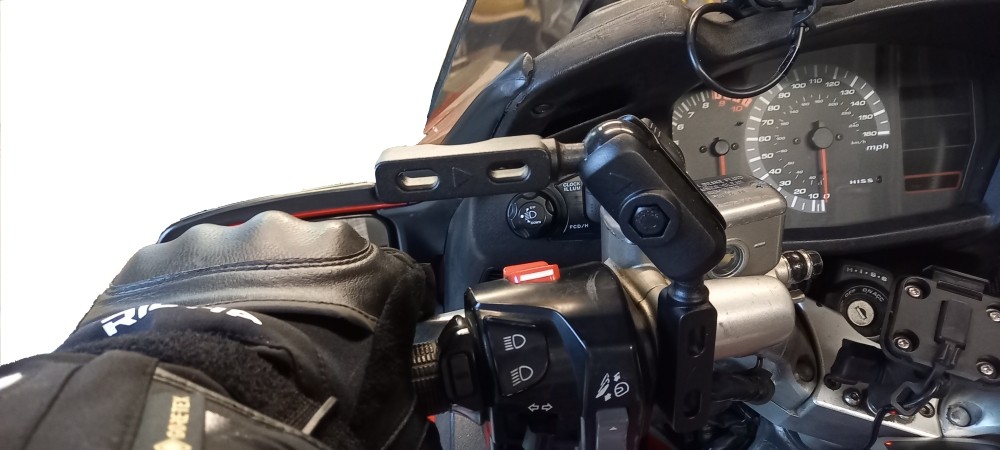

Edit - just been playing to see where it would fit.
Controller Mount.jpg (92.13 KiB) Viewed 9058 times
This might do the job - the vertical Ram Ball is currently just push fitted onto the existing clutch lever clamp bolts. The controller's circular clamp might secure to the horizontal part as it is, but I have some 1" diameter PVC tube which I could soften and drive over the horizontal RAM ball mount.
The controller would clamp verticaly over that (although I was thinking of trying to secure it horizontally somehow). It is out of the way of my hand, within thumb reach and doesn't catch the screen on full lock. It probably doesn't need the full length of the horzontal part if mounted vertically . If it works vertically, a Ram ball on a thread and a piece of 1" diameter alloy with a threaded hole in one end would make a neater job.

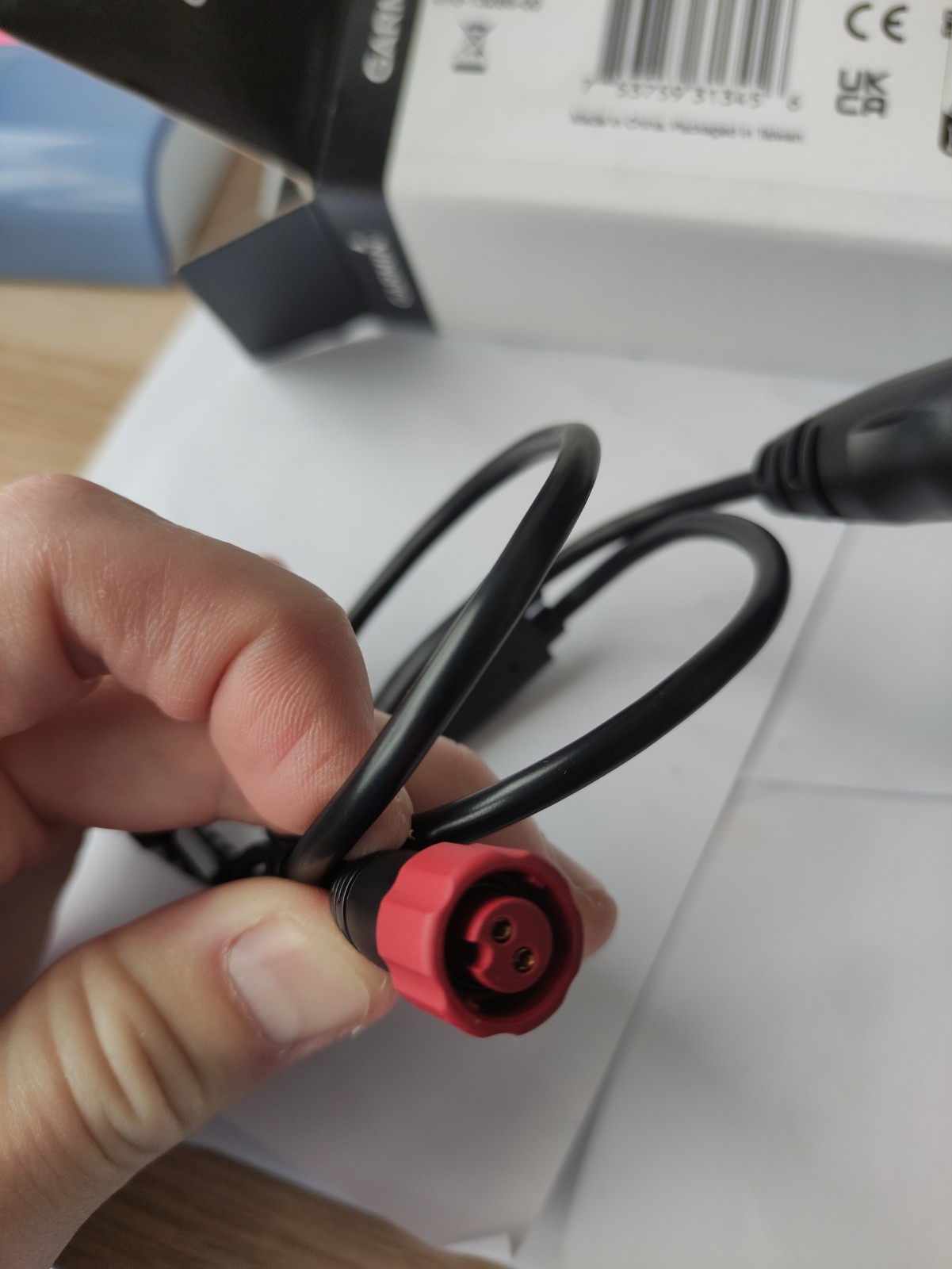

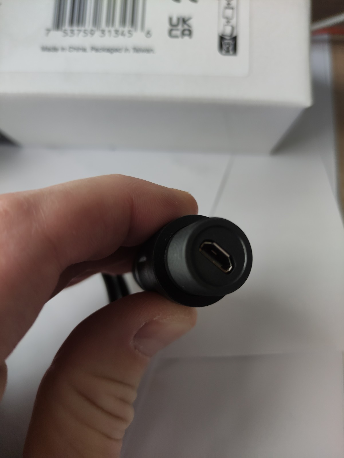

The cable just arrived:
Garmin ref.:010-13285-00

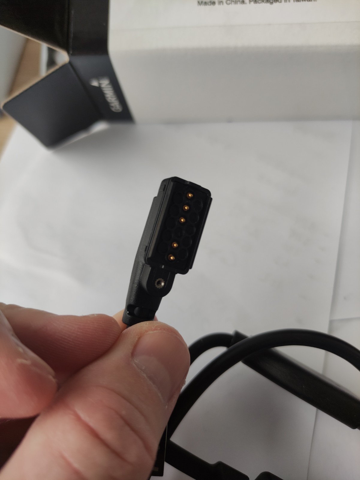

How does this connect to the previous installation? It seems that some other cable is needed. :?
It may be this one:
Installing the controller is going to be more expensive than the XT2...

Re: Handlebar Controller for XT2
That's not what it looks like in the instruction manual in the pdf I posted above !
Does the controller come with a cable already attached ? If so - what does that look like ?
Post by turbo19 »
Yes, I looked at the schematic in the morning, but it doesn't match the cable that the manual says is needed (010-13285-00, which is the one I have and I have uploaded the photos). I don't know which cable appears between the battery/XT2/controller in the diagram.
Maybe both cables are included in the remote controller?
We will have to continue investigating.

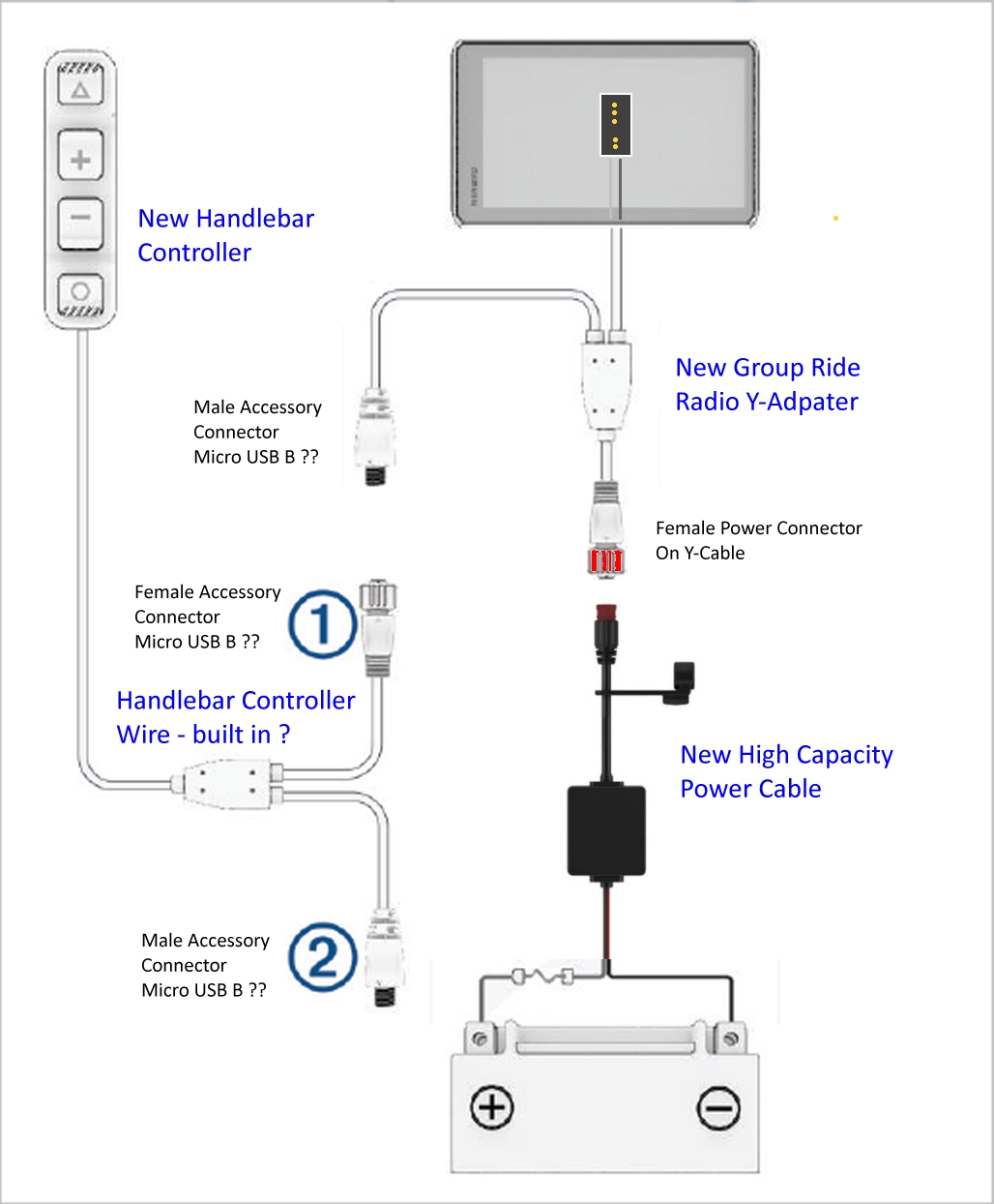

Would this make sense ?
Remove Present XT2 cable form cradle and from battery.
Buy High Power Cable
Buy Group Ride Radio Y-Adpater
Join them togther.
Plug Handle bar controller into in-line micro B USB ? connector, leaving a spare USB connector so that you can buy the group radio set-up !!!!
This diagram is all Guesswork.
But is based on the information in the published instructions for the Handlebar Controller for the XT2
Wiring Query.png (346.63 KiB) Viewed 8959 times
The above arrangement conflicts with the diagram - but not with the text. Also the XT2 & Group Ride 'Bundle' includes the standard power cable, the high capacity cable and the Group Ride Radio Y-Adapter.
I've labelled the diagram with micro B USB connectors - because from @turbo19's photo, they look similar to that variety of connector (as used on the Zumo 590 and Zumo 595) - but they may be something different.

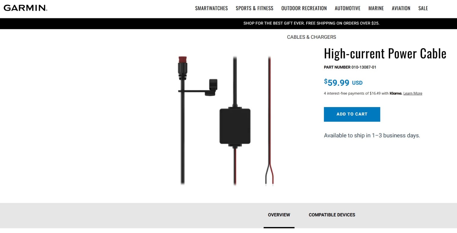

Stop Press

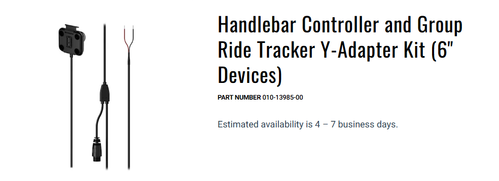

The assumptions that I made to create the diagram were perfectly correct. But are now redundant. Not two days since Santa delivered my controller and two cables as described, but a new cable has appeared on the Garmin website: see screen shot below.
Handlebar Controller.png (51.75 KiB) Viewed 7024 times

jfheath wrote: Sat Nov 09, 2024 5:55 am Would this make sense ?
Join them togther.
This is still all Guesswork .
Garmin asnwer, and solution (@jfheath you are right):
https://support.garmin.com/es-ES/?faq=j ... tab=topics
Clarified issue, the Y-adapter and High-Current Power Cable are required.

Just so no one feels stupid, I just called Garmin to ask about cabling this thing and the tech couldn't figure it out either and told me to, "just buy both cables and if you don't need one send it back and let us know." From what has been described above and is obviously correct, both cables are indeed going to be necessary which makes this controller pretty pricey. I'm already in this far having bought the controller so might as well go the full monte :-)
