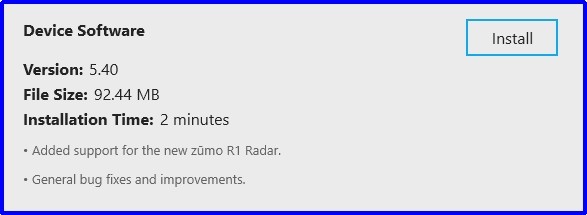

6 January 2025
XT2 v5.4.jpg (16.42 KiB) Viewed 2170 times
I think mine was at Software Version 4.70
I wonder what warranted a jump to 5.40

jfheath wrote: Mon Jan 06, 2025 3:23 pm 6 January 2025
zumo R1 Radar? what´s that?
I will make some tests this week to investigate what's new with this software.
Let's hope they are improvements, and nothing gets worse :lol:

turbo19 wrote: Mon Jan 06, 2025 3:52 pm zumo R1 Radar? what´s that?
Evidently. it's their new Blind Spot System of some sort.
https://www.garmin.com/en-US/p/1227031
I updated and took a look at some of my wish list of fixes. Nothing seems to be better from a bench test perspective.

jfheath wrote: Mon Jan 06, 2025 3:23 pm I think mine was at Software Version 4.70
My XT2 is at 4.80 with 5.40 available for download.
