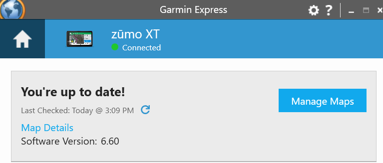

PaulaRay wrote: Mon Apr 07, 2025 6:58 pm once opened it shows 6.60.
The "6.60" is the software version installed on the XT. It has nothing to do with maps or Garmin Express. Unfortunately, your Garmin Express doesn't make that clear. Mine does. Don't know whether that is because I'm still on 7.24 or because mine is Windows.
Re: Update 2026.1 P.I.A.
6.60 is the Software Version of the XT, not the Express version.
See Settings→ Device→ About
The Windows Express version number is found by clicking the Gear icon in Express and then clicking About.
I don't know how the Mac version is found, Macs are weird. ;)
Wow... didn't know that... Thanks. Ray
