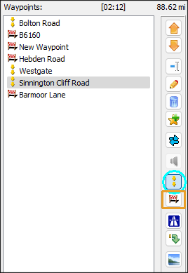

I created a route with 7 route points and went looking for how to set them as either via or shaping.
It took a while, but I eventually found it. Two little icons alongside the list of route points (Headed 'Waypoints' in Tyre), which when clicked alter the status of the currently selected route point or all of the selected group of route points.
The pop up description when you hover over these icons says:
Via Point (Mandatory Waypoint) - Garmin calls this a Via Point. Some people refer to it as an alerting route point.
Shaping Point (Free Waypoint) - Garmin calls this a Shaping Point - some people refer to it as a silent route point.
In the screen capture of the Tyre program below, these two buttons are shown high-lighted.
Shaping Point - blue circle
Via point - orange rectangle
Tread Via & Shaping.png (17.79 KiB) Viewed 2514 times
I took a look at the GPX file that Tyre created: ( I used v 1.1)
My GPX file contained no Waypoints - as defined by the gpx markup commands <wpt>
My gpx file contained 5 Via points (including the start and end).
My gpx file contained 2 shaping points.
So exactly as I had specified in my Tyre route - except the start and finish - which in Tyre were shown with the shaping point icon. Start and finish must be Via Points. The 'save as gpx' option clearly corrected this in the gpx file, but not on the screen map.
Vias are shown in Tyre in the Route Point List (it is headed 'Waypoints') They have a red chequered flag icon.
Shaping points are shown as the double yellow arrow icon on the Tyre screen
So to make all of your points shaping points except start and finish - click on the 2nd item. Hold the ctrl key down click on the next to last item. Click the doubleheaded arrow icon.
Then make a few of them Via Points. The stopping places perhaps. I like to put these at the exit of the stopping place - on a road that I will definitley take after setting off again.
