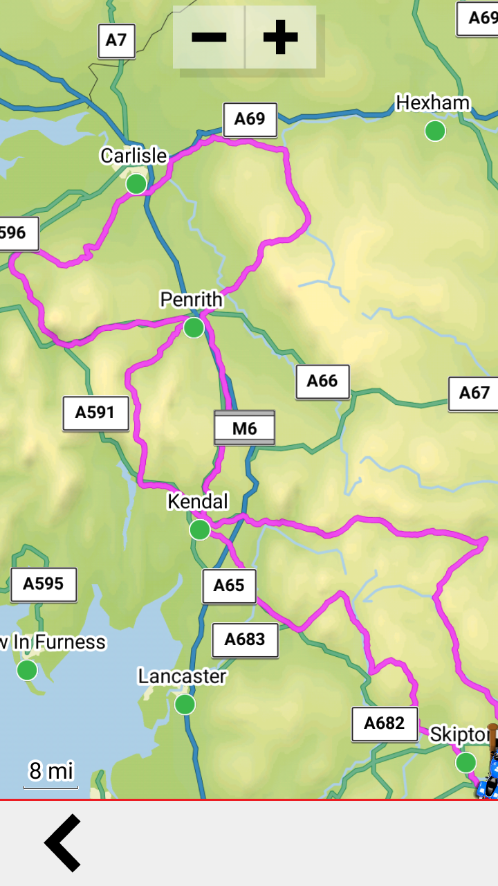

    Or like this 250 round trip that I have just generated on my XT2.
    XT2 250 mile Round Trip.png (989.44 KiB) Viewed 208 times
    The route starts at the bottom of the page and heads north up the right / east side of the loop. Then from the A69 it starts heading south down the left / west side of the route.
    There are a number of places where the route heading north is VERY close to the route heading south - if you go off route - eg for a coffee stop - the XT2 will find a way to the nearest point on the route from your current position - and in places like Kendal and Penrith, that could easily find the section heading south, when you are still heading north. This is not what I think - I know this because I have tried it.
    So what @smfollen was suggesting was to create two routes. In the example from my map, One route would take you north using the East / Right side of the map - up to the A69 at the top. The other would bring you back down the west / left side.
    That technique prevents the problem of the satnav jumping onto the wrong part of the route
    You cannot do this using round trip. However - you can insert an intermediate destination and it plots the first half and draws a dotted straight line back to the beginning, Perhaps when you get there, it calculates the return part of the route. I don't know. It seems likely. I'll have to try that one day to find out.
