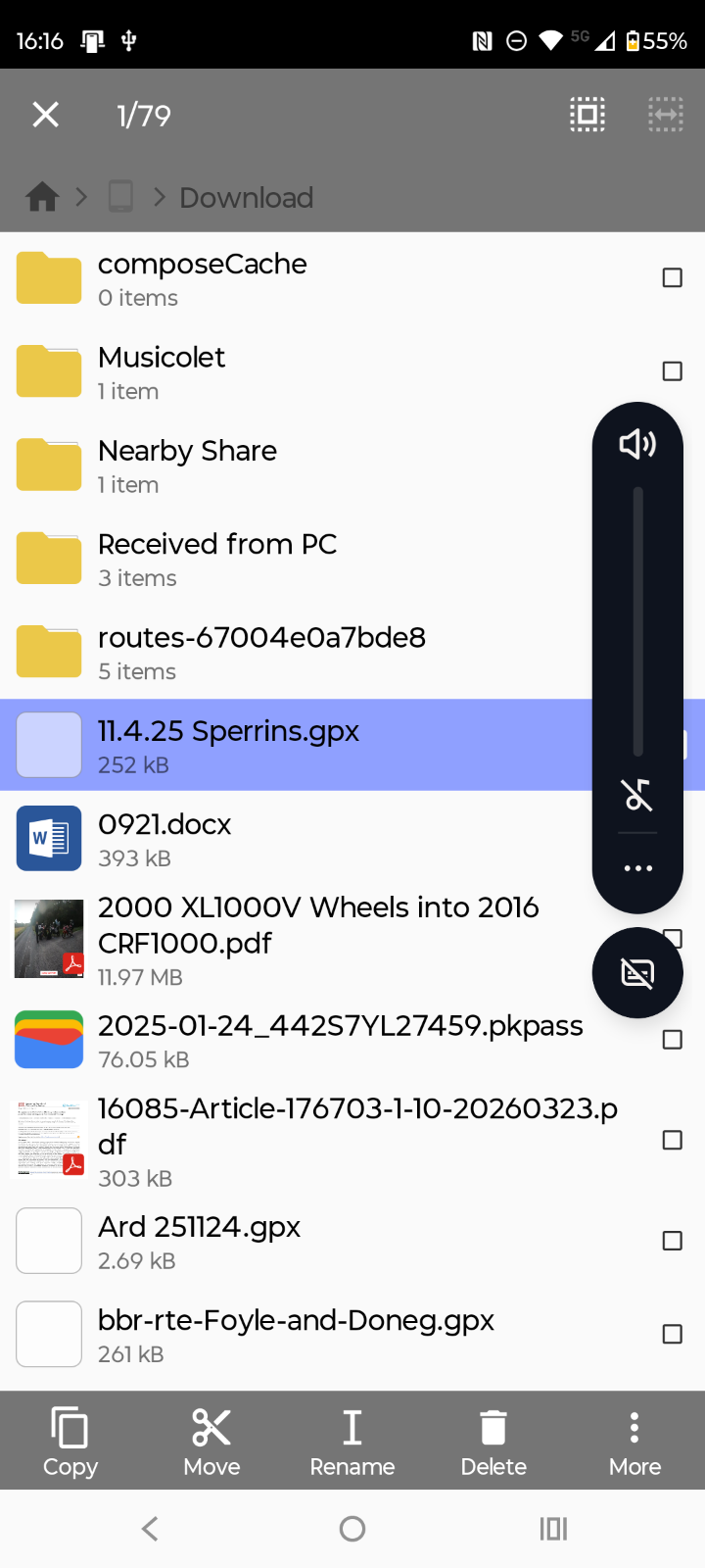

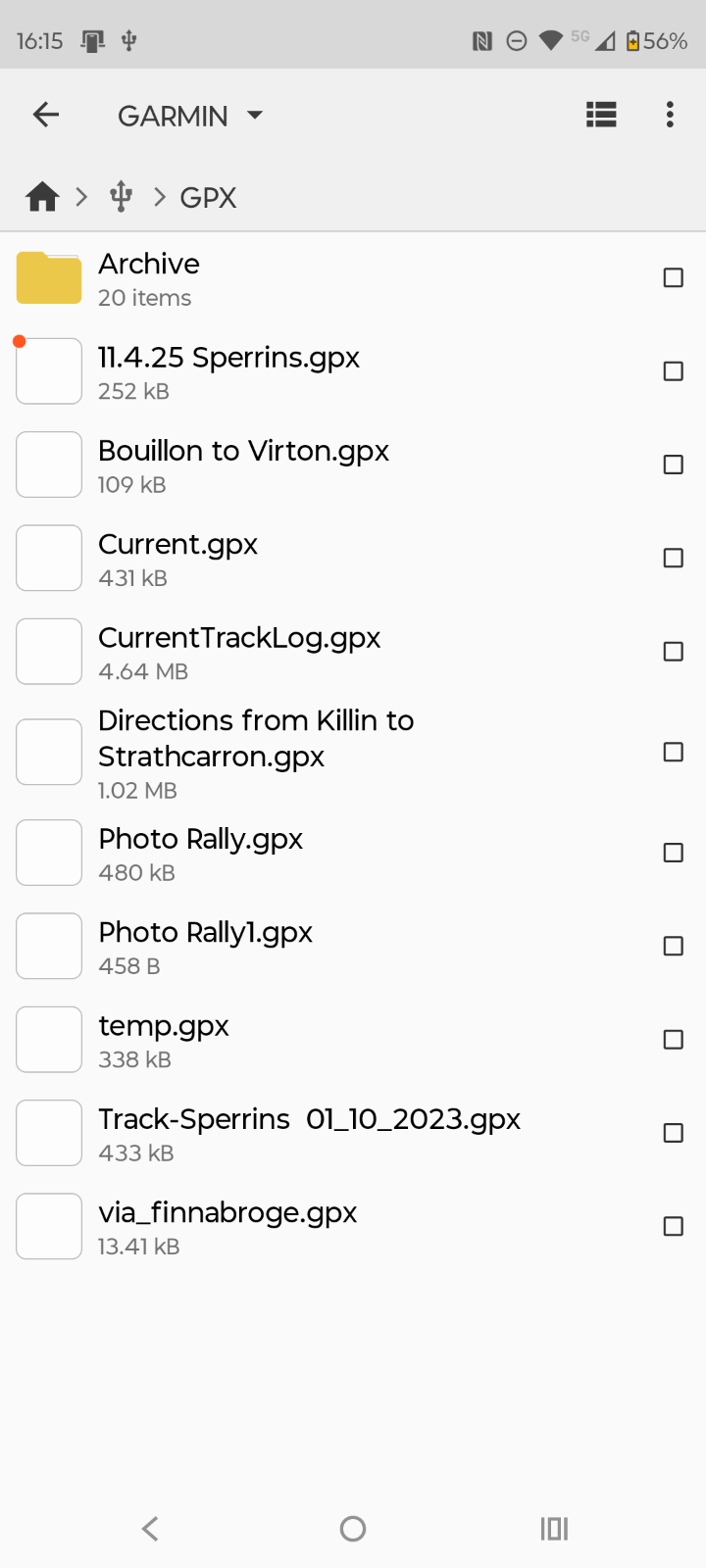

A shown in the screenshots above my Motorola Neo edge 40 running Android 15 just connects to My Zumo XT. I use this ability to delete files within the GPX folder on the XT to keep it tidy if I modify files I've created in MyRoute app and only want to see these on the Zumo XT when I load them.
For my Zumo 340 and 390 I use CX file explorer to transfer files from my phone to the memory or SD cards in the units.
The only reason I can see that would cause folk not to be able to do this would be something the phone manufacturer has added to Android OS to stop it from happening or a a dodgy USB lead (I use a Garmin one) or USB A to C convertor that does not support data transfer only charging?

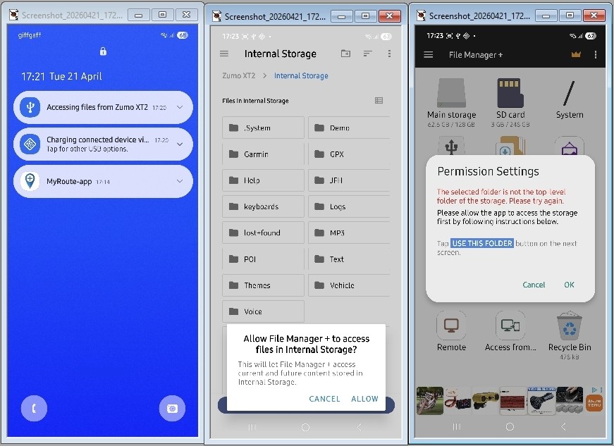

Today I had a su...... (ie the start of what I thought wa success.)
Except it got me no further.
I cannot repeat it, But I plugged my USB C cable into the phone and into the XT2.
A small icon appeared next to the date once the XT2 had gone into file transfer mode. I pulled down on it and it said something relating to the connection of the XT2. I don't recall what it said and tried to get a screen shot, but in doing so I moved to the next screen !
[edit] Just looked at my notification history - it said "USB for File Transfer". Currently it is saying "Charging Connected Device via USB."
I had an app called File Manager+ and that opened up. It might have already been open. I don't know. But I captured the following screen shots:
Click the image to view it in a bit more detail.
So these are some of the following screens:
Connecting Phone by USB.jpg (118.92 KiB) Viewed 1100 times
I was able to browse around the folder structure in internal storage and on the SD card. I had to select a location and set it as the default.
No matter which location I tried, I always got the same message - the selected folder is not the top level. The top level is either Internal Storage or SD Card. Even when I chose these I got the same message. So it can see the folders, but cannot do anything with them.
But I have so far been unable to reproduce this.
I had previously reset the XT2 to factory. Tread had been deleted from my phone and the BT link to XT2 had been destroyed. I had previously set the MTP settings on the Zumo XT2 to USB Ethernet (NOT single session) and that is what the setting is still showing. I do not know whether this had any effect on this behaviour.
One thing I do remember is that the connection seemed to 'pop up' - presumably after the XT2 had made its connection. But I cannot get it to do it again.
I'm going to try to repeat this behaviour with the current settings to find out how to repeat it. Then see if I can do the same with MTP mode set to Auto. And then see if I can do it with Tread linked, but not synched.
