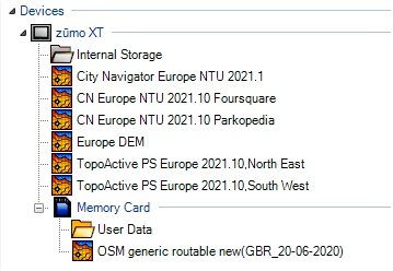

If you have a computer available, try this
Connect the XT by USB cable to your computer.
If Express loads, then close it down.
Load Basecamp. Wait for Basecamp to recognise the XT
You should see something like this at the bottom of the top window pane on the left hand side (I'm using a PC - Apple may be different).
Ignore the bit underneath memory card. Your maps should appear under internal storage. Maybe different names, depending on where you live, but similar.
