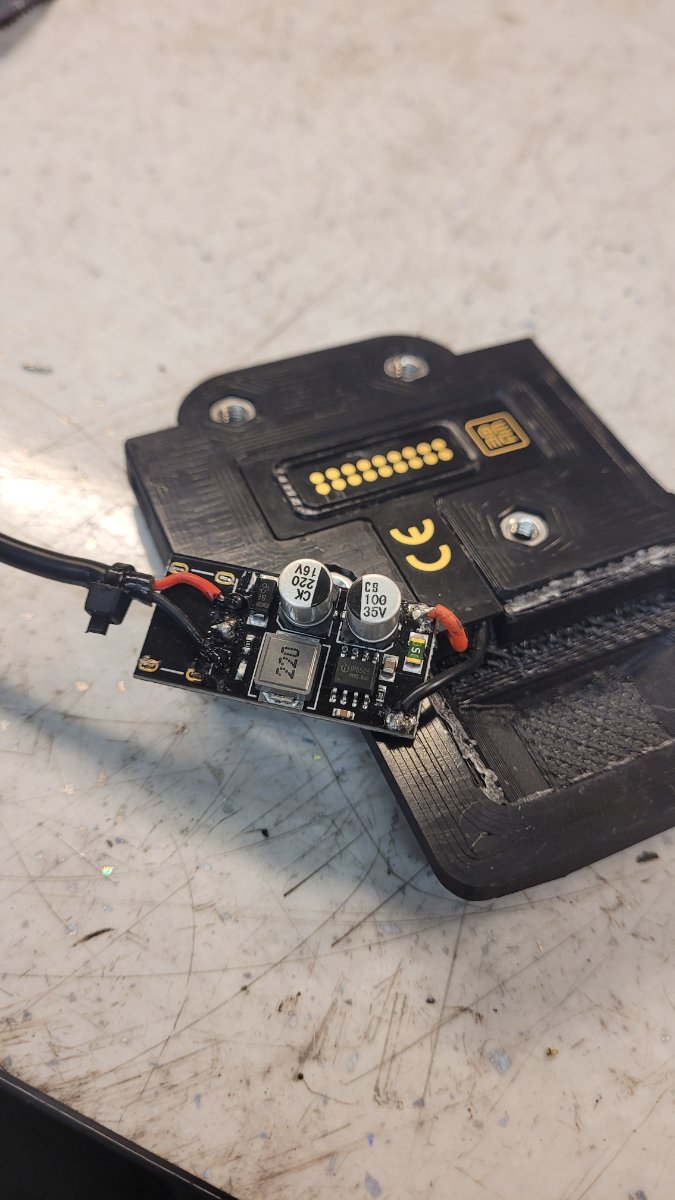

Fourbears wrote: Thu Oct 28, 2021 5:01 pm Stu I think I may have the charging problem as it does not always show the XT charging. It sometimes tells me it’s going to switch off while riding but I just press cancel. So spill the beans on the charging then!
Its the voltage converter that is inside the adapter
It puts out something like 5.11v which is fine but as soon as you connect the XT the voltage drops to below 5v which is not enough to charge it
I replaced mine with an adjustable one and set it at 5.15v and it works perfectly now (although not tested for a long period)
If you are OK with a soldering iron its an easy fix its just de-solder the converter thats in there and putting a new one on 4 wires to do
this is the one I bought https://www.ebay.co.uk/itm/294047091545 ... %3A2047675
Well I got 10 to be honest rather cheap :lol:
This is the one that needs removing
You carefully peel the back cover off and its there
Once you have put the new one in its just a case of setting the voltage (which I do on the bench first then solder it in) then glue the back cover back on
